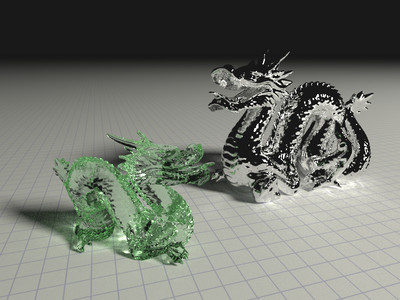

I have implemented simple kd-tree support for my renderer ssRay and it
already rocks! See the image attached. Now I can finally use more
interesting models and render complex scenes without unbearable
performance hit.
Now the kd-tree is build with idiotic spatial median subdivision (ie.
simply divide each node in half). That is stupid and I'll implement a
surface area heuristic cost model next. That should improve performance
considerably. But still, all looks pretty good so far!
I love this path tracing stuff :D

It's snakes on a *** plane!  I like it.  Really, it's no small feat to get this
far.  What's after kd-trees?

Wow that's really cool that you have done this all yourself so quickly, at
this rate you'll be ahead of POV in a few months :-)
I guess the goal here is to have the minimum number of steps down the
kd-tree on average over all rays.  My very naive instinct is that you should
split the nodes so there are equal numbers of triangles on each side, but
that's probably wrong if you don't take into account the size of each
triangle.

:D Well, maybe not :) POV has a totally different approach to ray
tracing problem so it is hard to compare. With path tracing it is SOOOO
much easier to get many light related phenomena correct. With POV the
devs had to work hard to get the desired result as many phenomena are
separately implemented. With ssRay I don't have to shoot photons
separately to get caustics, I don't have to implement radiosity to get
global illumination and all related indirect effects etc. I get them for
free. Who doesn't like that :)
> should split the nodes so there are equal numbers of triangles on each
> side, but that's probably wrong if you don't take into account the size
> of each triangle.
That is intuitively a good solution but in reality it is a bad one :D
Actually you want to cut off big empty regions early. That makes tracing
and traversing the tree cheap. If you take "object median" as the split
point you get two expensive child nodes. That usually is not a good idea.
But there are some very good documents and books about kd-tree creation
so I don't have to re-invent the wheel completely.
Basically you assign a certain cost for ray-object intersection test.
And certain cost for traversing an interior node of the kd-tree. Then
you figure out all the possible splitting plane points (in all 3
directions) and use the cost model to minimize the kd-tree cost. The key
here is to use the surface area of a node to get a probability that a
random ray would actually go through that node.

Hmm. I really don't know where to start after the SAH cost model of
kd-tree is finished. Most likely I'll spend some time refining the code
and making it more polished etc.
But I'll have to think about the material interface a bit more. Now I
have simple reflections and refractions which are not physically correct
and look unrealistic. Real reflections are angle dependent. A glass ball
reflects more at low angle than when looking form surface normal
direction. This has to be implemented properly.
I want to have Fresnel (or some good approximation like Shlick's
approximation). We'll see :D
