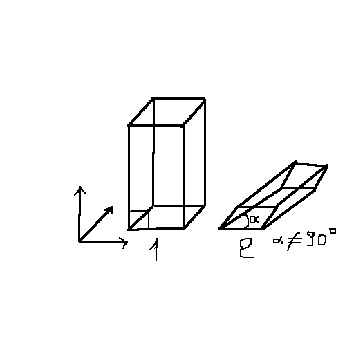

From: eric
Subject: Re: inclined Prism ?
Date: 25 Aug 1999 17:03:18
Message: <37c45a16@news.povray.org>
I need bevelled prisms...
To explain what I mean:If you have a regular cube, it's a kind of prism with
orthogonal edges. If I rotate it, it still have orthogonal edges.
What I need is an extrusion  with non-orthogonal to base vector. (See my
beautiful picture.. I need (2), and not (1) ..)
Perhaps there is a simple way to achieve this lkind of frame... ?
Of course, I could use CSG Differences to cut a regular prism with a rotated
cube to obtain a bevelled prism.. but well, it would be very fastidious in
my case...
Chris Huff wrote in message <37C327F8.F7FE8E00@compuserve.com>...
>What is wrong with simply rotating the prism?
Download 'Image1.gif' (4 KB)
Preview of image 'Image1.gif'
From: Ken
Date: 25 Aug 1999 17:20:13
Message: <37C45DD8.2D7F817C@pacbell.net>
> my case...
A rotational sheering operation make this a snap:
camera{location<-0.75,0,-3> look_at 0}
light_source{<-100,10,-200>rgb 1}
     box { -.5,.5
           rotate 20*-z
           scale<1,.5,1>
           rotate 10*z
 pigment { rgb 1 }
Ken Tyler

From: Peter Popov
Date: 25 Aug 1999 17:26:04
Message: <37c4ece6.6385853@204.213.191.228>
You have two choices if you want a prism with a well-defined interior:
(easier) Use the matrix keyword to shear the prism. You can find
specific info on how to achieve this on John VanSickle's page, whose
url you can certainly find on Unkle Ken's page.
Peter Popov

From: Josh English
Date: 26 Aug 1999 16:23:01
Message: <37C5A245.F9782956@spiritone.com>
Everyone is suggesting the Matrix transformation, but I assume you mean the
"leaning tower" of Pisa, Italy? That tower was built straight up, only a huge
architectural screw up caused it ot lean as it's foundation began to sink on one
side, so a standard prism rotated should do the trick.... but to get the effects
of the diagram, yeah, go for matrix

From: John VanSickle
Date: 26 Aug 1999 17:13:24
Message: <37C5B11E.26B96FEA@erols.com>
Or you can find it right here!
  http://www.users.erols.com/vansickl/matrix.htm
John
