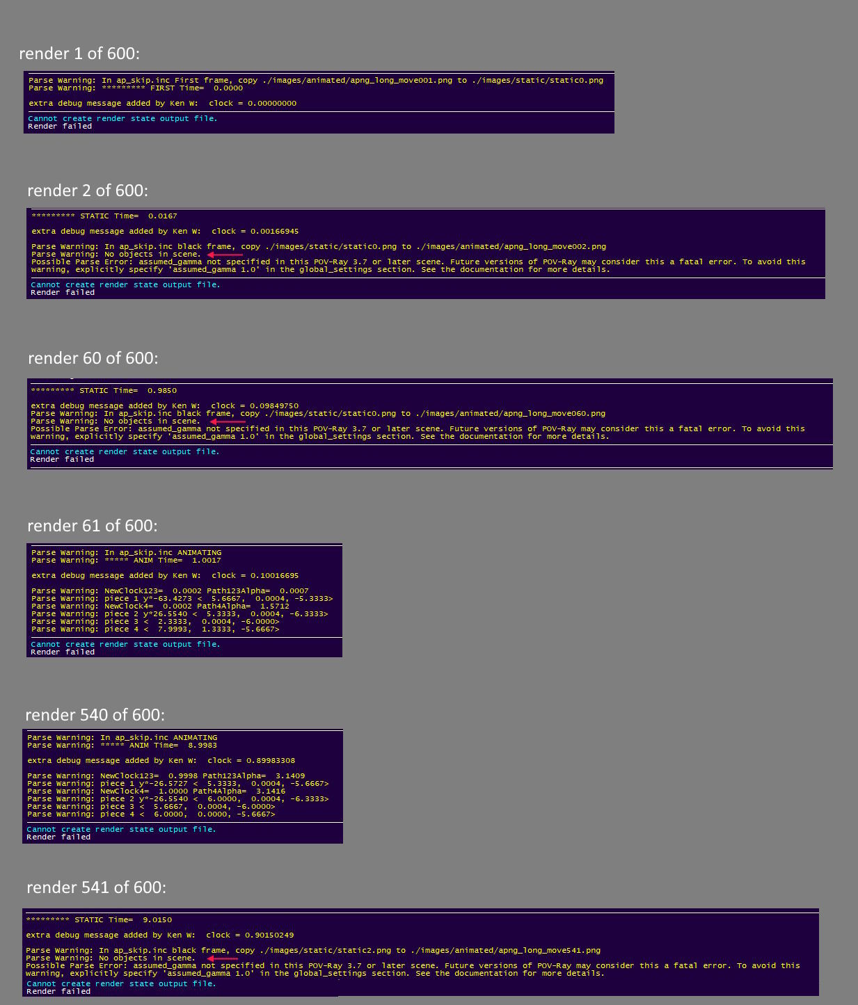

From: Kenneth
Subject: Re: animation display window does not reset to black
Date: 1 Jan 2024 17:40:00
Message: <web.65933a9ba76bba899b4924336e066e29@news.povray.org>
[running Windows 10, with POV-ray v3.7]
I downloaded your zip file. This is quite a complex scene, with many pieces that
interact, making it difficult to track down what is going on.
I attempted to run your ap.pov file with a 600-frame animation. I could not get
the scene to render at all without fatal errors-- probably because I would
need(?) to create folders and sub-folders called 'images', 'animated', 'static',
etc. and with the correct file paths to find them, which is not my own set-up.
(See your ap_skip.inc file.)
The best I could do was to run various animation frames and report the
parse-error results. I have attached that below, as screenshots; maybe it will
prove helpful. (I could not even get POV-ray's 'All_File=on' feature to work
with this scene, to output the parse-error message contents as text.)
I *suspect* that something might be wrong with how the 'clock' value is used in
the scene-- but I haven't been able to check that so far. I wonder about this
line in your ap_animate.inc file:
     #declare NewClock123 = (clock-0.1)*1.25; // turns .1 to .9 into 0 to 1
According to the notes in your posted comments, that line is supposed to kick-in
at frame 61 of the animation(?).. which is where your problems begins, as you
mentioned. But I honestly don't yet understand how all of the
various files work together for the final result.
Download 'ap_scene_messages_pane_kw.jpg' (269 KB)
Preview of image 'ap_scene_messages_pane_kw.jpg'

Regarding the line from ap_animate.inc
Yes, this happens during the animated interval, when clock ranges from 0.1 to
0.8. There are 4 animated objects which follow 4 paths. The variable NewClock123
is a value that ranges from 0 to 1 during this interval, which makes it easier
for me to calculate where the first 3 of these 4 objects should be on their
paths.
render 1 seems to be about the missing subdirectories.
render 2: The file ap.pov contains line 89 assumed_gamma 1.
"In ap_skip.inc black frame" Please where is black frame? What line number?
I should provide some background. ap.pov is supposed to generate the frames for
a 10-second video at 60 fps. The first 60 frames are all identical. After the
first frame is generated, a post-frame command executes the file fix.sh which
contains a cp command to copy this frame into static0 in the /static directory.
So by the time ap_skip.inc is creating the cp command to copy from static back
into animated, you should already have that static file sitting there. This is
for frames 2 through 60.
ap_skip.inc creates the cp command and then passes it back to ap.pov inside the
variable CpCommand. Check out ap.pov line 187 for the else clause where this
string gets used. The string is placed inside fix.sh and then ap.pov stops,
which results in a black frame for this iteration. The post frame command inside
of povray.ini then copies the static image over top of the black frame that
ap.pov just generated.
If the post frame command is not working for you, you may need to modify a file
povray.conf somwhere in your system to allow shellout commands.
render 60 of 600 looks the same.
All the warning messages you show screen shots of are placed in the code by me
as diagnostics. I am unable to get #debug messages to display.
PLEASE ask if you are unable to get my code running after you create the
subdirectories, or if you have any questions.
