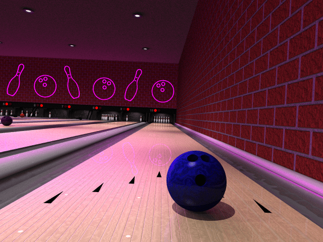

This scene is my first that's (mostly) based on real world measurements, I think
I've read enough USBC specification documents to be certified or something.
Grab the source files here:
https://archive.org/download/19100-povray/king.zip
Download 'king.png' (165 KB)
Preview of image 'king.png'

That really came out very nice.  :)
The neon lights are very cool.
The alley's wood floor pattern could maybe benefit from some stretching in the
z-direction, maybe with a wee bit less turbulence?
Not sure about the red cinder-block wall.  Seems off somehow.  Also too
CGI-perfect.
The bowling ball in the foreground would benefit from a little bit of
fill-lighting, and the icing on the cake would be to add just a touch of
motion-blur.
Maybe define a rolling function and make a few highly-transparent copies of the
ball that "roll into" the 3 balls in the render.
You could also possibly make the far ball actually hit and have some of the pins
mid-tumble in the air.
Great job - I'm sure it was a challenging exercise in measuring and modeling!
- BW

Thanks! Those are great notes to take into account for any future revisions.
Looking at the bricks perhaps it's the lack of weathering that makes them seem
off, maybe the scale too. The afterimages are a really good idea, 2.2 was before
scripting but the SDL is easy to generate so both that and the pin physics are
very doable. Getting the measurements was probably the most time consuming part
of it all, finding the dimensions of a specific small detail is a real pain when
there's so much SEO-optimized crap out there with the same handful of repeated
information.

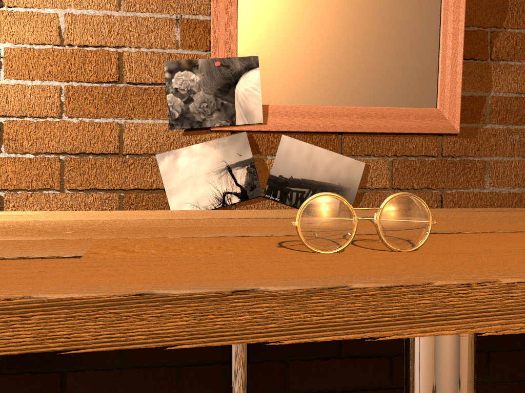

In my images with brick walls, I have started using iso-surfaces that use the
brick pigment-pattern to define the shape of the bricks and the mortar as
separate objects.  I apply turbulence to the brick pattern to get less perfect
brick edges, and then also apply pigment patterns to the visible face of the
brick, (for me the Z-axis), to apply a texture to them.  I then use some
techniques I found to vary the color/texture of the bricks so they vary rather
than having a uniform texture, but still preserving a single texture per brick.
I have attached an example.
Download 'scene-1.3-2021-10-07.png' (1418 KB)
Preview of image 'scene-1.3-2021-10-07.png'

That's really interesting, thanks for explaining your technique Chris.

You overdid the turbulence on the bricks. Real bricks, even weathered
ones, tend to have much smoother faces.

Nice job,
The neon graphics are a nice touch. It would be cool to see some light bleed
onto the wall face behind the neon. I agree with BW that the brick wall is a bit
off. Maybe some poster/prints on the wall to break down the space. I'd like to
see this view with a longer camera lens. The Pins seem far away. ...now I want
to go bowling. Mike
From: Bald Eagle
Subject: Re: [POV-Ray 2.2] Pin King
Date: 5 Nov 2023 04:10:00
Message: <web.65475b047612b3661f9dae3025979125@news.povray.org>
Ah, yes - hadn't thought about that.
Non-zero pigment components, some reflection, and radiosity ought to fix that up
nicely.
Well, it was mor of the fact that most cider block walls are gray, and most
brick walls are red - but that's a red cinder block wall.
It might look more normal as painted drywall - but maybe that's how the bowling
alley was made & painted...  dunno.  I've had plenty of renders of real things
where people complained that "it would never be that way!!!" --- until I post
the actual photograph.
Sometimes reality is stranger than depiction.   ;)
- BW
From: 19100
Date: 5 Nov 2023 11:30:00
Message: <web.6547c2387612b3667a69a5d6edfc8715@news.povray.org>
> nicely.
> - BW
Thanks Mike. I wanted to include light bleed but didn't think it would be
possible without adding a bunch of spotlights, BW's suggestion sounds like it
might do the trick though! Putting some decor on the wall is a good idea, my
intention was for it to be a brick wall but BW is right that it resembles cinder
blocks. The overall design is an amalgamation of a bunch of different references
so it doesn't recreate a specific location, but even so there's plenty to tweak
when I get around to it!
