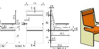

For my Edelweiss I need seats for the passengers, so let's see how to do that.
I found the model-plans at:
https://modelengineeringwebsite.com/Trans_Europ_Express.html
The seats look like the attachment.

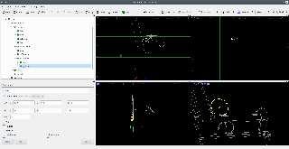

The modelling in kpovmodeler is straight forward. The plan shows the
measurements of the seat. To avoid big numbers (the whole train is 4464 units
long), I divide them by 10. So the seat is 5.6 high, and 3.05 deep. To get the
rounded edge from the armrest to the backside I place a box in the corner,
differenced by a cylinder, the one highlighted in the images. The armrest is
3.25 high, the radius of the cylinder is 0.3, so the y-position is 3.55. The x
is 0.01 wider then the side, for the difference to work. The z-position is found
empirical, just move it until the edge is smooth. That's why 3 decimals. 0.940
is not enough, and 0.950 is too much.
