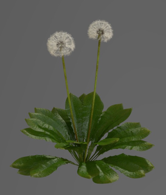

Hi,
I added some leaves to my dandelion, still going to tweak the texture on the
stem and probably add a bit more of a bend to the stem but other than that I
think the model is complete.
It is all made in SDL, fortunately there is a large variety in shape for
dandelion leaves so I could create a macro to generate a leaf with a bit of
randomisation added for the shape. I am pretty pleased and am sure I can tweak
it for different kinds of leaves in the future (the dandelion is more difficult
due to the pointy bits going up the sides).
Each leaf is a single a mesh with a cylinder for the stalk at the bottom. The
mesh is created using 3 splines, one for each side of the leaf then a central
one. I then step along the splines and create 2 splines going across the leaf
using points along these 3 splines and then traverse along these splines to
build the triangles for the mesh.
turned out better than I could have hoped for and as it is a macro they can be
randomised a lot.
I will clean up and make the parameterisation a bit more useful then post this,
might try a few other leaf based experiments now I am started..
Sean
Download 'dandelion.jpg' (32 KB)
Preview of image 'dandelion.jpg'

Prety good.
Do you thing that you could use those leaves in a salad? And, how about
the bright yellow flower itself, before it turns into seeds. Can you use
it to make soup?

> Prety good.
> it to make soup?
Thanks, the real ones are edible, not too sure about virtual ones though ;-)
I am going to try the flower next.
Sean

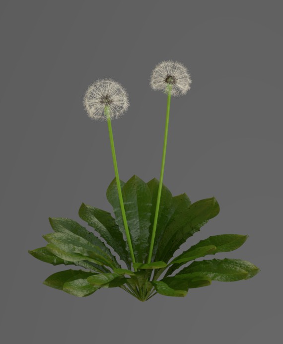

and with the correct texture for the stalk..
Download 'dl.jpg' (36 KB)
Preview of image 'dl.jpg'

if purely SDL,
you were better than several commercial software like e.g. xfrog !
In case of that, I bend my head for the one and only real Pov prophet, who will
save us as all...
Otherwise ... the source - please!
Norbert
From: Bald Eagle
Subject: Re: dandelion
Date: 15 Oct 2014 17:45:01
Message: <web.543eea9929a2be8f5e7df57c0@news.povray.org>
Holy smokes!  If that had a background to it, I'd swear it was a real dandelion!
As it is, it looks like a real one cut out of a photograph with photoshop...
GREAT job!

Awesome!
-Nekar Xenos-
Date: 16 Oct 2014 03:10:26
Message: <543f6f62@news.povray.org>
I kowtow before your mastery, master.
This is really excellent!
Dabf - morning fingers, not monkeys - rather, Dang! Looks great.
Bill P.

Hi Norbert,
Thanks, probably a lot slower than commercial software though.
I am going to adjust the macros to add some parameters to help control
the various elements (number of seeds/leaf and stalk bend, textures etc)
currently this is all hard coded into the macros so not very flexible.
Once done I will upload them to the sources or object-collection thread.
The mesh has no normals applied so the triangle count is pretty high, I
will also add parameters to adjust this where less detail is required.
If I had time to workout how to calculate the normals it could have a
lot less triangles (although this would then mean calculating where to
have the edges of the triangles so as not to lose the points at the edges).
Also, I am using uv_mapping to apply the texture but I am 99.9% sure I
am not using it correctly I wanted to have the tips of the leaves a
slightly different colour so use the uv_mapping to control where on the
spline I am so the texture changes at the tip of each leaf.
Sean
