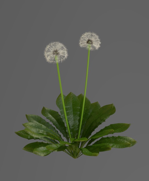

Hi,
I added some leaves to my dandelion, still going to tweak the texture on the
stem and probably add a bit more of a bend to the stem but other than that I
think the model is complete.
It is all made in SDL, fortunately there is a large variety in shape for
dandelion leaves so I could create a macro to generate a leaf with a bit of
randomisation added for the shape. I am pretty pleased and am sure I can tweak
it for different kinds of leaves in the future (the dandelion is more difficult
due to the pointy bits going up the sides).
Each leaf is a single a mesh with a cylinder for the stalk at the bottom. The
mesh is created using 3 splines, one for each side of the leaf then a central
one. I then step along the splines and create 2 splines going across the leaf
using points along these 3 splines and then traverse along these splines to
build the triangles for the mesh.
turned out better than I could have hoped for and as it is a macro they can be
randomised a lot.
I will clean up and make the parameterisation a bit more useful then post this,
might try a few other leaf based experiments now I am started..
Sean
Download 'dandelion.jpg' (32 KB)
Preview of image 'dandelion.jpg'

Prety good.
Do you thing that you could use those leaves in a salad? And, how about
the bright yellow flower itself, before it turns into seeds. Can you use
it to make soup?

> Prety good.
> it to make soup?
Thanks, the real ones are edible, not too sure about virtual ones though ;-)
I am going to try the flower next.
Sean

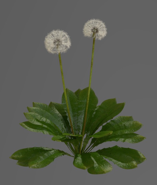

and with the correct texture for the stalk..
Download 'dl.jpg' (36 KB)
Preview of image 'dl.jpg'

"s.day" <s.d### [at] uelacuk>
if purely SDL,
you were better than several commercial software like e.g. xfrog !
In case of that, I bend my head for the one and only real Pov prophet, who will
save us as all...
Otherwise ... the source - please!
Norbert
From: Bald Eagle
Subject: Re: dandelion
Date: 15 Oct 2014 17:45:01
Message: <web.543eea9929a2be8f5e7df57c0@news.povray.org>
Holy smokes!  If that had a background to it, I'd swear it was a real dandelion!
As it is, it looks like a real one cut out of a photograph with photoshop...
GREAT job!

Awesome!
-Nekar Xenos-
Date: 16 Oct 2014 03:10:26
Message: <543f6f62@news.povray.org>
I kowtow before your mastery, master.
This is really excellent!
Dabf - morning fingers, not monkeys - rather, Dang! Looks great.
Bill P.
> if purely SDL,
> save us as all...
> Norbert
Hi Norbert,
Thanks, probably a lot slower than commercial software though.
I am going to adjust the macros to add some parameters to help control
the various elements (number of seeds/leaf and stalk bend, textures etc)
currently this is all hard coded into the macros so not very flexible.
Once done I will upload them to the sources or object-collection thread.
The mesh has no normals applied so the triangle count is pretty high, I
will also add parameters to adjust this where less detail is required.
If I had time to workout how to calculate the normals it could have a
lot less triangles (although this would then mean calculating where to
have the edges of the triangles so as not to lose the points at the edges).
Also, I am using uv_mapping to apply the texture but I am 99.9% sure I
am not using it correctly I wanted to have the tips of the leaves a
slightly different colour so use the uv_mapping to control where on the
spline I am so the texture changes at the tip of each leaf.
Sean
