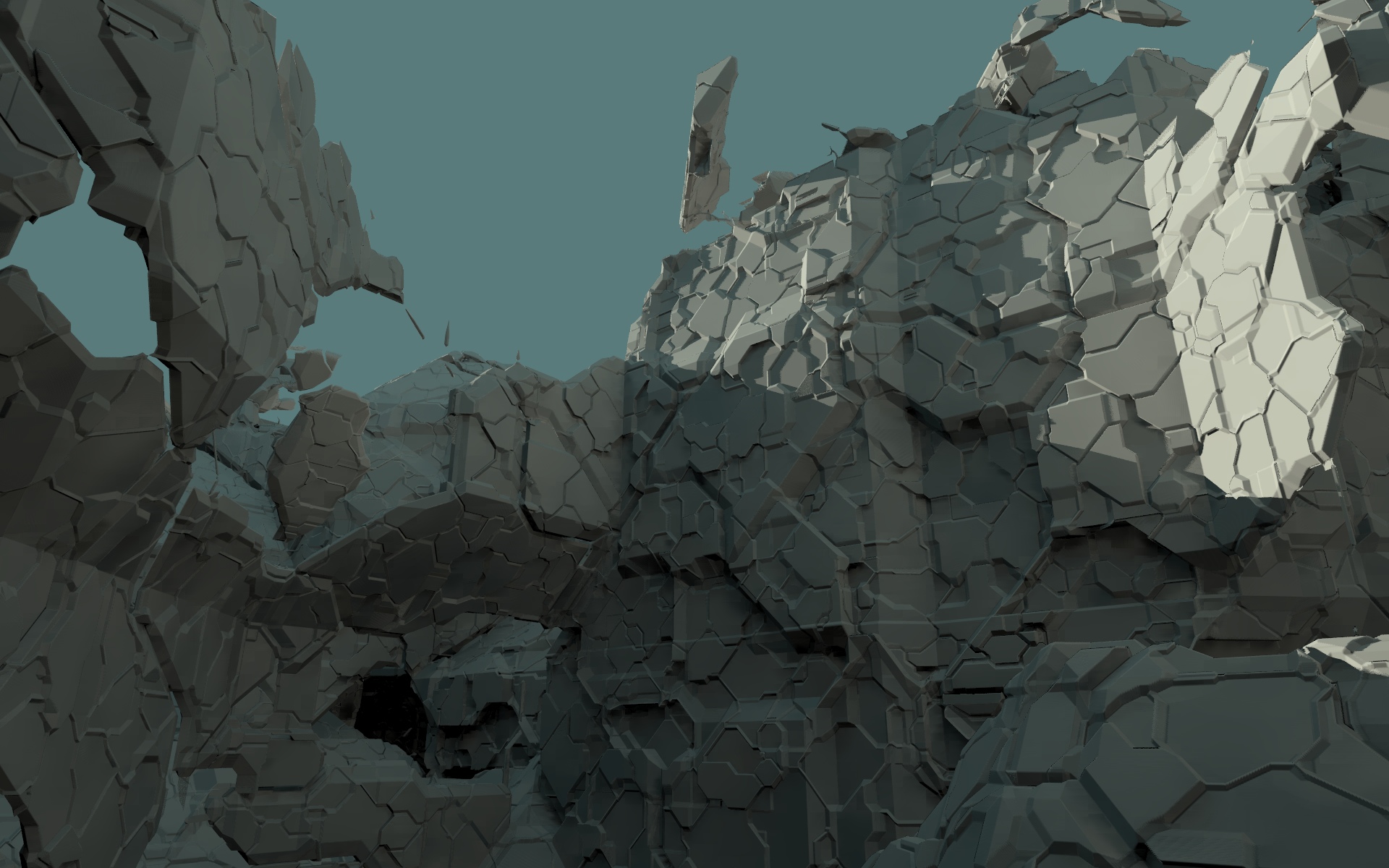

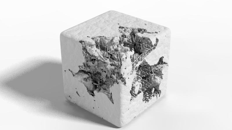

Anyway, here's a couple of isosurfaces I came up with recently. Both are very
slow, but quite pretty (IMO).
The reinforced concrete is an inverse isosurface, differerenced with a block. I
wanted to see if I could carve a realistic decay into an object without needing
the shape of the object itself to be an isosurface.
The other picture is a substance I've christened Greebelium :) It's a
multi-fractal based on crackle metric 1 (3 octaves, scale and amplitude reduced
by 1/4 with each octave).
What do you think?
Anyone want source with that?
Tek

From: Tek
Subject: Re: A couple of isosurfaces
Date: 8 Jul 2010 08:35:00
Message: <web.4c35c4d3e5fe6399caa39c860@news.povray.org>
Doh, can only attach 1 picture in web interface. Here's the greebelium.
Download 'greebelium.jpg' (83 KB)
Preview of image 'greebelium.jpg'

Beautiful image Tek. By the way, what about render time?
Keep up the good work.

From: bokunhama
Date: 8 Jul 2010 11:16:30
Message: <4c35ebce$1@news.povray.org>
Amazing.

From: Tek
Date: 8 Jul 2010 11:40:01
Message: <web.4c35f0d3e5fe6399caa39c860@news.povray.org>
"Txemi Jendrix" <nomail@nomail> wrote:
> "Tek" <tek### [at] evilsuperbraincom> wrote:
> > I keep e-mailing myself things I made in my lunch break to post here when I get
> > home, and then I get home and don't switch the PC on... :-/ So I'm posting via
> > the web interface in my lunch break instead*.
> > What do you think?
> > Tek
> > http://evilsuperbrain.com
> > *Grammar fail, my lunch break has a web interface?
> Txemi Jendrix
> http://www.txemijendrix.com
The concrete took many hours to render (I don't remember how many, it was an
overnight render). The Greebelium took 2 hours.
That's on my work PC, an Intel Core2 Quad Q9300 2.5GHz. Using Pov 3.7 on all 4
threads.
From: Samuel Benge
Date: 8 Jul 2010 13:55:01
Message: <web.4c361076e5fe6399320e5be10@news.povray.org>
> What do you think?
The concrete block looks pretty good. I'm not sure what purpose such a solid
chunk of cement would serve, but it looks pretty cool nonetheless. It's too bad
isosurfaces must always render so slowly :(
If you had made that statement regarding your lunch /box/, I might have believed
you :P
From: Dre
Date: 8 Jul 2010 20:22:25

Amazing!  That first image is brilliant, I'd love to take a look at the
source please please pretty please :)
Cheers Dre
Date: 9 Jul 2010 04:02:58
Message: <4c36d7b2$1@news.povray.org>
Very convincing, both of them. I am certainly interested in seeing the
code... :-)

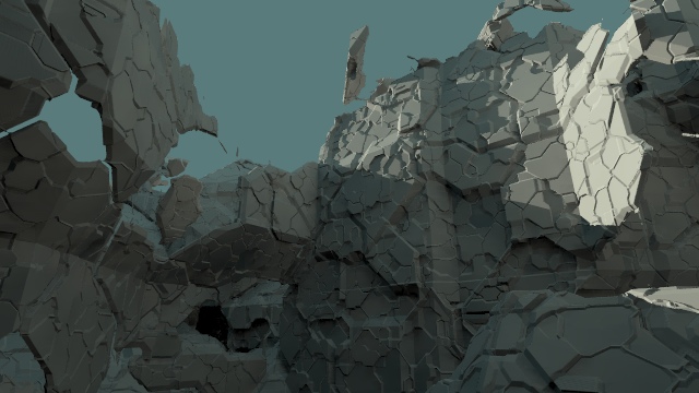

From: Tek
Date: 9 Jul 2010 04:35:01
Message: <web.4c36dec7e5fe6399caa39c860@news.povray.org>
And here's a frickin' huuuge render of the greebelium, for my desktop (and
anyone else's that wants it).
It took 5h32m.
Tek
Download 'greebelium1_5h32m.jpg' (506 KB)
Preview of image 'greebelium1_5h32m.jpg'

Ok the source for both objects is pretty small, so I'll just drop it in
here:
//------Greebelium------
isosurface {
 #declare Funches =
  function { pigment {
   average
   pigment_map {
    #local a = 1;
    #local i=0; #while ( i < 3 )
     [a crackle metric 1 pigment_map { [0 rgb .5][.1 crackle metric 1 solid
colour_map { [.5 rgb 0][.5 rgb 1] }] } scale a]
    #local a=a/4; #local i=i+1; #end
 // trap the pattern between low & high levels...
 function {
  max( y-.5+.5 - Funches(x,y,z).x, min( y+.5/*+.5 - Funches(x,y,z).x*/,
 max_gradient 20
 contained_by { box { -<5,1,5>, <5,1,5> } }
//------Concrete with Rebar------
#macro DecayBlob(Pos)
 isosurface {
  #local Off = VRand(rs)*100;
  #local f_Hole =
    average
    pigment_map {
     [1 spherical scale 2 cubic_wave translate Off warp { turbulence .5 octaves
3 } translate -Off]
     [1 pigment_pattern { granite translate Off scale 5 Flip() } poly_wave 2]
     [.4
      pigment_pattern {
       #local f = function { 1-sqrt(min(min(x*x+y*y,x*x+z*z),y*y+z*z))/sqrt(2) }
       function { min(1,max(0,f(sin(x)*4,sin(y)*4,sin(z*4))*5-3)) }
       cubic_wave
       scale 1/pi
       translate .5
       scale .8
       warp { turbulence .2 octaves 3 }
      Flip()
      translate -Pos // so they line up in different holes
  function {
   1-2*f_Hole(x,y,z).x
  max_gradient 8
  all_intersections
  contained_by { sphere { 0, 2 } }
  scale .5
  translate Pos
#end
difference {
 superellipsoid { <.1,.1> normal { granite .2 accuracy 1/1000 } }
 #local rs = seed(7);
 #local i=0; #while ( i < 5 )
  #local Norm = <0,0,0>;
  #local Pos = SphereRand(rs);
  #local Pos = trace( Thobject, Pos*2,-Pos, Norm );
  #if ( vlength(Norm) > 0 )
   DecayBlob(Pos)
   #local i=i+1;
  #end
 #end
