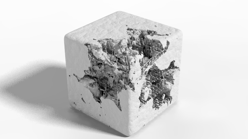

Anyway, here's a couple of isosurfaces I came up with recently. Both are very
slow, but quite pretty (IMO).
The reinforced concrete is an inverse isosurface, differerenced with a block. I
wanted to see if I could carve a realistic decay into an object without needing
the shape of the object itself to be an isosurface.

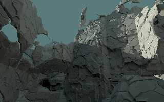

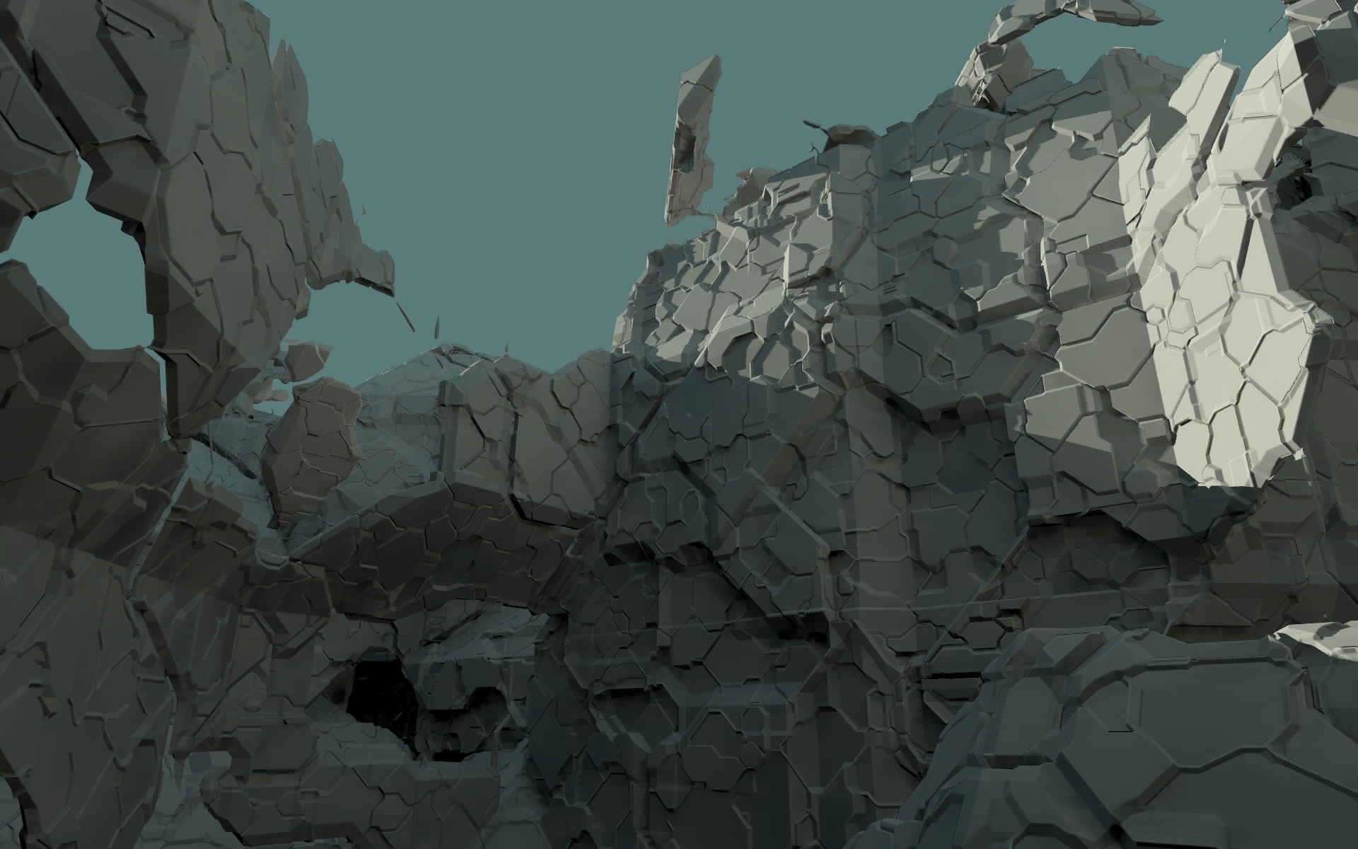

The other picture is a substance I've christened Greebelium :) It's a
multi-fractal based on crackle metric 1 (3 octaves, scale and amplitude reduced
by 1/4 with each octave).
What do you think?

Doh, can only attach 1 picture in web interface. Here's the greebelium.
Download 'greebelium.jpg' (83 KB)

The concrete took many hours to render (I don't remember how many, it was an
overnight render). The Greebelium took 2 hours.
That's on my work PC, an Intel Core2 Quad Q9300 2.5GHz. Using Pov 3.7 on all 4
threads.

The concrete block looks pretty good. I'm not sure what purpose such a solid
chunk of cement would serve, but it looks pretty cool nonetheless. It's too bad
isosurfaces must always render so slowly :(

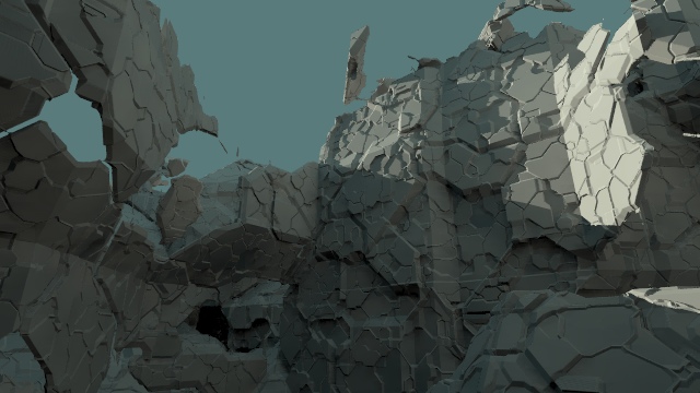

And here's a frickin' huuuge render of the greebelium, for my desktop (and
anyone else's that wants it).
It took 5h32m.
Tek

Ok the source for both objects is pretty small, so I'll just drop it in
here:
//------Greebelium------
isosurface {
 #declare Funches =
  function { pigment {
   average
   pigment_map {
    #local a = 1;
    #local i=0; #while ( i < 3 )
     [a crackle metric 1 pigment_map { [0 rgb .5][.1 crackle metric 1 solid
colour_map { [.5 rgb 0][.5 rgb 1] }] } scale a]
    #local a=a/4; #local i=i+1; #end
 // trap the pattern between low & high levels...
 function {
  max( y-.5+.5 - Funches(x,y,z).x, min( y+.5/*+.5 - Funches(x,y,z).x*/,
 max_gradient 20
 contained_by { box { -<5,1,5>, <5,1,5> } }
//------Concrete with Rebar------
#macro DecayBlob(Pos)
 isosurface {
  #local Off = VRand(rs)*100;
  #local f_Hole =
    average
    pigment_map {
     [1 spherical scale 2 cubic_wave translate Off warp { turbulence .5 octaves
3 } translate -Off]
     [1 pigment_pattern { granite translate Off scale 5 Flip() } poly_wave 2]
     [.4
      pigment_pattern {
       #local f = function { 1-sqrt(min(min(x*x+y*y,x*x+z*z),y*y+z*z))/sqrt(2) }
       function { min(1,max(0,f(sin(x)*4,sin(y)*4,sin(z*4))*5-3)) }
       cubic_wave
       scale 1/pi
       translate .5
       scale .8
       warp { turbulence .2 octaves 3 }
      Flip()
      translate -Pos // so they line up in different holes
  function {
   1-2*f_Hole(x,y,z).x
  max_gradient 8
  all_intersections
  contained_by { sphere { 0, 2 } }
  scale .5
  translate Pos
#end
difference {
 superellipsoid { <.1,.1> normal { granite .2 accuracy 1/1000 } }
 #local rs = seed(7);
 #local i=0; #while ( i < 5 )
  #local Norm = <0,0,0>;
  #local Pos = SphereRand(rs);
  #local Pos = trace( Thobject, Pos*2,-Pos, Norm );
  #if ( vlength(Norm) > 0 )
   DecayBlob(Pos)
   #local i=i+1;
  #end
 #end
