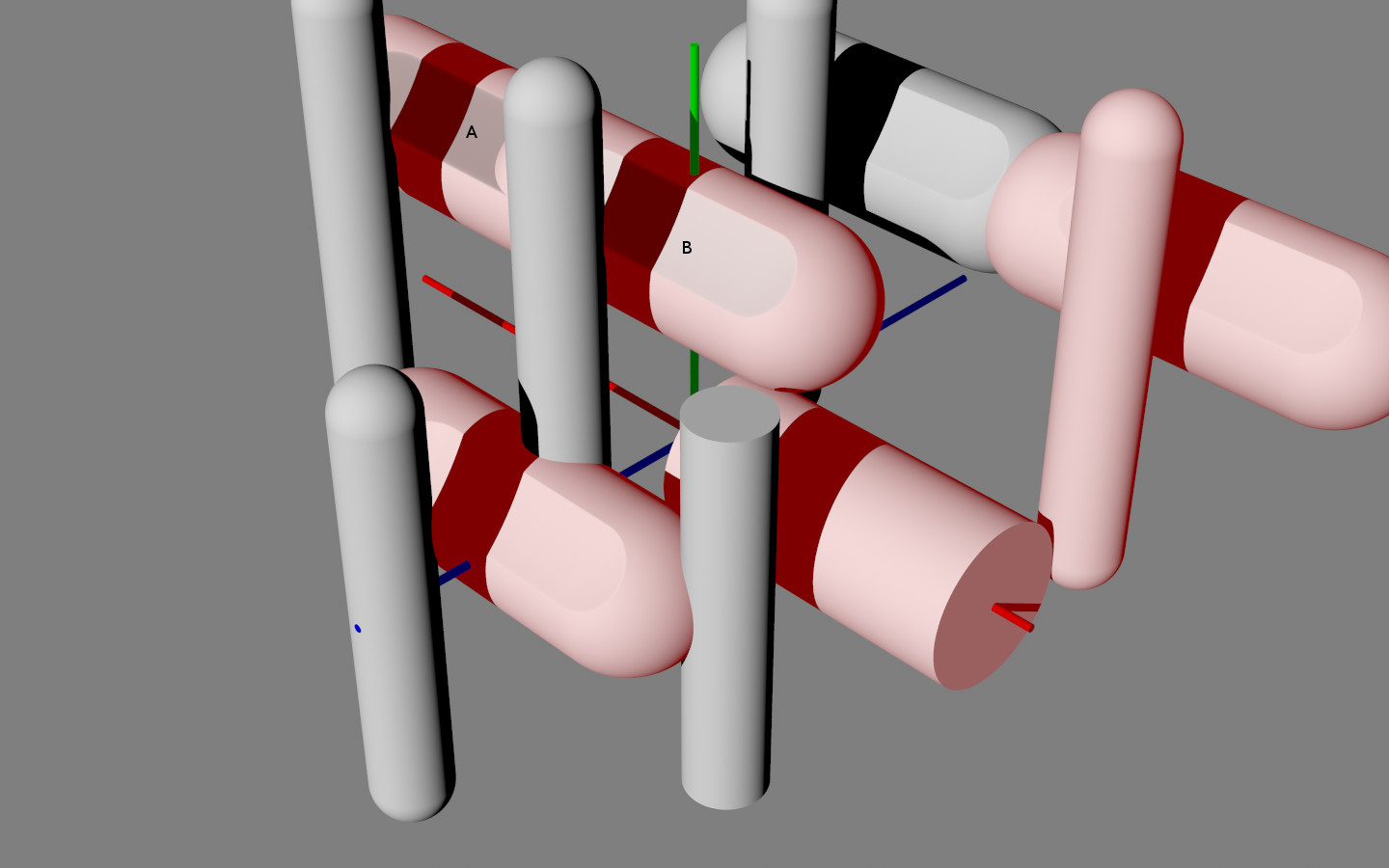

I've been looking at blobs on and off since Sven's December post to
povray.bugs. There is a numerical accuracy issue which is real and
briefly I thought I too was seeing something wrong in how finish
elements were being handled.  However, it turned out I'd missed adding a
texture on one of the negative blob components in an overall blob.
To my surprise POV-Ray includes textures attached to negative blobs
along with those attached to positive blobs when it interpolates to a
final texture. Further, if a negative component is missing a texture,
POV-Ray will use the overall blob texture, if any, and if none is found,
the running default texture. In the attached SvenFinishQ.jpg image the
negative components missing a specific textures and thus affected are
labeled as regions B and A, respectively.
So. Negative blob textures matter... This is a powerful feature. Namely,
it is possible to create invisible ink, so to speak, on negative blobs
which only become visible when interacting with portions of the blob,
which are positive and greater than the blob threshold. Further, nothing
stops us from making our positive blob components with clear textures!
In the BlobImages.jpg image we have four blobs intersected by one clear
and 3 black boxes to keep  only the +Z portions of the blobs. These box
intersections were done to avoid noise/image-echo from the interior
backside of the blob surface. Further, in all four cases we have a
vertical cylinder of a very small radius scaled left and right to get a
reasonably flat shape after which we attach an image mapped texture.  In
the upper left and lower right the image texture is attached to
flattened cylinder(s) with positive strengths. In the upper right and
lower left the image is attached to a slightly larger, but similarly
flattened, negative strength cylinder. These negative components are
enclosing the clear positive strength cylinder which turns the negative
components visible due texture interpolation.

From: Sven Littkowski
Subject: Re: Textures on negative blob components matter & enable usefultechniques.
Date: 14 Jan 2016 01:46:44
Message: <56974454$1@news.povray.org>
Hi William,
I was reading your posting, but am not so sure if these new discoveries
on blobs and blob textures mean any improvement for my own blob problem.
Are you saying, I have to use one more texture for blobs, and in some
special way?
Another question: when I compiled an own PVEngine64.exe, and apply your
suggested change (2 becomes to 3), then the program crashes each time.
Did it function on your computer?
From: William F Pokorny
Subject: Re: Textures on negative blob components matter & enableusefultechniques.
Date: 14 Jan 2016 09:57:55
Message: <5697b773$1@news.povray.org>
On 01/14/2016 01:46 AM, Sven Littkowski wrote:
> Hi William,
> special way?
No.
I have since found the technique is tangled in the same numerical
accuracy issue. Meaning, I often need my patched POV-Ray for such -
clear-pos-texture-neg test scenes to work without artifacts.
I saw your posts, but I am unable to assist directly. I run on linux and
patched the older stable branch invalid for a compile on windows. I too
doubt your windows crash issue is related to the numeric change.
