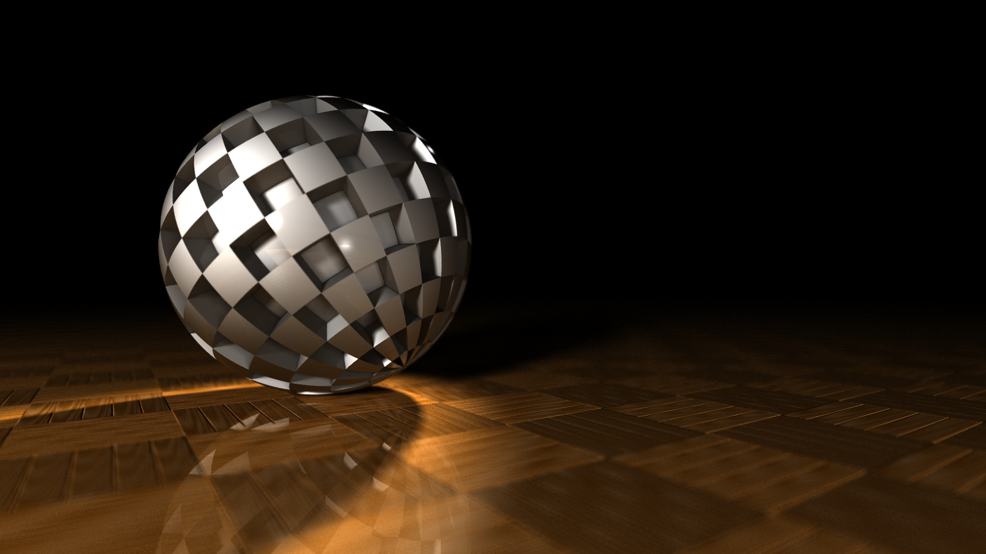

Part of a series of renderings I'm doing for my desktop backgrounds on
my work computer.
err.. rather an isosurface.
The checkering of the sphere was actually a pretty simple function
(using the contained_by shape to define the sphere.)
function {(sin(f_th(x,y,z)*13) * sin(f_ph(x,y,z)*13) * sin(f_r(x,y,z)*15))}
The isosurface is then rotated to the proper orientation. :)
Download 'chextest8.png' (1470 KB)
Preview of image 'chextest8.png'

Beautiful
-Nekar Xenos-

Nice work! You should consider an entry at www.cgsphere.com, but you have to
change the scene a bit due to their conditions.

Great image, and a good choice for a desktop background. Aside from the very
interesting sphere the floor also looks great.
Sean

Nice work indeed. I take note of the function ;-)

Hmm... I might just have to give this a go as a submission. I've gotta
work the parquet floor in somehow, though ...
