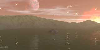

A first concept of this scene.
A view of the early Earth during the late Hadean, about 4.0 to 3.8
billion years ago, the time of the Late Heavy Bombardment (LHB) which
destroyed a significant part of the Hadean earlier crust (according to
modelling, about 25%) and possibly affected early developments of life
in the first ocean basins.
Still visible are a few of the ca 1000 sister stars, born in the same
cradle as our Sun (see Early Earth - The Beginning). Over time, these
stars will be smeared out over the local arm of the Milky Way. Soon
they will merge with the background stars.
See: http://palaeos.com/hadean/hadean.htm
http://en.wikipedia.org/wiki/Late_Heavy_Bombardment
Download 'earlyearth - lhb_03.png' (612 KB)
Preview of image 'earlyearth - lhb_03.png'

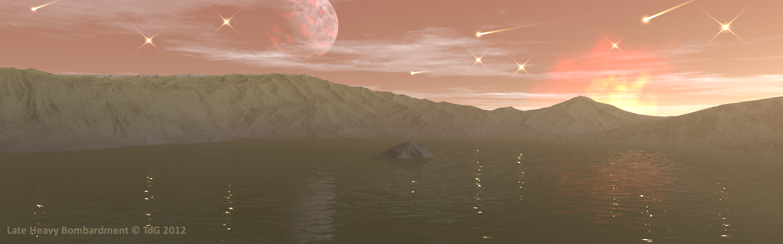

Modelling an impact
Download 'earlyearth - lhb.png' (269 KB)
Preview of image 'earlyearth - lhb.png'

> Modelling an impact
Hey Thomas, this is quite an interesting series you're working on!
I'm wondering, does that ejecta seem a bit too grainy? I know there are bound to
be larger chunks of earth thrown high from such a large impact, though I'm
pretty sure the majority of particles would be tiny enough to appear as dust
from that distance.
Also, is this near the beginning of the LHB? If not, you might want to pock up
the crust a bit with craters, and dirty up the sky with pulverized earth. Here
are a couple reference photos of large dust clouds that you might find useful:
http://static.guim.co.uk/sys-images/Guardian/Pix/pictures/2009/9/25/1253891072286/A-huge-dust-cloud-rolls-o-006.jpg
http://img.dailymail.co.uk/i/pix/2007/04_03/1DustCloudAP_468x312.jpg
A gigantic meteoroid illuminating a dust cloud would be a very dramatic sight :)
(It's too bad nobody has developed a 3D fluid simulator that also exports to a
POV-Ray df3 file. We've got a bunch of POVvers around here who are also talented
programmers... we need more utilities! :D )
Sam

On 3-7-2012 22:07, Samuel Benge wrote:
>> Modelling an impact
Thanks indeed, Sam. I just want to get away a bit from Gancaloon... ;-)
> from that distance.
Yes, I think you are right. I may end up with a combination of chunks
and dust (mainly dust). That will be a scattering media then; as I have
already the ejecta geometry, I can easily change that to a container and
see what results that gives.
I think that we should keep in mind the time scale of the whole event:
about 200 million years! That is a period of time equivalent to the one
since the late Triassic till today! Enough to severely rework the whole
Earth crust but it means also that the LHB, on a human time scale, was
not that "apocalyptic" in terms of impact frequencies. However, there
were of course more large impacts when impacts occurred, but in between
it would be more or less business as usual (with a lot of stress!).
Well, my (educated) guess ;-) and a bit of artistic flavour.
For the image, in fact a snapshot somewhere in the middle of the LHB,
this would mean (old) craters, like the scene shows (I hope) and an
impact once in a while, meteors streaking past, and a Moon with changing
molten areas.
Interesting... that would indeed be dramatic. I have to think about that
more...
Hear! Hear!

I second attempt at the impact, adding a scattering media (type 1) with
bozo density as simulation for the dust ejecta.
Hm. Better but still not entirely convincing. I have been looking at the
df3 generation code of Gilles Tran but that is done within a regular box
which is not useful here...
Download 'earlyearth - lhb.png' (380 KB)
Time enough between impacts to, say, allow weathering and erosion to obscure
previously formed craters?
Why not? Wouldn't it be able to fit inside a cylinder?
Found a couple daytime fireball photos, since references are always handy:
http://www.utahskies.org/image_library/shallowsky/meteors/fireball_burnett_big-apod20031001.jpg
http://www.theblaze.com/wp-content/uploads/2012/04/Screen-shot-2012-04-22-at-6.37.33-PM-620x367.png
The second one went along with a news article about a loud explosion heard
around my area that is suspected to have been a large meteor entering (and
subsequently fragmenting) into the earth's atmosphere. (It's a stock NASA photo
of another fireball.) I actually heard it with my own ears, but at the time
figured it was just another of the many loud booming sounds that occur
frequently around here. (People are always shooting their firearms nearby, and
other explosions can be heard farther uphill that sound like a tunnel being dug
[probably by those top-secret black helicopter types ;)].)
Oh, and I was wondering, wouldn't the lake's water and the hills' dirt possibly
be disturbed by the impact? I've seen aerial footage of accidental ground-level
jet fuel ignition, and there's a discernible shock wave that precedes the
visible above-ground explosion. Would that not also occur in this case?
.... yeah :)
Probably. At that time, there are some other violent events appening.
Many medium ans small impacts, volcanic activity, wind, caustic rain...
Also, the crust was much thinner back then, and possibly softer. Those
big impacts are sure to punch right through the crust to the magma
underneth. In those condition, the sides of the craters can readily melt
away before the temperature cools down enough and the crust reforms.

That impact is located a few 100Km away. The shock wave is not yet
there, but when it arives in less that a minute, it's supersonic and
blistering hot. It's presure may be high enough to fracture some rocks.
If you where to stand there, you'd be torn apart and your pieces burnt
to a crist.
Indeed yes.
Gille's cloud generation typically generates...clouds ;-) Something else
would be needed here, but I think that I can still tweak my media enough
to get a better result. The container, as you can see, is not a simple one.
Yes indeed. Also, if you google for "meteor impact" images, you get a
number of artist's impressions of what I am after. Not all are good,
especially in relation to size, but I think the physics shown are about
right.
<grin> Black helicopters he? You bet!
Yes, absolutely. In fact, some of the images I mentioned show this shock
wave as a spherical shell around the blast. I remember seeing them too
in some documentaries (Probably Myth Blasters). I may add it in my image.
As far as the lake is concerned, Alain is right in saying it is seconds
away from receiving the blast. I got my time machine out just in time ;-)
Exactly.
> to a crist.
Yeah. It needs good timing to watch this scene.... ;-)
