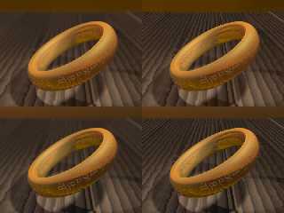

This is my first "serious" scene. It's the One Ring on a
intended-to-be-old-and-weathered wooden table. I've rendered four versions:
radiosity + focal blur        radiosity
focal blur                    vanilla
The radiosity versions are a bit more reddish, but I don't think the effect
is worth the trouble. The focal blur, on the other hand, adds a bit of
realism, but obscures the table's detail. Any advice?
Things I like:
- The Ring model
- The texture of the table
Things I don't like (so much):
- The lighting
- The finishes don't look quite right

>  It's the One Ring
I see Four. =)
effect
I don't even notice a difference with the radiosity. The focal blur helps, I
think, but tone it down some so that the ring itself doesn't get blurred so
much.
 - Slime
 [ http://www.slimeland.com/ ]

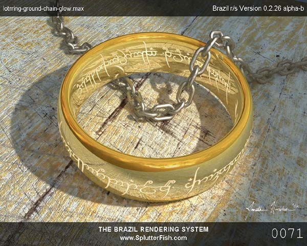

    Not too shabby.  I think gold is a hard thing to depict
realistically.  If radiosity doesn't affect the scene very much, you
might want to try photons.  They're fun to use with gold textures.  I
thought you might like to see a Brazil render my friend John Henriksen
did of a scene he modeled in 3dmax.  It might give you some ideas.  For
the table he used a height field generated from a scan of a cutting
board.  He had to do a lot of work by hand in Photoshop to get the text
up to such a high resolution.
-Ben Scheele
Download 'ring&chain13-final.jpg' (68 KB)
Preview of image 'ring&chain13-final.jpg'

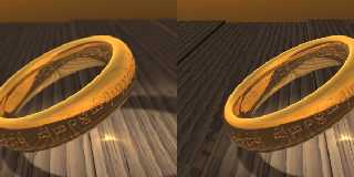

Especially when I don't have any gold to compare with ;) Thanks for the
picture, it helped me realise that I needed much more reflection and
brightness, though I was aiming for a more reddish kind of gold and a
different kind of shabby (that was a new word for me) wood. By moving the
lights and changing some parameters I was able to eliminate the stupid
"brilliance 4" I had for the wood texture
Yep, I tried using them, but with the old layout and textures there was no
noticeable effect, now there is :)
By the way, do radiosity and photons interact? I mean, would a bright
caustics spot illuminate surrounding objects? I've seen you can also get
caustics with pure radiosity (no photons), and I guess these would
illuminate surrounding objects, logic says photon caustics (and faked
caustics) would behave in the same way...
> I thought you might like to see a Brazil render my friend John Henriksen
You mean the text or the texture? There's a TTF font available for the ring
inscription script (which I didn't use, because I like this one better).
There's something I don't like in that picture: the text in the inner side
of the ring is backwards :D

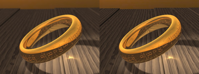

Here's the new version, better now? (with and without focal blur)

Wow! These look awesome!
You should fix that with the inner
engravement being the wrong way
round (are you using bump-maps,
or CSG?).
Aside of that, how about using a slighty
irregular heightfield for the wood?
And regarding focal-blur: make the
aperture a nuance smaller, so that the ring
itself antialiased at most, but not blurred.
Move the camera away a little, and add
some stuff, like pots and cups and such,
in fore- and background. Use radiosity
to light that, but keep a soft spotlight on
the ring, to make it the center of attraction.
I often tend to make single objects and
showcase them in my scenes, but realism
is added with more objects around it. It
would also add to the reflections of the
ring.

No, mine is fine, it's the rendering Ben Scheele showed the one that's
wrong... The ring (mine) is CSG (lathe & text).

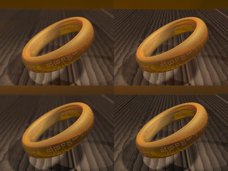

Hmm... maybe. I did some tests with function-hf, it looks like I will need a
fairly high resolution and parsing time would grow too much (I guess I
should save the data first). The hardest part would be fitting the hf to
the round corners (the table is made up of round boxes). Right now, most of
the texture is normal-made, which works very nicely under the spotlight,
but is obscured by focal blur and radiosity (though I used "normal on"),
maybe I should add some pigment noise (layers) too.

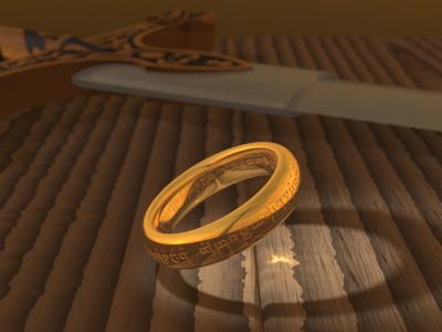

That's more or less what I've tried now. Not many objects, just two copies
of the same dagger (I had to model it and draw the maps for the occasion),
I also fixed the scale of the table (the planks were too small in
comparison with the ring). Is it any better now?
