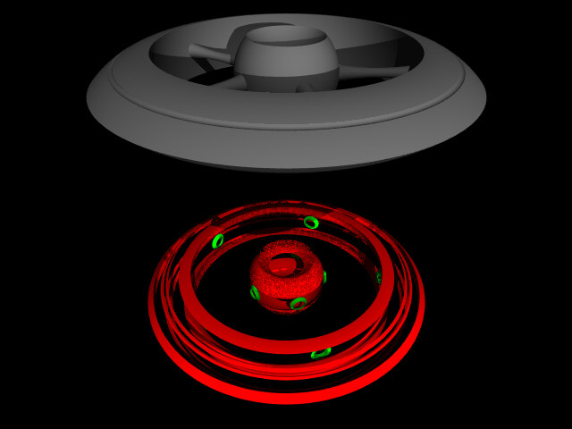

When one look closely at the real
world, one seldom find sharp edges.
Therefore I'm working on a macro
these days for making smooth
transitions from the different
parts in (some) Constructive
Solid Geometry -objects.
This is an object I created with
the help of this macro.
Comments are wery welcome.
Tor Olav
mailto:tor### [at] hotmailcom
Download 'ttouch01.jpg' (44 KB)
Preview of image 'ttouch01.jpg'

Neat. Looks a bit balloony, though, and I can't help wondering how
texturing would work with this.
On an completely different note, the rounded-off parts where the spokes
meet the outer wheel REALLY remind me of welds.. though, of course,
they're far too smooth.
Xplo Eristotle

From: Tor Olav Kristensen
Subject: Re: Playing with CSG (44 KB)
Date: 15 Apr 2000 21:07:19
Message: <38F911EE.A010E5@hotmail.com>
Xplo Eristotle wrote:
> Neat.
Thank you.
Hmmm... Maybe I overdid this a little bit.
(I think some of the radiuses are to small and some are to big.)
Any suggestions?
One of the things that have inspired me to start this work
is weldings on several tubes around in the city where I live.
And I agree with you: It really is to smooth.
But again if one look closely at welds they are smooth in
their own way! (I find them difficult to model accurately.)
Tor Olav

This is very impressive.  The creation of internal fillet radii and rounding of
external sharp edges is a real problem when trying to model real world objects
with CSG.
There are, however,  a very large number of combinations of different objects
possible in creating a composite CSG object. Does your macro attack the general
problem? Or, if not,  what cases does it apply to?
(Whatever the answer your macro/macros will be a welcome addition to the CSG
toolbox!)
David
dav### [at] hamiltonitecom
Subject: Re: Playing with CSG (2 images: 46 KB and 14KB)
Date: 16 Apr 2000 21:49:58
Message: <38FA6DB9.3AD7D0E5@hotmail.com>
Thank you!
> with CSG.
Yes, to my big frustration I am aware of the many possible
combinations.
I have only chosen to attack a small subset of them.
> problem?
I'm afraid not...
I think that would require some pre-processing of the POV-file.
Or I would have to make macros that did some "intelligent"
scaling of the objects before the CSG was applied.
The macro(s) would also have to figure out if it's possible
to do the "smoothing" with POV-Rays object primitives.
(There are some "missing") And then at last it would have
to select and "custom cut" the chosen object primitives before
applying them to the final CSG operations...
...And I do not have time now to even try figuring out all this.
To combinations of these object primitives:
Plane
Cylinder
Cone
Sphere
Torus
(But there will be restrictions on how they are aligned
and positioned relative to each other.)
Macro so far:
Sphere meets Sphere
Torus  meets Sphere
Torus  meets Torus
(Cylinder meets Cylinder)
Next to do:
Sphere   meets Cone
Torus    meets Cone
Sphere   meets Cylinder
Torus    meets Cylinder
Cylinder meets Cone
Cone     meets Cone
And finally:
Sphere   meets Plane
Torus    meets Plane
Cylinder meets Plane
Cone     meets Plane
Plane    meets Plane

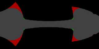

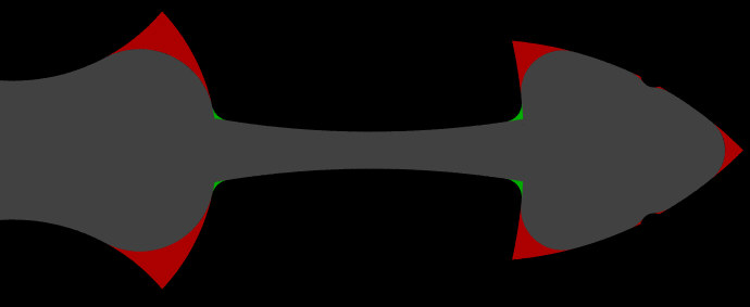

I have enclosed to images with this posting.
The first one shows how the CSG would have looked if the
"smoothing" had not been applied (upper part of picture)
and also the different objects that my macro returned for
"CSG-ing" (lower part of picture).
The second picture shows in detail a cut of the right part
of my "wheel".
The grey area again shows how the CSG-object would have
looked without "smoothing".
The green parts shows the parts (objects) that my macro
returned which I chose to "add" to the final object.
And the red parts shows the parts (objects) that my macro
returned which I chose to "subtract" from the final object.
My macro(s) needs numerical information about the two
objects that are to be "smoothed" together (radii, centres,
endpoints, etc.)
Then one has to select from different types of "smoothing"
("internal"/"external" fillet radii or "internal"/"external"
rounding-radii).
In addition to returning parts that can be directly included
in the final CSG operation my macro(s) will also return some
useful numerical information about these parts.
> toolbox!)
If there is any interest for my macros then I will release
them so that other POV-ers can use them.
(But I think that I should finish them first. ;-)
Tor Olav
Download 'tt01.jpg' (46 KB) Download 'tt02.jpg' (14 KB)
Preview of image 'tt01.jpg'
Preview of image 'tt02.jpg'
Date: 16 Apr 2000 21:58:17
Message: <38FA6FDA.435B6642@hotmail.com>
> of my "wheel".
Correction:
of my "wheel".
The grey   AND RED   areas   TOGETHER   shows how
the CSG-object would have looked without "smoothing".
Sorry.
Tor Olav

in a CSG operation between two primitives to make the transistion smoother.
But before the macro can do this it needs some numerical information about
the chosen primitives.
I have chosen a subset of POV-Rays shape primitives.
And then I'm trying to make macros to make smooth transitions between
these primitives with cylinders and toruses.
But even with this subset I have to restrict the number of possible ways
the primitives can "meet" each other.
This is partly because there are some other primitives "missing" in POV-Ray.
(Maybe I will look into the possibility to generate these primitives with
Quartics later.)
My goal is to end up with 1, 3 or 4 macros that the end users needs to make
calls to. (Of coarse there are other macros below that the end user doesn't
"see".)
> I don't know if you've seen it, but I
> ran into such problems with my "old typewriter" model (recently posted
> image) ...I cheated by leaving a lot of objects with sharp edges ...or tried
> to fake it with a few bezier patches and super quadrics here and there.
I noticed your nice paper feed handle and the screw heads.
But as you mentioned the image is rendered without antialiasing and
therefore I found it hard to see all the other details.
> Obviously, your macro would eliminate all these issues. I would be very
> interested  to know how you have achieved this!
I'm afraid I have not eliminated all these issues!      =(
If you look into my answer to David Wilkinson 18. April you will find
my attempt to explain what I'm doing.
There are also two extra images to clarify.
Tor Olav
I'm sorry that these macros are not documented.
(I'm not good at finding descriptive names for my
variables or macros either.)
And I'm afraid that this makes them rather cryptic.
The macro; BetweenToruses was the only one that I made
calls to in order to make the "wheel" picture.
