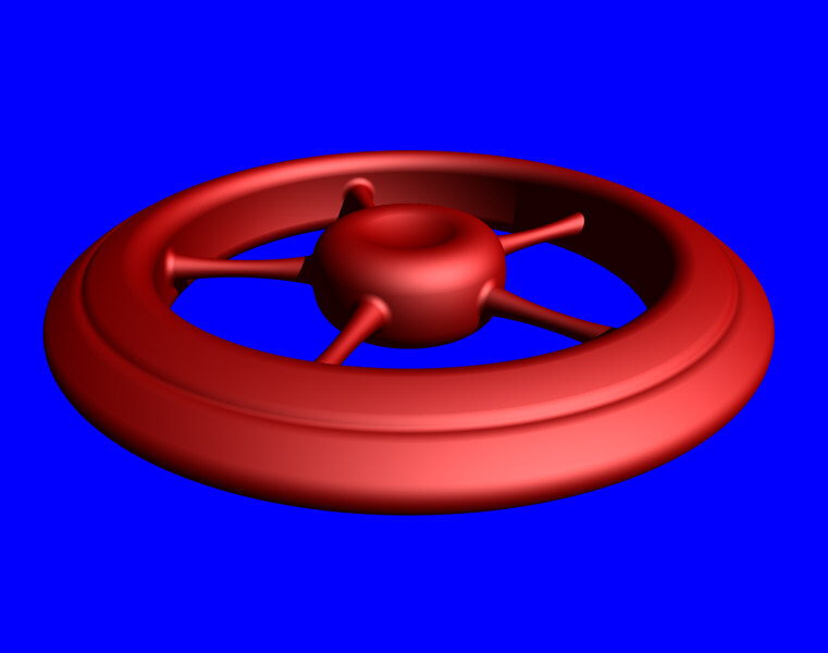

When one look closely at the real
world, one seldom find sharp edges.
Therefore I'm working on a macro
these days for making smooth
transitions from the different
parts in (some) Constructive
Solid Geometry -objects.
This is an object I created with
the help of this macro.
Comments are wery welcome.
Tor Olav
mailto:tor### [at] hotmailcom
Download 'ttouch01.jpg' (44 KB)
Preview of image 'ttouch01.jpg'

Neat. Looks a bit balloony, though, and I can't help wondering how
texturing would work with this.
On an completely different note, the rounded-off parts where the spokes
meet the outer wheel REALLY remind me of welds.. though, of course,
they're far too smooth.
Xplo Eristotle

Xplo Eristotle wrote:
> Neat.
Thank you.
Hmmm... Maybe I overdid this a little bit.
(I think some of the radiuses are to small and some are to big.)
Any suggestions?
One of the things that have inspired me to start this work
is weldings on several tubes around in the city where I live.
And I agree with you: It really is to smooth.
But again if one look closely at welds they are smooth in
their own way! (I find them difficult to model accurately.)
Tor Olav
> Any suggestions?
I wouldn't know where to begin.
True.. I've done a little welding and I don't know how I'd model that either.
Xplo Eristotle
http://start.at/xplosion/

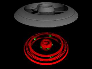

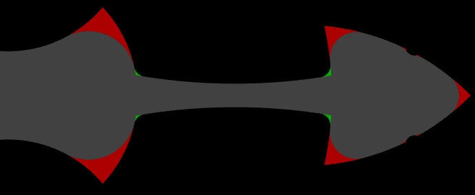

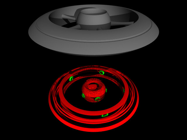

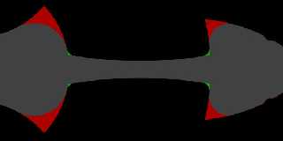

I have enclosed to images with this posting.
The first one shows how the CSG would have looked if the
"smoothing" had not been applied (upper part of picture)
and also the different objects that my macro returned for
"CSG-ing" (lower part of picture).
The second picture shows in detail a cut of the right part
of my "wheel".
The grey area again shows how the CSG-object would have
looked without "smoothing".
The green parts shows the parts (objects) that my macro
returned which I chose to "add" to the final object.
And the red parts shows the parts (objects) that my macro
returned which I chose to "subtract" from the final object.
My macro(s) needs numerical information about the two
objects that are to be "smoothed" together (radii, centres,
endpoints, etc.)
Then one has to select from different types of "smoothing"
("internal"/"external" fillet radii or "internal"/"external"
rounding-radii).
In addition to returning parts that can be directly included
in the final CSG operation my macro(s) will also return some
useful numerical information about these parts.
> (Whatever the answer your macro/macros will be a welcome addition to the CSG
> toolbox!)
If there is any interest for my macros then I will release
them so that other POV-ers can use them.
(But I think that I should finish them first. ;-)
Tor Olav
Download 'tt01.jpg' (46 KB) Download 'tt02.jpg' (14 KB)
Preview of image 'tt01.jpg'
Preview of image 'tt02.jpg'
> of my "wheel".
Correction:
of my "wheel".
The grey   AND RED   areas   TOGETHER   shows how
the CSG-object would have looked without "smoothing".
Sorry.
Tor Olav

I'm afraid I have not eliminated all these issues!      =(
If you look into my answer to David Wilkinson 18. April you will find
my attempt to explain what I'm doing.
There are also two extra images to clarify.
Tor Olav
I'm sorry that these macros are not documented.
(I'm not good at finding descriptive names for my
variables or macros either.)
And I'm afraid that this makes them rather cryptic.
The macro; BetweenToruses was the only one that I made
calls to in order to make the "wheel" picture.
