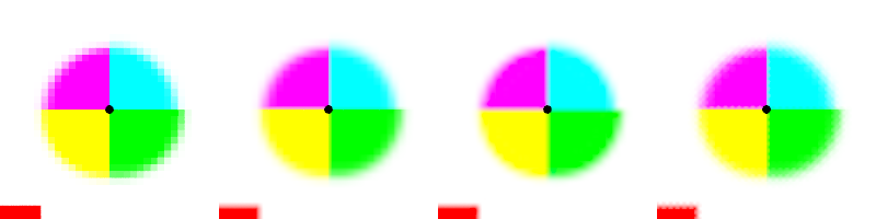

The attached image (1) shows the effect of interpolation on images; from
left to right:
- "interpolate 0", i.e. no interpolation
- "interpolate 2", i.e. bilinear
- "interpolate 3" (currently not supported)
- "interpolate 4", i.e. normalized distance
In all cases, the black dot is exactly at the center.
As can quite easily be seen, when interpolation is activated the image
appears slightly shifted to the bottom-right, in the order of magnitude
of half a pixel.
Normally I'd just fix that offset, but it has probably been there since
eons - and changing it might actually break a few scenes that have
deliberately worked around this issue (I have at least once designed
such a scene).
How do you feel about it?
My personal vote would be to fix it nonetheless, to end up like shown in
the attached image (2). (And yes, that's bicubic interpolation you see
in the "interpolate 3" field.)
Download '_interpolation_shift.png' (25 KB) Download '_interpolation_fix.png' (30 KB)
Preview of image '_interpolation_shift.png'
Preview of image '_interpolation_fix.png'
I guess that explains your recent Wiki activity! I'd vote yes as well
...if it means picking up the bicubic feature while you're at it :-)

I can add the bicubic feature without changing the old interpolation
methods' behavior, so no conditionals here please ;-)

contraints in (1) /and/ (2).
Actually, if we think of pixels not as points but rather as tiles, I
think this definition of "image corners" is perfectly natural.
And this is exactly what non-interpolated images give us.
So yes, I think the no-interpolation-way of positioning the image is
absolutely right, and interpolated modes should follow suit.
> of half a pixel.
