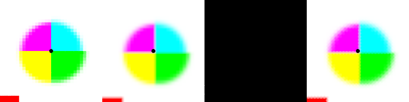

The attached image (1) shows the effect of interpolation on images; from
left to right:
- "interpolate 0", i.e. no interpolation
- "interpolate 2", i.e. bilinear
- "interpolate 3" (currently not supported)
- "interpolate 4", i.e. normalized distance
In all cases, the black dot is exactly at the center.
As can quite easily be seen, when interpolation is activated the image
appears slightly shifted to the bottom-right, in the order of magnitude
of half a pixel.
Normally I'd just fix that offset, but it has probably been there since
eons - and changing it might actually break a few scenes that have
deliberately worked around this issue (I have at least once designed
such a scene).
How do you feel about it?

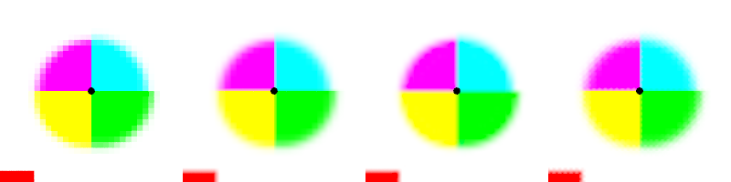

My personal vote would be to fix it nonetheless, to end up like shown in
the attached image (2). (And yes, that's bicubic interpolation you see
in the "interpolate 3" field.)
Download '_interpolation_shift.png' (25 KB) Download '_interpolation_fix.png' (30 KB)
Preview of image '_interpolation_shift.png'
Preview of image '_interpolation_fix.png'
From: Jim Holsenback
Subject: Re: Shift of interpolated images
Date: 30 Apr 2010 10:13:31
Message: <4bdae58b$1@news.povray.org>
I guess that explains your recent Wiki activity! I'd vote yes as well
...if it means picking up the bicubic feature while you're at it :-)
> left to right:
> of half a pixel.
> such a scene).
> of half a pixel.
I was somewhat aware of this; I think fixing it would be a good idea. But I'm
wondering about that bottom-right shift.
I just did an interpolation test on a 'test chart' image I made last year in
Photoshop. (It's 720X540, made up of lots of different single-pixel-width lines,
shapes, letters, etc. With no P.Shop antialising--just nice clean pixels. It's
main purpose was to test out my 'motion blur post-processing' animation code,
which simply averages multiple pre-rendered images by placing
them as image_maps on a box. The chart came in handy, to make sure I was getting
a 1:1, pixel-for-pixel reproduction of the images when copying them. This method
and code *do* reproduce the image_map faithfully, edge-to-edge and
corner-to-corner.)
So I did some tests in v3.6.1, using this image_map chart (with interpolate 2)
and the same 'copying' step as mentioned above. What I see is that the 'blur' is
shifted to the bottom-LEFT. (And also downward; sort of a combination of the two
directions.) I've posted some images of the tests over at p.b.i.--I can't seem
to do it here. (The orange lines correspond to your non-moving 'center dot.')
For test #1, the image_map is re-rendered 1:1 (that is, at 720 X 540) then blown
up in P.Shop by 800%, to more clearly show the shift--which, BTW, appears to be
by a full pixel, probably(?) just a result of the test's image rez. Test #2 was
re-rendered a 8-times the original--5760 x 4320--and NOT blown up in P.Shop.
(Although I *have* included a blown-up close-up of that.) Again, it looks like a
full-pixel shift. BTW, I thought this discrepancy between our results might have
something to do with the 'once' keyword; but it doesn't.
I'm puzzled by the difference in what we're getting. I'm wondering if I've done
something stupid in my methodology, or whether our test set-ups differ in some
fundamental way. Care to describe your test procedure?
Ken
