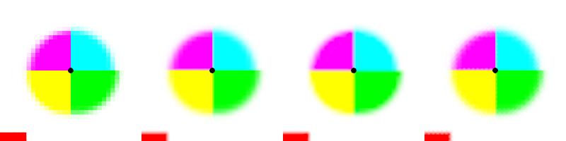

The attached image (1) shows the effect of interpolation on images; from
left to right:
- "interpolate 0", i.e. no interpolation
- "interpolate 2", i.e. bilinear
- "interpolate 3" (currently not supported)
- "interpolate 4", i.e. normalized distance
In all cases, the black dot is exactly at the center.
As can quite easily be seen, when interpolation is activated the image
appears slightly shifted to the bottom-right, in the order of magnitude
of half a pixel.
Normally I'd just fix that offset, but it has probably been there since
eons - and changing it might actually break a few scenes that have
deliberately worked around this issue (I have at least once designed
such a scene).
How do you feel about it?

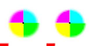

My personal vote would be to fix it nonetheless, to end up like shown in
the attached image (2). (And yes, that's bicubic interpolation you see
in the "interpolate 3" field.)
Download '_interpolation_shift.png' (25 KB) Download '_interpolation_fix.png' (30 KB)
Preview of image '_interpolation_shift.png'
Preview of image '_interpolation_fix.png'
I guess that explains your recent Wiki activity! I'd vote yes as well
...if it means picking up the bicubic feature while you're at it :-)

I've got code to correct for this in my DF3 Proximity macros - the same problem
affects voxels with interpolation. I can change my macros if you change POV, but
is there a way to query a specific sub-version of POV? Can I query if I'm
running beta 37 vs beta 38?
Also - are you sure its a bug? I managed to convince myself that it's the
correct behavior if the pixel's value is defined for the pixels coordinate (e.g.
<0,0>, <1,4> or <1023,1023>) rather than half a pixel across (e.g. <0.5,0.5>,
<1.5,4.5> or <1023.5,1023.5>). Does that make sense?
> <0,0>,<1,4>  or<1023,1023>) rather than half a pixel across (e.g.<0.5,0.5>,
> <1.5,4.5>  or<1023.5,1023.5>). Does that make sense?
Well, I guess that's a matter of definition. But I'm instead going by
visual appearance, and cannot help but notice that the image /visually/
shifts by half a pixel when turning on interpolation. And /that/ I do
call a bug. If I want to smoothen an image, I typically don't want it to
shift.
BTW, I didn't pay any thought to DF3s yet, so thanks for drawing my
attention to those; while they use different code, I think it makes
sense to have the same behavior for images and DF3s alike.

I think, technically, the uninterpolated image is in error, but that also breaks
people's expectations.
Also, think of mapping a square image onto a square poly with one corner at
<0,0> - do you want the value at <0,0> to be that of the corner most pixel?
The code looks pretty cut and pasted, only with an extra dimension.
Cheers,
Edouard.
> <0,0>  - do you want the value at<0,0>  to be that of the corner most pixel?
I think it becomes clearer when you're considering two special cases
that need to be handled somehow:
(1) Using images as tiles.
When tiling a plane with a repeating image pattern (i.e. an image
without the "once" keyword), you obviously want the image to repeat in a
"sane" interval; if the image size in POV's coordinate space is
nominally 1x1 units, you want the resulting pattern to repeat exactly
every 1.0 units. You also want each pixel of the image to take up the
same space.
Assuming the original image to be square for simplicity (but of course
the argument can be extended to non-square images as well), with a size
of N*N pixels, this means that in POV's coordinate space, each pixel
should have an edge length of exactly (1/N) units - no more and no less
- in POV's coordinate space.
(2) Mapping onto a unit cube.
If you map an image pattern onto a unit cube (say,
"box{<0,0,0>,<1,1,1>}", obviously you will typically want /all/
"corners" of the image to "coincide" with the cube's corners, without
requiring you to perform any scaling. Now what exactly would "image
corners" and "to coincide" mean in this context?
A first thought might be to think of the "image corners" as /the pixels/
in the image's corners, and of "to coincide" as meaning that the
/center/ of the image be exactly at a certain point.
Note however that if you place the center of pixel (0;0) at the cube
corner <0,0,0>, the center of the corner pixel diagonally across - which
is pixel (N-1;N-1) - will wind up /not/ at <1,1,0>, but rather at
<(N-1)*(1/N),(N-1)*(1/N),0>, as we required in (1) that a pixel should
have an edge length of (1/N).
That is, given the constraints in (1) and the definition of "image
corners" and "to coincide" just outlined, we /cannot/ have all "corners"
of the image "coincide" with the cube's corners.
There is actually only /one/ single way to do this without violating the
constraints given in (1):
We must define "image corners" as the /outer corners of the outer
pixels/ - that is, the top-left corner of pixel (0;0), the top-right
corner of pixel (N-1;0), the bottom-left corner of pixel (0;N-1), and
the bottom-right corner of pixel (N-1;N-1). If these very "corner pixel
corners" end up at the cube corners, we have fulfilled both the
