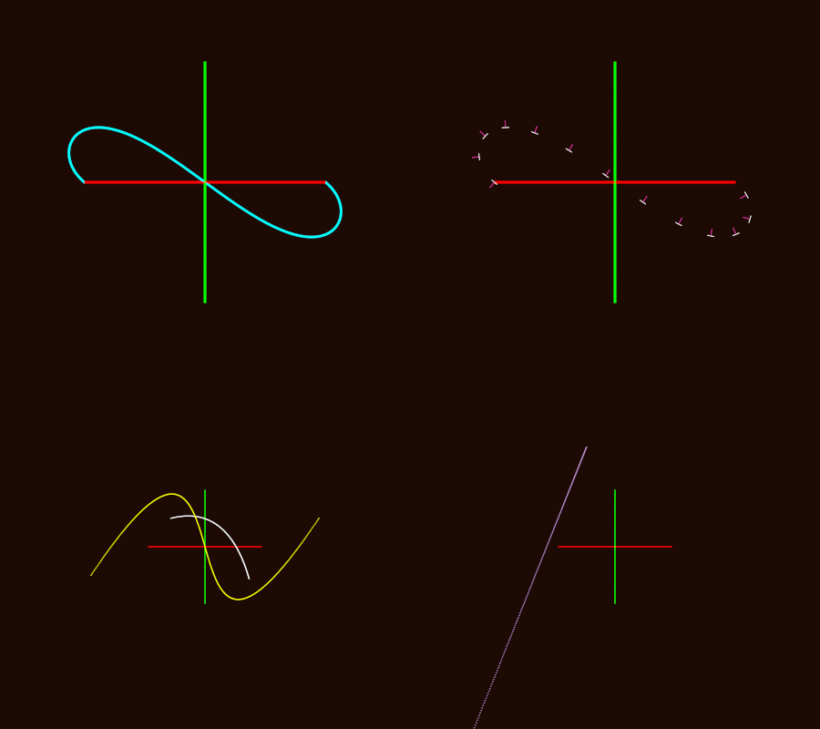

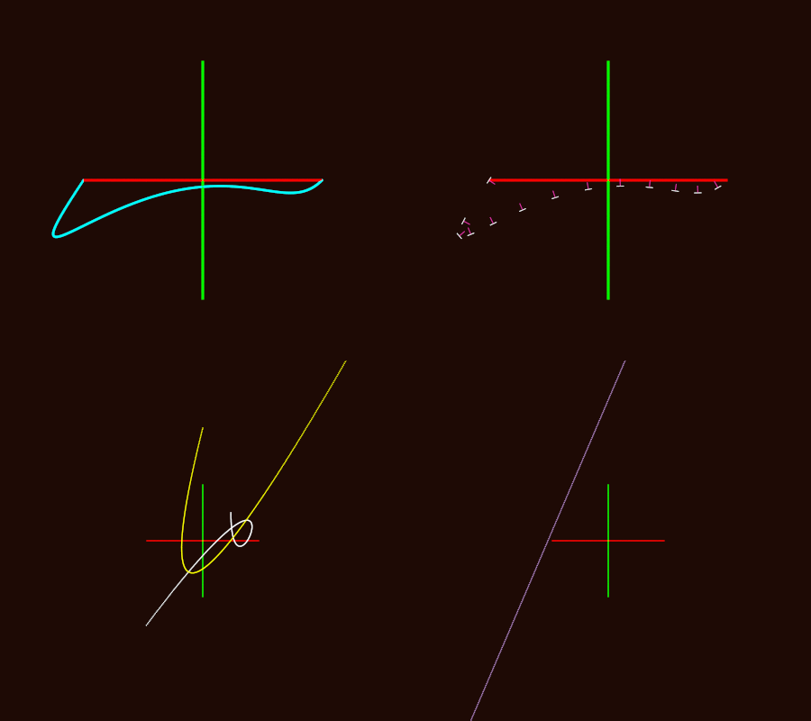

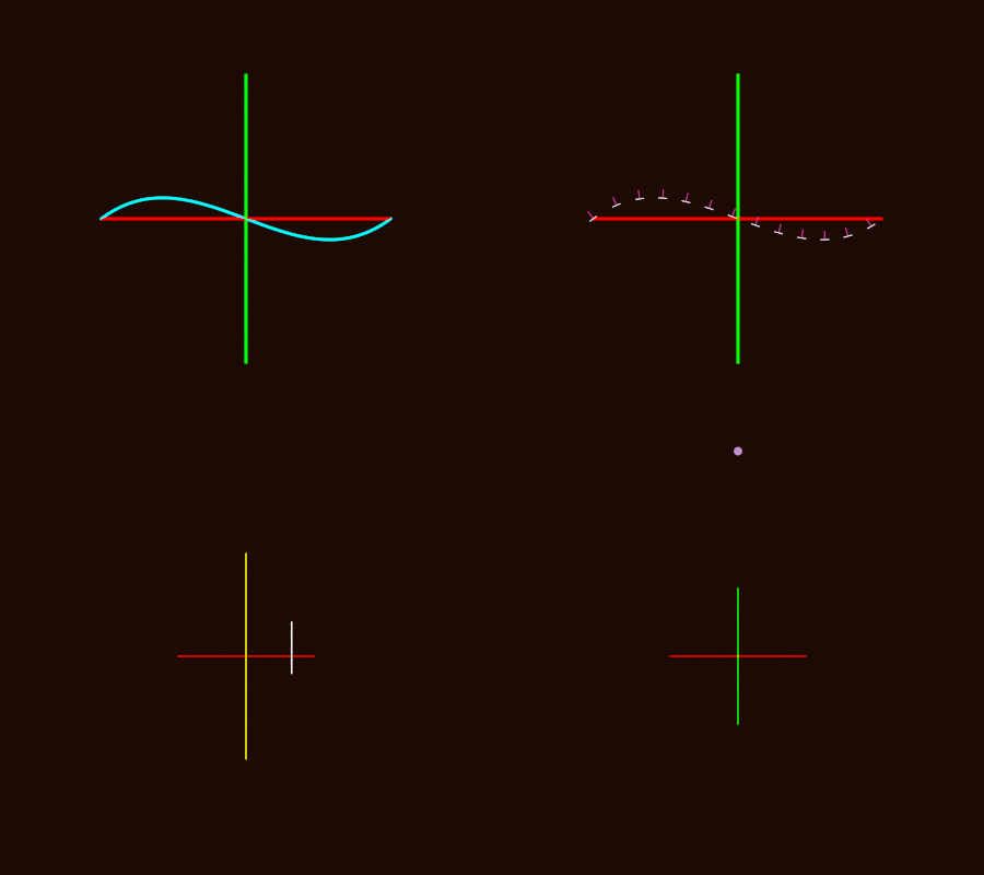

Attaching images showing all six calculation and return modes for
f_bezier_2d_cubic() f_bezier_2d_quartic() and f_bezier_2d_quintic().

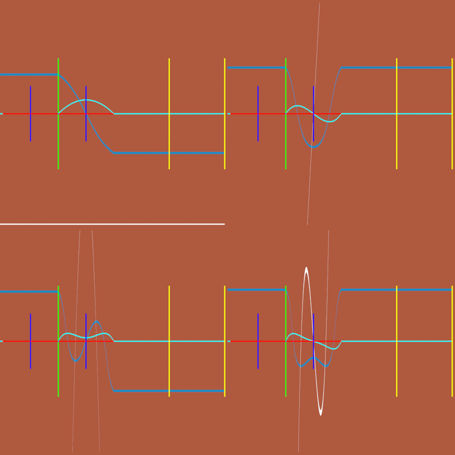

Hi Bill
That is Interesting.
But I can't figure out how to interpret the two bottom graphs in the
attached images.
Tor Olav
http://subcube.com
https://github.com/t-o-k
From: William F Pokorny
Subject: Re: Suggest v4.0 f_bezier_2d_...() functions. (yuqk R19 v0.6.13.0)
Date: 1 Mar 2025 16:52:52
Message: <67c381b4$1@news.povray.org>
> attached images.
I'm uncomfortable with how to represent the derivative graphs where they
turn completely or partially constant.
I needed to normalize returned u,v values to get the scales into
somewhat similar ranges for viewing - which corrupts them some too. The
derivative plots sometimes end up being sets of values more the any sort
of curve. We are looking at spheres at u,v locations.
On the lower left in white are the first derivative x,y points as
spheres. The yellow is the second derivative and here all the values
overlap the y axis.
On the right the purple spheres are the completely constant x,y second
derivative values returned. The spheres are all at the same location.

Found one. Quadratic, Cubic on the top. Quartic, Quintic on the bottom.
The cyan is the Bezier curve itself. The slate blue is the normalized
derivative. The white the second derivative - where it crosses the u
axis at y==zero we have the inflection points of the first derivative curve.
