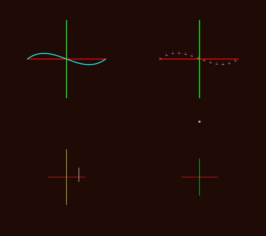

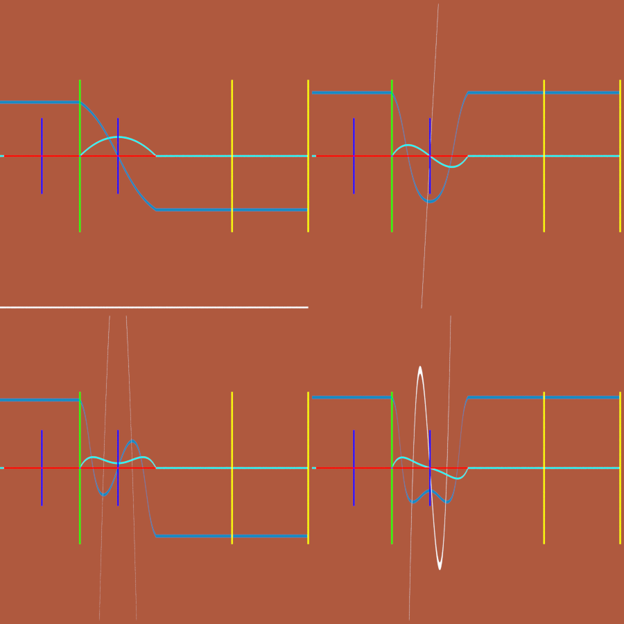

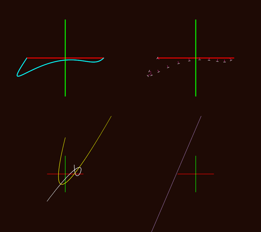

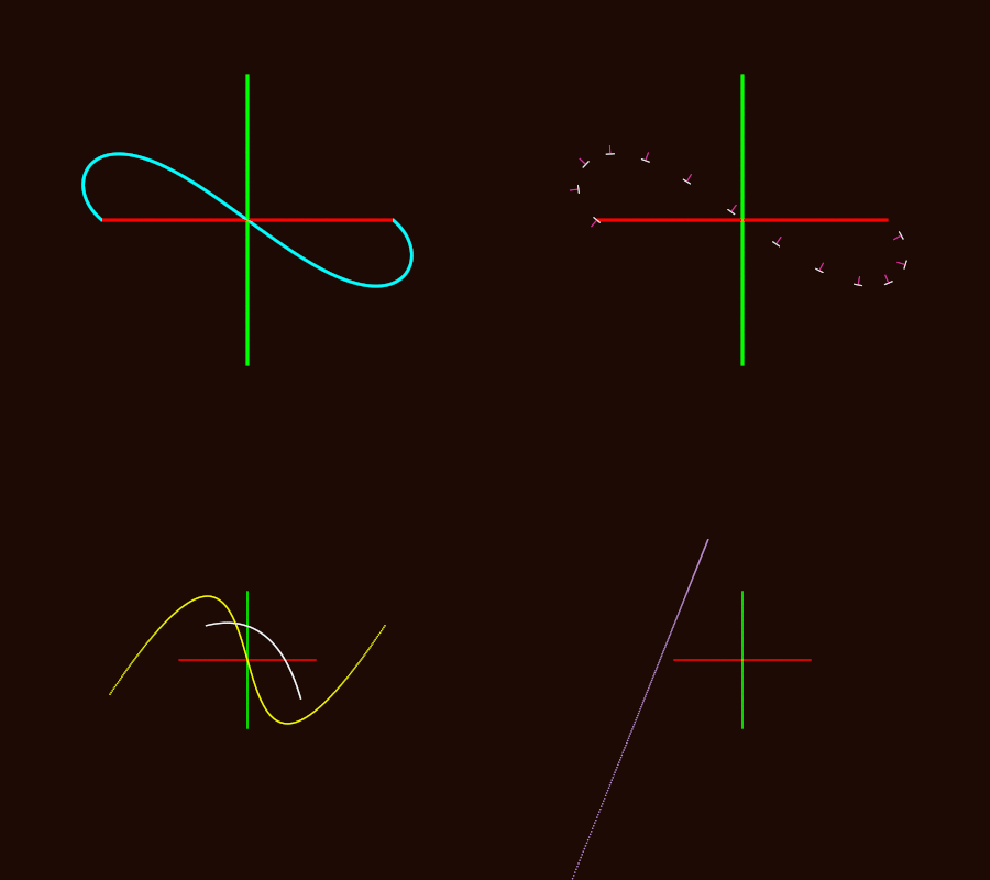

Adding the inbuilt functions: f_bezier_2d_linear()
f_bezier_2d_quadratic() f_bezier_2d_cubic() f_bezier_2d_quartic() and
f_bezier_2d_quintic() to the next yuqk release (R19).
The functions take and return single float packed 2d vectors in a
double's space for control points and return values. Calculations are at
double float accuracy internal to each functions code. The t parameter
is passed as a double.
The calculation and return mode settings:
   0=<u,v> at t.
   1=<u',v'> at t.             (Tangent normalized)
   2=<normal u,normal v> at t. ((1) rotated for normal)
   3=<u',v'> at t.             (Tangent / velocity)
   4=<u'',v''> at t.           (Acceleration / change in tangent)
   5=<u''',v'''> at t.         (Jerk / change in acceleration)
Attaching images showing all six calculation and return modes for
f_bezier_2d_cubic() f_bezier_2d_quartic() and f_bezier_2d_quintic().
Bill P.

The code approach settled upon will I believe easily map to 3D vectors
excepting the normal mode (2) calculations. Holding off though, I'd like
to play with this new 2d code for a while and, as inbuilt functions,
we'd end up working in a three, 21bit, float packed, reduced range for
the easy 3D adoption.
IIRC, Bald Eagle asked whether the derivatives weren't lower orders of
the Bezier curve itself. I currently believe the answer to be, yes, with
qualifications.
First, there are compensating factors for each derivative order based
upon the initial Bezier curve:
Quadratic derivative factors:
   '   --> 2
   ''  --> 2
   ''' --> DNA
Cubic derivative factors:
   '   --> 3
   ''  --> 6
   ''' --> 6
Quartic derivative factors:
   '   --> 4
   ''  --> 12
   ''' --> 24
Quintic derivative factors:
   '   --> 5
   ''  --> 20
   ''' --> 60
I used 1/(factors above) multipliers to better view the raw 1st, 2nd and
3rd derivative value curves(*) (modes 4,5 and 6) together. The
derivative value curves(*) tend to get much larger as the derivative
order increases.
Second, some algebra is required to come up with the new P' factors for
each derivative Bezier curve.
(*) - The curves are showing the entire sample set of values as spheres.
The strict sphere(t) curve may have folds where parts of the apparent
curve are getting retraced.

Hi Bill
That is Interesting.
But I can't figure out how to interpret the two bottom graphs in the
attached images.
Tor Olav
> attached images.
I'm uncomfortable with how to represent the derivative graphs where they
turn completely or partially constant.
I needed to normalize returned u,v values to get the scales into

On the lower left in white are the first derivative x,y points as
spheres. The yellow is the second derivative and here all the values
overlap the y axis.
On the right the purple spheres are the completely constant x,y second
derivative values returned. The spheres are all at the same location.

Found one. Quadratic, Cubic on the top. Quartic, Quintic on the bottom.
The cyan is the Bezier curve itself. The slate blue is the normalized
derivative. The white the second derivative - where it crosses the u
axis at y==zero we have the inflection points of the first derivative curve.
