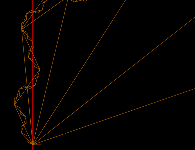

What logic is that? To me it seems feasible that if you just consider
the very left-most piece at each iteration, it's just rotating
anti-clockwise, so eventually it might start to point left rather than
right?
> but
> I consistantly get a couple coordinates outside that area for values of epsilon
> smaller than ~0.17
FWIW if you zoom in on the POV version it does indeed go back further
than the starting point after the 5th iteration (see attached).
Download 'croppercapture[9].png' (22 KB)
> right?
It occurred to me that it could be the rotation as I was going to bed.
A.D.B.
