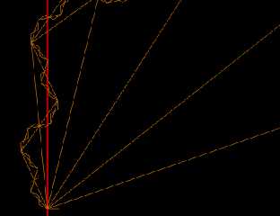

FWIW if you zoom in on the POV version it does indeed go back further
than the starting point after the 5th iteration (see attached).
Download 'croppercapture[9].png' (22 KB)
