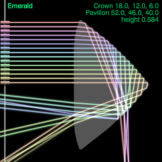

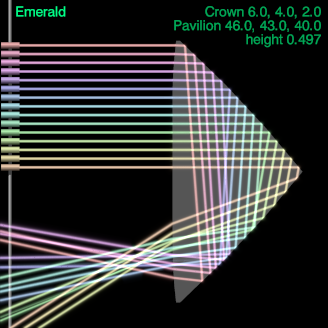

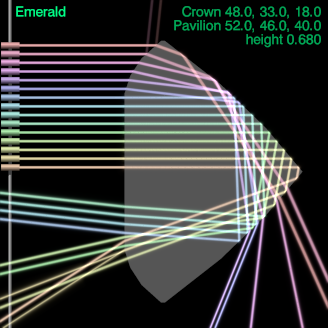

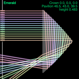

So, I tried finding some viable angles myself.  I'm not having any luck;
all but the shallowest crowns leak light like a sieve:
     Demonstrates the range of pavilion angles that contain the light
     with a flat crown.
     Any crowns steeper than this will leak light.
     A damn shallow crown.
     And it doesn't get any better at steeper angles.

I went searching deeper, and found a cut designed by Jim Perkins, and
published in Lapidary Journal Jewelry Artist, October 2010.  Although
his cut is not a traditional step cut, I tested his angles in my rig:
     The angles Perkins used on the long side of his cut.
It still leaks, even though he calibrated his cut for an IOR of 1.54,
which I imagine less forgiving than emerald's.  Is it possible to get a
leakless emerald cut with a decent crown?  Or do they count on leaked
light being reflected back from the setting?  Will light coming into the
crown at an angle leak less, or at least compensate?  (I suppose I can
find out if I budget more render time.)  Can someone channel Steve Paget?
Download 'emerald_specs-flat.png' (74 KB) Download 'emerald_specs-near_flat.png' (73 KB) Download 'emerald_specs-shallow.png' (70 KB) Download 'emerald_specs-steep.png' (79 KB) Download 'emerald_specs-perkins-long.png' (79 KB)

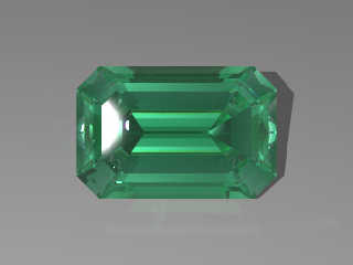

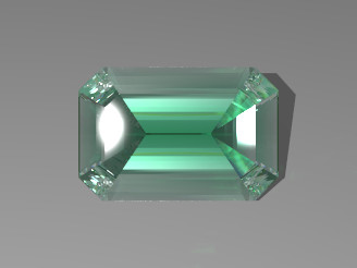

These are rendered with the light source slightly offset, because in
real life, lights directly behind us don't shine through our skulls.
The stones are tilted 45 degrees from the vertical, with the camera
positioned perpendicular to the table.
   Has the same cross section as emerald_specs-near_flat.png.  No light
   leakage, but it looks pretty pathetic.
Download 'test_gemcuts-emerald-face.jpg' (13 KB) Download 'test_gemcuts-emerald-near_flat.jpg' (12 KB)
Preview of image 'test_gemcuts-emerald-face.jpg'
Preview of image 'test_gemcuts-emerald-near_flat.jpg'
