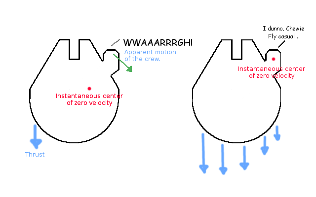

From: Francois Labreque
Subject: Re: Spaceship maneuvering
Date: 11 Jan 2016 11:18:58
Message: <5693d5f2@news.povray.org>
Le 2016-01-08 22:52, clipka a écrit :
> Am 09.01.2016 um 00:39 schrieb Mike Horvath:
>> I'm building a spaceship in POV-Ray.
>> I think that, normally, you want to put the maneuvering thrusters at the
>> cardinal directions of the spaceship so that you can turn most efficiently.
>> But can you put them at other places too?
>> I mean, instead of just the top/left/bottom/right, can you place
>> additional thrusters around the circumference of the ship?
> Certainly you can -- it'll actually be a bit more effective in terms of
> propellant consumption (probably by a factor of about 1.2).
The fuel-saving factor depends on the geometry of your spaceship (more
specifically, its moment of inertia).  And you probably need to take the
occupants' well being in consideration as well*, and not just your fuel
mileage.
For example, if the Millenium Falcon wants to turn right, and only fires
the left-side thruster to turn the ship (minimizing fuel consumption),
it will rotate about an axis (called the "instantaneous center of
zero-velocity") that's somewhere between the central turret and the
cockpit - assuming an uniform mass distribution.  This means the cockpit
will appear to move backwards.  to reduce motion-sickness from the crew,
you would have to fire most thrusters as well, and the left-side ones a
lot more, so that the instantaneous center of zero-velocity is right
undeneath the cockpit, using a lot more fuel.
*Unless, of course, they have Star Trek-like inertial dampers.

From: Anthony D  Baye
Date: 15 Jan 2016 22:20:01
Message: <web.5699b6a53fd50b3d2aaea5cb0@news.povray.org>
> mileage.
> /*Francois Labreque*/#local a=x+y;#local b=x+a;#local c=a+b;#macro P(F//
> /*    flabreque    */L)polygon{5,F,F+z,L+z,L,F pigment{rgb 9}}#end union
> /*        @        */{P(0,a)P(a,b)P(b,c)P(2*a,2*b)P(2*b,b+c)P(b+c,<2,3>)
> /*   gmail.com     */}camera{orthographic location<6,1.25,-6>look_at a }
Keep in mind that they also want to turn gradually, not make a right angle and
fly off in a new direction instantly, because of inertia.
Assuming that they did simply turn the ship at a right angle, they'd still need
to fire the off-side thrusters to control the turn.  It makes sense, if you
assume that they're already burning their thrusters, that they simply relax the
thrust on one side and then gradually shift the thrust back to center, so that
the center of pressure is always behind the center of gravity.
A.D.B.

I don't know that it's the acceleration that's causing the nausia in the MF
example above, as much as it's the dissonance between the physically percieved
motion of the ship and the motion as relayed to the brain by the eyes.
Like when you stand on a bridge, watching the water flow benieth you, and you
get the feeling that the bridge is moving the opposite direction, except in that
case, your standing still, while on the Falcon, you'd actually be in motion, but
not in the way your eyes tell you.
For the actual physics, I'll have to trust the experts.
A.D.B.

Not exactly -- it's not so much a dissonance in perceived motion as it
is a dissonance in perceived acceleration (primarily in the absence or
direction thereof) and/or perceived change in attitude. Your eyes
constitute your only sense that can perceive motion, so there cannot be
any dissonance in that, whereas acceleration and changes in attitude are
detected by both your eyes and your vestibular system (a part of the
inner ear).
But that just causes a weird feeling, not nausea. Your eyes may be at
dissonance with reason, but reason is presumably the highest-level
function of the brain, whereas nausea is among the most fundamental
functions, that there is no such thing as nausea from a dissonance
between perception and reason.
And who would that be?
I would have serious doubts about the "expert" status of anyone claiming
that real-world space pilots "want to turn gradually, not make a right
angle and fly off in a new direction instantly". It is certainly
well-advised to avoid excessive g forces, and there may be reasons to
avoid fast changes in attitude in preparation for a turn, but barring
that, there are in fact at least two compelling reasons to make any
actual changes in trajectory pretty sharp: (1) There is (almost) always
a single ideal point in time where the change in trajectory is least
expensive in terms of propellant use; and (2) computing the parameters
for an engine burn required to transit from one particular trajectory to
another is quite easy for sufficiently short burn times, but gets more
complicated the longer the burn takes.
