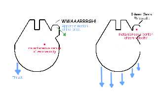

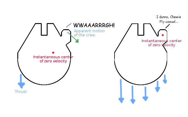

The fuel-saving factor depends on the geometry of your spaceship (more
specifically, its moment of inertia).  And you probably need to take the
occupants' well being in consideration as well*, and not just your fuel
mileage.
For example, if the Millenium Falcon wants to turn right, and only fires
the left-side thruster to turn the ship (minimizing fuel consumption),
it will rotate about an axis (called the "instantaneous center of
zero-velocity") that's somewhere between the central turret and the
cockpit - assuming an uniform mass distribution.  This means the cockpit
will appear to move backwards.  to reduce motion-sickness from the crew,
you would have to fire most thrusters as well, and the left-side ones a
lot more, so that the instantaneous center of zero-velocity is right
undeneath the cockpit, using a lot more fuel.
*Unless, of course, they have Star Trek-like inertial dampers.
> mileage.
