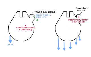

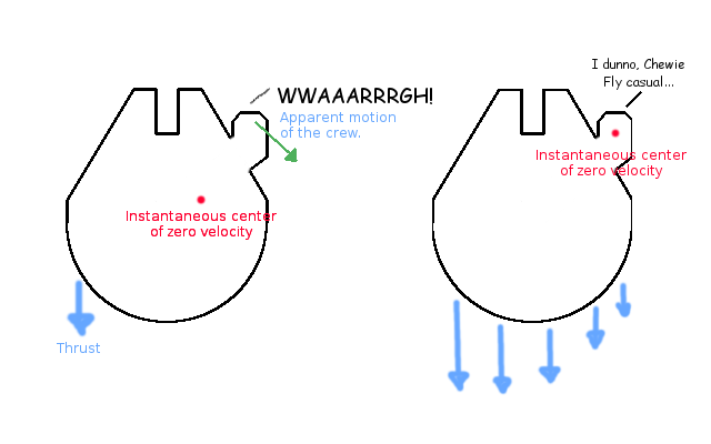

From: Francois Labreque
Subject: Re: Spaceship maneuvering
Date: 11 Jan 2016 11:18:58
Message: <5693d5f2@news.povray.org>
Le 2016-01-08 22:52, clipka a écrit :
> Am 09.01.2016 um 00:39 schrieb Mike Horvath:
>> I'm building a spaceship in POV-Ray.
>> I think that, normally, you want to put the maneuvering thrusters at the
>> cardinal directions of the spaceship so that you can turn most efficiently.
>> But can you put them at other places too?
>> I mean, instead of just the top/left/bottom/right, can you place
>> additional thrusters around the circumference of the ship?
> Certainly you can -- it'll actually be a bit more effective in terms of
> propellant consumption (probably by a factor of about 1.2).
The fuel-saving factor depends on the geometry of your spaceship (more
specifically, its moment of inertia).  And you probably need to take the
occupants' well being in consideration as well*, and not just your fuel
mileage.
For example, if the Millenium Falcon wants to turn right, and only fires
the left-side thruster to turn the ship (minimizing fuel consumption),
it will rotate about an axis (called the "instantaneous center of
zero-velocity") that's somewhere between the central turret and the
cockpit - assuming an uniform mass distribution.  This means the cockpit
will appear to move backwards.  to reduce motion-sickness from the crew,
you would have to fire most thrusters as well, and the left-side ones a
lot more, so that the instantaneous center of zero-velocity is right
undeneath the cockpit, using a lot more fuel.
*Unless, of course, they have Star Trek-like inertial dampers.

I don't know that it's the acceleration that's causing the nausia in the MF
example above, as much as it's the dissonance between the physically percieved
motion of the ship and the motion as relayed to the brain by the eyes.
Like when you stand on a bridge, watching the water flow benieth you, and you
get the feeling that the bridge is moving the opposite direction, except in that
case, your standing still, while on the Falcon, you'd actually be in motion, but
not in the way your eyes tell you.
For the actual physics, I'll have to trust the experts.
A.D.B.
