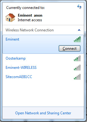

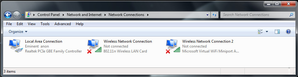

Checking for the network connections, I get the screen in image Network
Connections_01.jpg attached. The used wired connection is at left. I am
concerned with the middle one which says 'not connected'.

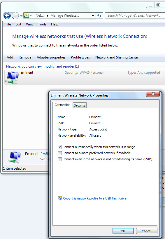

Highlighting it and  clicking 'Connect To' I get the image: Network
Connections.jpg. The highlighted connection should be mine, surprisingly
it does /not/ say 'connect automatically' with a check box, which it did
in the past. See also image: Network properties.jpg. Anyway, clicking
'connect' does not establish the connection but results in an error

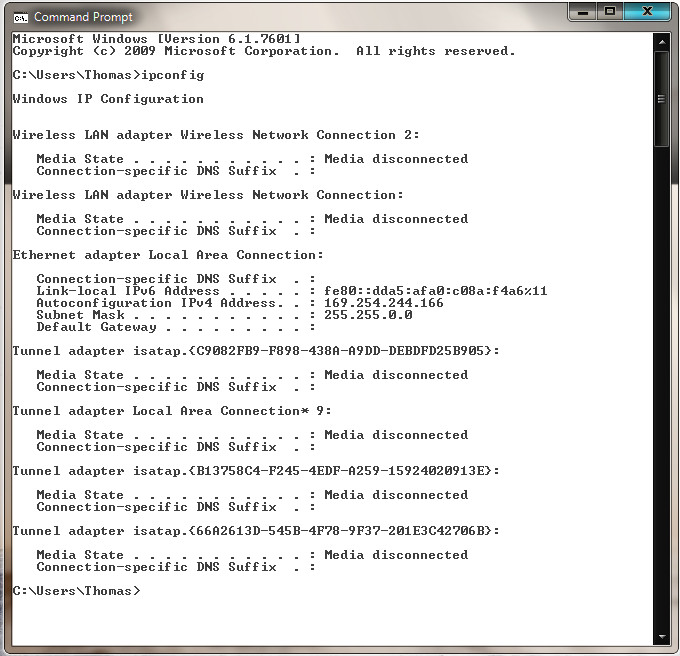

message. As additional info, checking for IP addresses shows the result
in image: ipconfig_on.jpg.

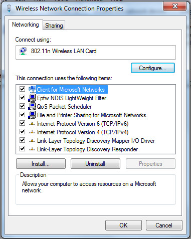

What to do? Something in the Network Connection Properties (image:
Network Connection Properties.jpg)? Or how to make a /new/ network
connection from scratch? Somehow I have not been able to achieve that
:-( Or is there a problem with the Wireless LAN?

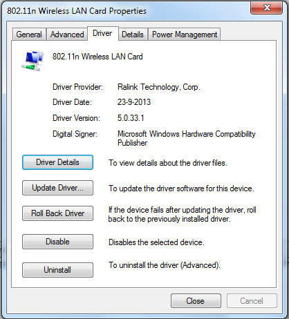

Subject: Re: Wireless connection issue
Date: 19 Jun 2014 10:41:06
Message: <53a2f682@news.povray.org>
On 19-6-2014 15:27, scott wrote:
> - Reinstall your wireless hardware driver (find it in device manager,
> right click on it and choose "uninstall" then restart the machine). That
> should make it reinstall the drivers and then create a new connection
> from scratch.
I assume you mean this (see image) in Win7?
Download 'wireless lan card properties_drivers.jpg' (73 KB)
Preview of image 'wireless lan card properties_drivers.jpg'
From: scott
Date: 19 Jun 2014 10:51:10
Message: <53a2f8de$1@news.povray.org>
>> from scratch.
Yep - I'd just hit uninstall and then restart the machine, it should
then find the "new" hardware and install the driver for it when it
restarts. Make sure you have a copy of the driver handy just in case
Windows has lost it... (maybe a good opportunity to check you have the
latest one anyway).
