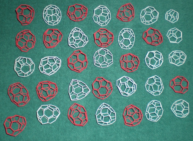

Non-spherical geodesic domes -- dual to figures like the attached --
where the pentagonal hubs are *not* arranged as the vertices of an
icosahedron.  The "parts" I mentioned are the hubs, the "nodes" are the
tips of five or six radiating rods; each tip seeks a corresponding tip.
(In general the nodes won't exactly match, and even if they did there
would be an angle between rods; cubic splines will cover both flaws.)
