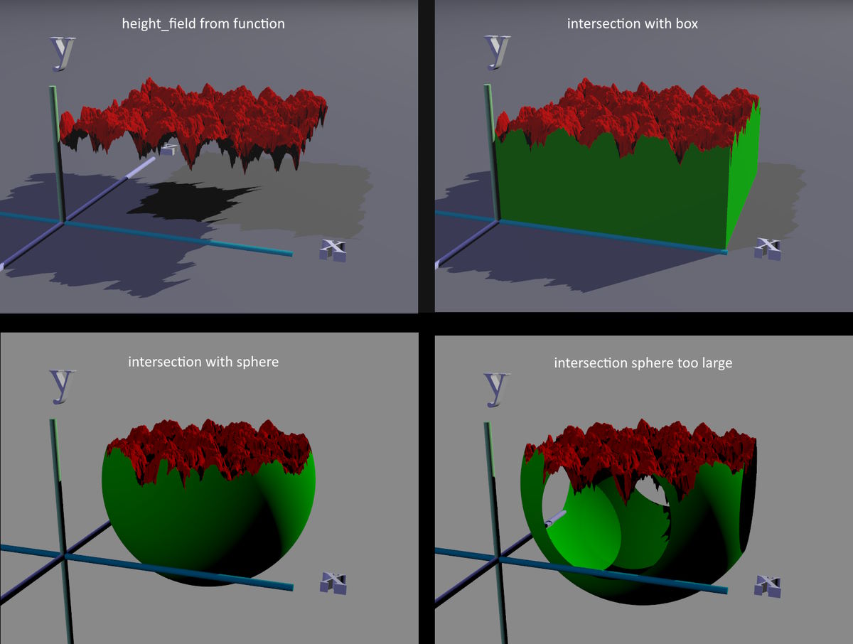

BTW:
A height_field can actually be 'solidified' to look like a regular object, by
making an intersection{...} of it with another slightly smaller object. This
might help to better-visualize its behavior. (The empty space 'under' a
floating HF can be considered part of it-- down to -y infinity.) Try this:
intersection{
box{0.01, 0.99  pigment{green 0.8}}
// OR...
// sphere{0,0.5 translate <0.50,.25,0.5> pigment{green 0.8}}
height_field{
function 500,500 {...your function...}
smooth
pigment{red 0.8}
scale <1,0.5,1>
scale 1.0 // final scale of everything
Download 'function_hf_with_intersection.jpg' (94 KB)

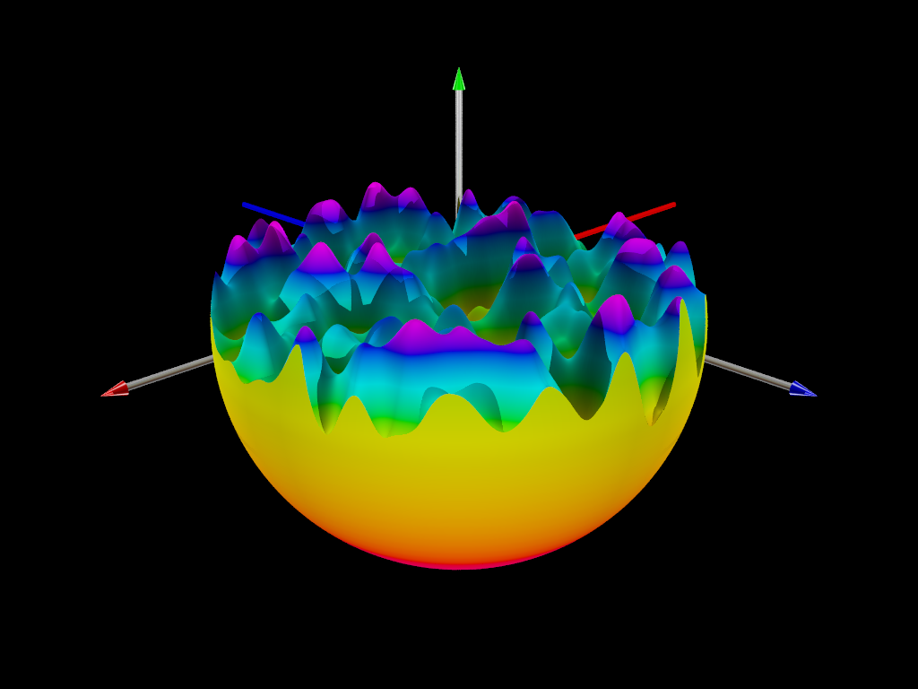

From: yesbird
Subject: Re: Using a function in a height_field declaration
Date: 15 Feb 2023 18:00:00
Message: <web.63ed62a543a1dd8868fd655b10800fb2@news.povray.org>
Interesting !
In combination with colormaps very attractive effect achieved. I will put it in
macro, with parameters.
#include "playground.inc"
#include "colormaps.inc"
// Axis
axis (1.2,0.8,1.2,0.01)
// Cameras
// camo (5,5,5,0,0,0,45)
camp (2,2,2,0,-0.25,0,45)
// Prepare colormaps of desired transparency
#declare _f = 0;
#declare _t = 0;
#declare jet    = make_colormap (jet_arr,    _f, _t);
#declare spring = make_colormap (spring_arr, _f, _t);
#declare hot    = make_colormap (hot_arr,    _f, _t);
#declare winter = make_colormap (winter_arr, _f, _t);
#declare hsv    = make_colormap (hsv_arr,    _f, _t);
#declare autumn = make_colormap (autumn_arr, _f, _t);
#declare parula = make_colormap (parula_arr, _f, _t);
#declare summer = make_colormap (summer_arr, _f, _t);
#declare turbo  = make_colormap (turbo_arr,  _f, _t);
#declare cool   = make_colormap (cool_arr,   _f, _t);
// Object
intersection{
  box{0.01, 0.99
  pigment {  gradient y
               color_map {hsv}
               translate -y*0.1
               scale 0.6 }
  height_field{
    function 500,500 { pattern { bozo scale 0.08 } }
    smooth
               color_map {hsv}
               translate -y*0.81
               scale 0.8 }
    scale <1,0.4,1>
  scale 1.0
YB
Download 'height_field_int_cmap.png' (211 KB)
Preview of image 'height_field_int_cmap.png'

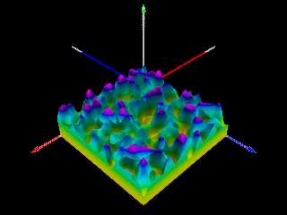

From: yesbird
Date: 15 Feb 2023 20:40:00
Message: <web.63ed885c43a1dd8868fd655b10800fb2@news.povray.org>
It seams to me this is a theme for animation.
Download 'height_field_int_cmap.png' (136 KB)

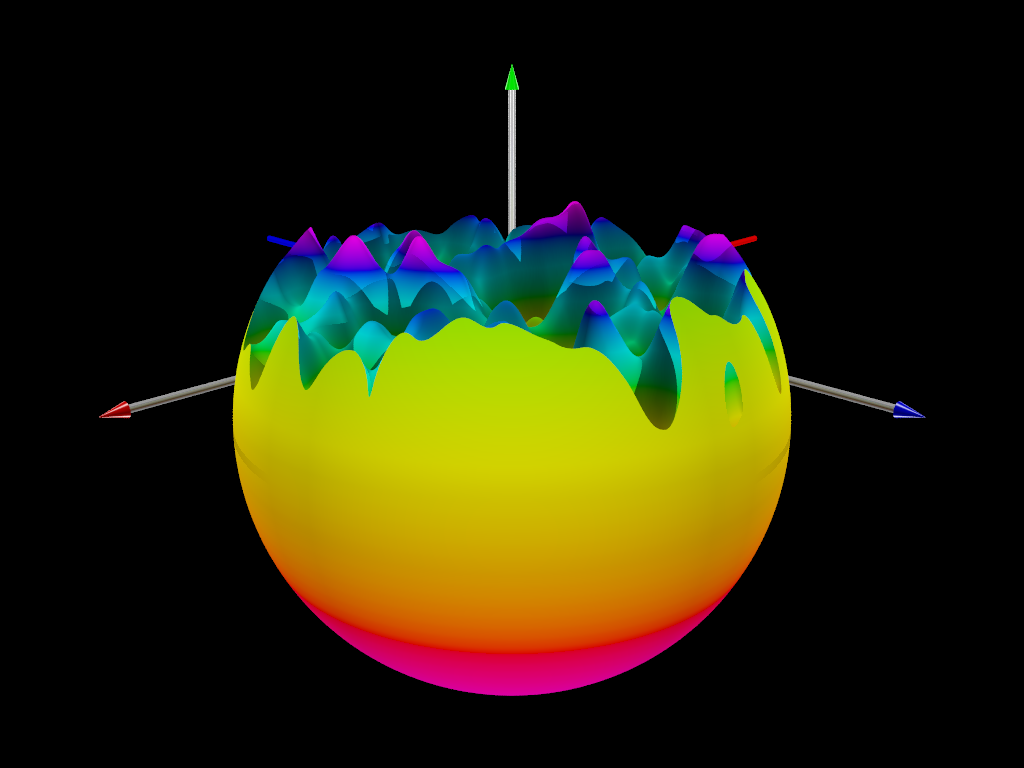

From: yesbird
Date: 15 Feb 2023 20:45:00
Message: <web.63ed89f243a1dd8868fd655b10800fb2@news.povray.org>
And finally - pie :)
Download 'height_field_int_cmap.png' (164 KB)
