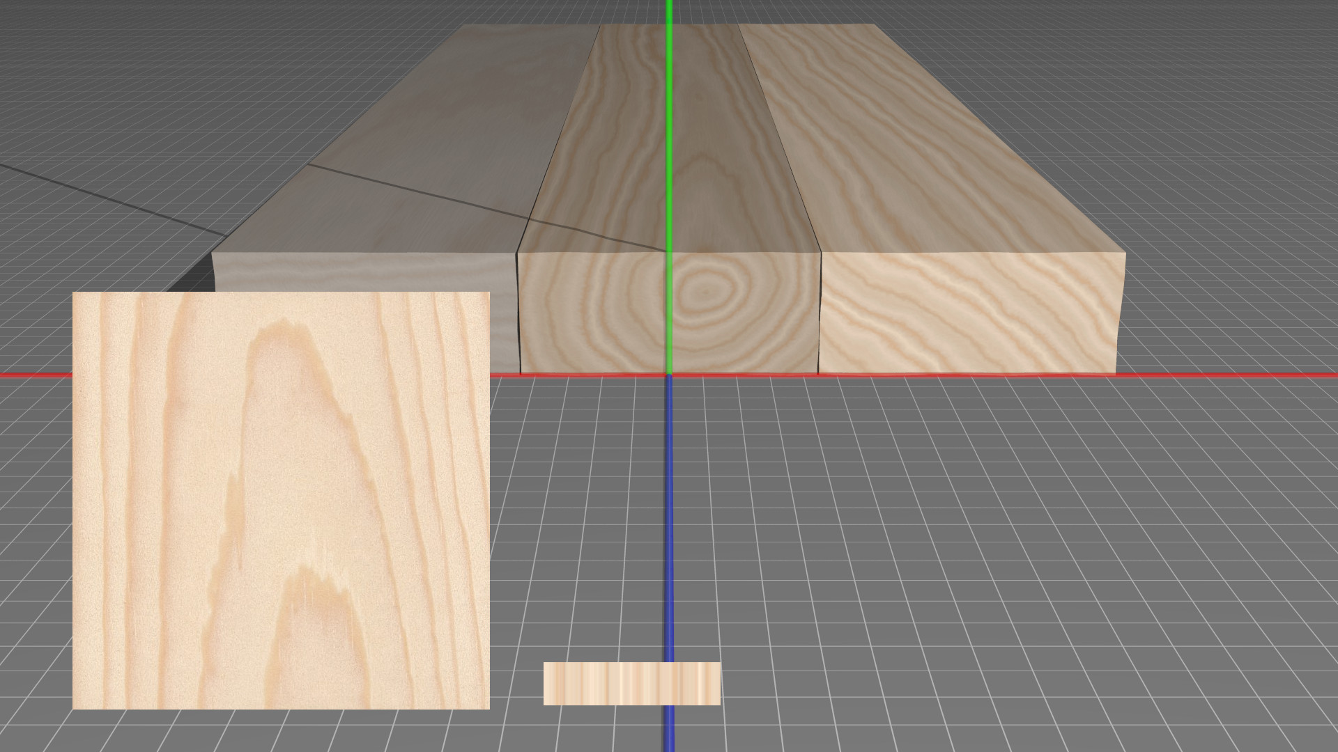

Maybe this is an obvious trick to some of the veterans here, but I thought it
was an interesting way to get good color maps for wood, so here it goes.
I was working on some wood flooring for a scene and found a site called
wood-database.com that has images and information on lots of different types of
wood, including images of lumber made from the types of wood.
I downloaded an image of the wood I wanted to replicate in my scene, (the lower
left inset in the image below), and imported it into GIMP.  In the Colors/Info
menu there is a "Smooth Palette" option that creates a palette of the colors in
the image, (seen to the right of the inset).  I exported that as a JPEG and then
used some macros I created to pull out the POV-ray colors from the image.  I
have used both interpolation and non-interpolation for different effects.  I
then use those colors, in the order given, to create the color map for the wood
texture.
Coming up with the wood pigment and warps is still mostly trial and error, but
the sample is actually pretty close.
The three boards are rendered using variations on the color map.  The center one
is non-translated and unaltered.  The right has been lightened, and the grain
was selected randomly from a normal-sized pine tree.  The left was grayed by
aging, and also randomly selected.
In this particular example, I only sampled the colors from a single ring of the
wood pattern.  For others, the colors vary across rings, so it works better to
use all of the colors in the color map, but scale the pigment so the ring sizes
stay the same.
Anyway, I'm finding this is a lot easier than my usual hit or miss method of
creating a wood colormap, and allows for greater variation in the colors, which
enhances realism.
-- Chris R.
Download 'woodgrains.jpg' (357 KB)

That's excellent Chris. Nice work. I came close to writing a macro to do the
same - generate a pov color_map from a given image. Mind sharing the macro? :)
Mike.

That a really clever technique, and your results speak for themselves-- the wood
looks very natural! I assume you used eval_pigment in your macro, to pick out
the colors from the color-palette JPEG.
My go-to app for image editing is the freebie paint.net; unfortunately, it does
not have such a palette producer built-in, like GIMP does. I need to search for
a similar plug-in for it.
Nice work, and inspiring!

I wrote some similar macro stuff way back:
http://news.povray.org/povray.binaries.images/thread/%3C58cfcd53%241%40news.povray.org%3E/
I also made some numerical patterns to see what parts of each pattern correspond
to what values in the color map
http://news.povray.org/povray.binaries.images/thread/%3Cweb.5a7774f01a0c102c5cafe28e0@news.povray.org%3E/
as well as the recent color map editor thing:
http://news.povray.org/povray.advanced-users/thread/%3Cweb.63ed381961f8e3fb1f9dae3025979125%40news.povray.org%3E/
Hope some of that helps / inspires...
- BW

They look good.
A way to colorize wood is to use the same technique that is used in printing. A
wood is not printed in ymck but in spot colours on a coloured base. In general
only three ink colours are needed.
It starts with how the design is built. The first layer is just density
modulation without detail. The second layer give the general idea of the design
and the last layer gives the fine detail like the grain. All inks are lasure
inks, they are transparent.
The main colour of the design is defined by the base film colour. The first
layer is printed "tone in tone" and darker than the base colour, and has the
opposite "temperature". Cool gray vs warm gray. The next layer can be more
contrasting and the grain layer can be even more contrasting. For an oak you can
go very dark brown or even white for a white wash effect. The mixing of all the
colours, as they are transparent, gives a very rich and natural look.
To make a floor all that one needs to do to get some variation is to slightly
randomize the base colour per board.
ingo

I am doing some more experiments and cleaning up the code.  I'll get around to
posting it eventually after I look at some of the suggestions from below as
well.  The version I have right now just creates a pigment function using an
image_map from the palette jpeg, and then scans it from <0,0,0> to <1,0,0> in
steps based on the size of the color map I want to generate.  It then just dumps
the colors it found using #debug as a color_map {} and I copy and paste from the
message window into my code.
There's a bunch of things to clean up based on failed experiments.
-- Chris R.

Actually, I rolled my own version of eval_pigment by creating a pigment function
and then just calling it repeatedly as I moved along the palette jpeg.  I wasn't
worried about speed since this is something I do in the modeling stage rather
than the rendering stage.  (To be honest, I didn't look to see if there was
something built in to do this already...)
-- Chris R.

Thanks, I will look into this.  I should probably make it a habit to just search
the newsgroups for your posts before I start writing code.  :-)
-- Chris R.
:D  tbh, I do the same thing a lot.
Heck, I even wind up rewriting a lot of my own code.
It _IS_ a good thing when people make their own attempts, since they might solve
things that I got wrong or others thought "impossible".  "I didn't know I
couldn't do that - - - so I just did it."
Also, you might wind up doing the same thing but approaching the end goal in a
different way, which might lead to improvements in speed / efficiency /
photorealism.
I generally find that the difficult part is not acquiring the pallette of colors
to interpolate with the color_map, but doing it in such a way that it winds up
resembling what I'm trying to model with a procedural pattern.
If you look into optical illusions, it becomes immediately apparent that the
actual color value employed matters far less than the visual context that your
brain interprets it in.
And that's where things get challenging, and it becomes more art and less math,
science, and engineering.
I DO particularly like the suggestion to use layered textures with filter - some
sort of commercial algorithm to make laminated faux woodgrain would be a great
basis for a realistic wood texture.
- BW
