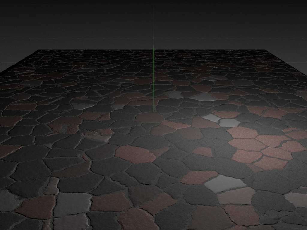

I like to use the crackle pattern for creating stone pavers for floors, rough
stone walls, etc. I use the pattern to outline the stones in an isosurface, and
then apply a texture on it.
This all works well if I want the stones to be of a uniform type, but I haven't
found an effective way to do this when I want some variations in the types of
stones.  I do something similar with brick walls and floors, but since bricks
have a regular shape, I can use warp repeats to ensure that individual bricks
have a consistent texture, but are randomized between bricks.
Has anyone come up with a trick to do something similar with irregular patterns
like crackle?  I usually end up using some sort of random pigment pattern with
the different textures I want to apply, (see the image below), and then
scale/rotate/translate it to match the stones as best I can, but there is always
bleeding between them.
-- Chris R.
Download 'cabin.png' (690 KB)
Preview of image 'cabin.png'

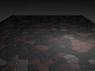

That's brilliant!  I don't know how I missed that in the documentation, (or
maybe I just never understood what it was trying to say).
What controls the pigment value selected for the cell?  Is it just a random
number, or do proximate cells select from the same value range.  I'm finding the
more variation with smaller ranges in my pigment_map, the less "clumpy" the
cells become, but does it follow the normal ramp_wave or is it just a linear
random number?
-- Chris R.
Download 'cabin.png' (730 KB)

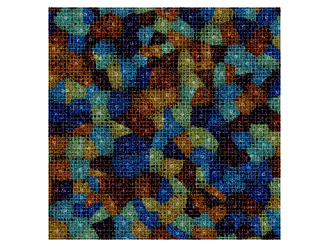

> random number?
From source/core/material/pattern.cpp
There's a few extra pre-main-pattern sections, and I've always wanted to
translate the source code algorithm into SDL so that people could vary the field
of random points, or otherwise modify the pattern to suit their needs.
The following may also interest you:

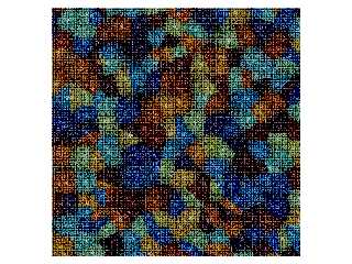

> I've had a lot of success (not 100%) with adapting ShaderToy code to SDL, so
> maybe at some point I can figure out how to make a voronoi pattern in SDL based
> on some of the scripts.
Y'know - like this:
I'm not sure when I make all the squares or spheres fill up everything that it
turns black, with a few colored spots.  My POV-Ray suckage, likely.
But it's proof of concept, so here we go.
Next stage would be to code it using only functions, and then it could be used
as a pigment pattern.
#version 3.8;
global_settings {assumed_gamma 1.0}
#include "colors.inc"
//#include "BezierInclude.inc"
#include "math.inc"
#declare E = 0.0000001;
#declare Camera_Orthographic = true;
#declare Camera_Position = <0.5, 0.5, -100> ;  // front view
#declare Camera_Look_At  = <0.5, 0.5,  0> ;
#declare Fraction = 450;     // functions as a zoom for the orthographic view: 4
zooms in 4x, 8 zooms in 8x, etc.
camera {
 #if (Camera_Orthographic = true)
  orthographic
  right     x*image_width/(Fraction)
  up   y*image_height/(Fraction)
 #else
  right     x*image_width/image_height
  up y
 #end
 location  Camera_Position
 look_at   Camera_Look_At}
sky_sphere {pigment {rgb <1, 1, 1>}}
#declare LS = <0, 0, -20>;
light_source {LS rgb 1}
#declare Line = 0.5/image_width; // line thickness
// DOT product
#declare SFn_vdot = function (ax, ay, az, bx, by, bz) {ax*bx + ay*by + az*bz}
// Length or Norm
#declare SFn_vlength = function (ax, ay, az) {sqrt(ax*ax + ay*ay + az*az)}
#declare Clip = function (_Val, _Min, _Max) {min(_Max, max(_Val, _Min))}
#declare Window = function (_Val, _Eq, _Min, _Max, _E) {select (_Val-_Min, _Val,
select(_Max-_Val, _Val, _Eq))}
#declare LimitReps = function (Element, Period, Min, Max) {Element - Period *
Clip (Element/Period, Min, Max)}
#declare Smoothstep0 = function (_Val, _From, _To) {Clip ((_Val - _From) / (_To
- _From), 0.0, 1.0)}
#declare Smoothstep = function (_Val, _From, _To) {Smoothstep0 (_Val, _From,
_To) * Smoothstep0 (_Val, _From, _To) * (3.0 - 2.0 * Smoothstep0 (_Val, _From,
_To))}
#macro Clamp (N, minVal, maxVal)
 #local Val = min (max (N, minVal), maxVal);
 Val
#end
#macro hash (p)
 // input: 2D vector
 // output: 2D vector
    //p = mod(p, 4.0); // tile
    #local PX = vdot (p, <127.1, 311.7>);
    #local PY = vdot (p, <269.5, 183.3>);
    #local PXr = mod (sin (PX)*18.5453, 1);
    #local PXy = mod (sin (PY)*18.5453, 1);
    <PXr, PXy>
#end
// return distance, and cell id
#macro voronoi (P)
 // input: 2D vector
 #local nx = floor (P.x);
 #local ny = floor (P.y);
 #local n  = <nx, ny>;
 #local fx = mod (P.x, 1);
 #local fy = mod (P.y, 1);
 #local m = <8, 8, 8>;
 #for (j, -1, 1)
  #for (i, -1, 1)
   #local g = <i, j>;
   #local o = hash (n + g);
        // #local r = g - f + o;
   #local rx = g.x - fx + (0.5 + 0.5*sin(clock + 6.2831*o.x));
   #local ry = g.y - fy + (0.5 + 0.5*sin(clock + 6.2831*o.y));
   #local r = <rx, ry>;
   #local d = vdot (r, r);
   #if(d < m.x)
    #local m = <d, o.x, o.y>; // m = vec3 (d, o);
   #end
  #end
 #end
 <sqrt (m.x), m.y + m.z>;
#end
#local M = max(image_width,image_height);
#local D = 1.75;
#macro mainImage (X, Y)
   #local PX = X / M;
   #local PY = Y / M;
   // computer voronoi pattern
   #local C = voronoi ( <(14.0 + 6.0 * sin (0.2*clock)) * PX,  (14.0 + 6.0 * sin
(0.2*clock)) * PY>);
   // colorize
   #local ColorR = 0.5 + 0.5 * cos (C.y*6.2831 + 0);
   #local ColorG = 0.5 + 0.5 * cos (C.y*6.2831 + 1);
   #local ColorB = 0.5 + 0.5 * cos (C.y*6.2831 + 2);
   #local C1 = Clamp (1.0 - 0.4*C.x*C.x, 0.0, 1.0);
   #local ColorR = ColorR * C1;
   #local ColorG = ColorG * C1;
   #local ColorB = ColorB * C1;
   #local C2 = (1.0 - Smoothstep (0.08, 0.09, C.x));
   #local ColorR = ColorR - C2;
   #local ColorG = ColorG - C2;
   #local ColorB = ColorB - C2;
   #local fragColor = <ColorR, ColorG, ColorB>;
   //sphere {<PX, PY>, Line*2 texture {pigment {rgb fragColor} finish {diffuse
1}} }
   //sphere {<PX, PY>, Line*2 pigment {rgb fragColor} }
   box {<PX-Line*D, PY-Line*D, 0>, <PX+Line*D, PY+Line*D, Line> pigment {rgb
fragColor} }
#end
#declare Step = 2;
 #for (Y, 0, image_width, Step)
  #debug concat("Y = ", str(Y, 0, 0), "\n")
  #for (X, 0, image_width, Step)
   mainImage (X, Y)
  #end
 #end
vec2 hash( vec2 p )
    p = vec2(dot(p,vec2(127.1,311.7)),
             dot(p,vec2(269.5,183.3)));
    return fract(sin(p)*18.5453);
vec2 voronoi( in vec2 x )
    vec2 n = floor( x );
    vec2 f = fract( x );
 vec3 m = vec3( 8.0 );
    for( int j=-1; j<=1; j++ )
    for( int i=-1; i<=1; i++ )
        vec2  g = vec2( float(i), float(j) );
        vec2  o = hash( n + g );
      //vec2  r = g - f + o;
     vec2  r = g - f + (0.5+0.5*sin(iTime+6.2831*o));
  float d = dot( r, r );
        if( d<m.x )
            m = vec3( d, o );
    return vec2( sqrt(m.x), m.y+m.z );
void mainImage( out vec4 fragColor, in vec2 fragCoord )
    vec2 p = fragCoord.xy/max(iResolution.x,iResolution.y);
    // computer voronoi patterm
    vec2 c = voronoi( (14.0+6.0*sin(0.2*iTime))*p );
    // colorize
    vec3 col = 0.5 + 0.5*cos( c.y*6.2831 + vec3(0.0,1.0,2.0) );
    col *= clamp(1.0 - 0.4*c.x*c.x,0.0,1.0);
    col -= (1.0-smoothstep( 0.08, 0.09, c.x));
    fragColor = vec4( col, 1.0 );
Download 'new_iq_voronoipattern.png' (416 KB)
Preview of image 'new_iq_voronoipattern.png'
Indeed.   If I knew how this all worked and could code it right.  <eyeroll>
Also, these things are SLOW.
I thought the function version would be faster, but this small render took 23.75
min.
My initial frustration with trying to make one of these things was the nested
loops, but I figured I could "unroll" that and just daisy chain the functions.
Which I did, and it works - sorta.
But it's 102 functions, and for some reason it looks like I got the color code
wrong too.
It also look like there are different methods for generating the Voronoi
pattern, and this one is (obviously) grid based, like POV-Ray's.   I'll have to
try my hand at one with a much more arbitrary data set.
Also: Chris R - are you aware that you can get a Voronoi pattern just using
overlapping cones?  Depending on what you're planning to do with it, that would
be both super easy and FAST.  And from what I understand, it's actually a
legitimate Voronoi result.
https://smathermather.com/2012/01/20/fast-calculation-of-voronoi-polygons-in-povray/
From: Bald Eagle
Subject: Re: Crackle
Date: 15 Nov 2022 14:55:00
Message: <web.6373ed82302862a41f9dae3025979125@news.povray.org>
Maybe it would help if I attached the render.   :|
Download 'new_iq_voronoifunction.png' (137 KB)
Preview of image 'new_iq_voronoifunction.png'
