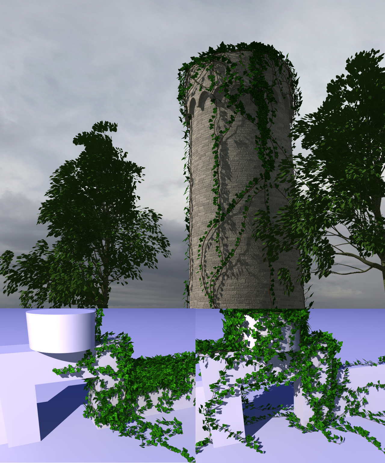

last week I started to write a little ivy generator which can interact with
every povray object. I was a bit inspired by the generator by Thomas Luft
(http://graphics.uni-konstanz.de/~luft/ivy_generator/) which only work with
mesh objects. Please leave comments on how to increase realism,
many thanks,
hobBIT

I forgot to say, the upper image: Trees are generated with povtree (tomtree
frontend), the sky is a huge texture from cgtextures.com and the tower is
created with superellipsoids using a macro.
Looks great!
In the tower image, it looks like a large curved section
near the bottom is too distant from the wall to be attached?
Also, there is a lot of ivy on top of the objects while the
walls are more thinly covered. I'm no expert on ivy but this
seems a bit odd (but probably it just needs more starting
points to cover a wall).
Thanx !
The biggest problem with my generator is the fact it is nearly uncontrollable, a
can weight the growing direction using random, last direction up and down
vectors, twig len and thickness, chance to split and last but not least the
seed base. Every little change results in a totally different "grow". I think,
some adjustments to these parameters will bring a better ivy :) ... Distant
wall<->ivy, you are right, I will make this controllable by 2 new parameters :)
Real ivy gets little hair roots where it attaches to things,
they're a little yellower than the main vine.
It looks perty good already though.
Here's a link with a good photo...
http://www.moplants.com/blog/?p=1081

This is already looking really good! When you say 'every povray object' you
mean 'including mesh2'? That is what I understand.
Subject: Re: Ivy Generator
In some way, real ivy seems to concentrate on the top of walls/objects,
maybe because sunlight is stronger there. At least, that is what I observe
in my garden, so the ivy generator is doing a good job :-)  Thomas Luft's
generator shows exactly the same phenomenon.

Plants will grow towards a light source, it's called phototropism (which I
learned about a long time ago and never thought to find a use for).  you'll find
that in a dark room with light coming through a hole in the ceiling, vines will
grow along the floor toward the light, and will generally try to find the hole
in the ceiling. Perhaps your model could account for the direction of the light
source as well.  It would be a matter of weighting the probability of a split in
a given direction by the amount of light in that direction or the probability of
reaching light by growing in that direction.
Otherwise, I think it's excellent work, and I wonder if it could be applied to
other plant life, like trees and shrubs.
Are you predetermining the starting location, or is it random?
A.D.B.

Thanx, I didn't know this before, but I think this would increase the
scene complexity too much, but I will think about this :-)
hobBIT

At the moment, growing is weighted by 4 factors:
1. follow direction of last segment
2. random
3. gravity
4. "up",
while the last can be seen as growing towards light. It's easy to add
another weight which grows to a given vector, but growing to "light" can
be very complex, depending on scene complexity, maybe a path can help
out to accomplish this.
The starting point and primary growing direction are input parameters.
I think about a total replace of the current growing algo, as it always
clamps to any object, so hanging ivy is not really possible atm.
hobBIT
