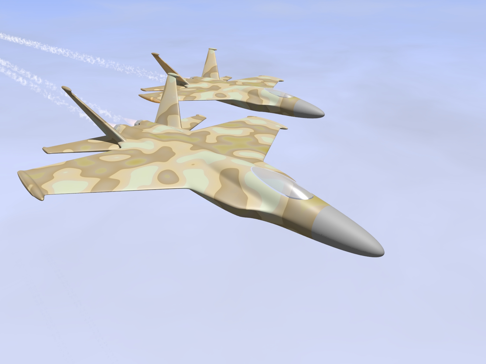

Hi,
I have posted about my jet named the M22 before but I decided that it was time
to post a picture of it.  This render is at 1600x1200 with 0.3 antialiasing and
it took roughly 3.5 days to render.
CREDITS
-thanks to Kevin Loney, Jaap Frank and Tor Olav Kristensen for there isosurface
to mesh conversion include file
-thanks to Rune Skovbo Johansen for his particle system which was used to make
the smoke trail
-thanks to the POV community for all the help whether directly or indirectly
-thanks to the POV-Ray developers for developing such a great piece of software
A little background:
I started modeling this jet 100% in POV-Ray SDL back in March 2008.  I've worked
on it very slowly since then.  The chassis version you see here is an
isosurface, but I also have mesh and CSG versions.  I started this whole thing
because I eventually wanted to make a dogfight sequence but that's a long way
away.
By the way I am aware of the following problems with this render.
-there are 2 artifacts at the engine-nozzle area
-where the cockpit glass meets the main chassis of the plane the blue colour is
suppose to be dark grey
-there is a small shading artifact on the nose cone of the closer plane
All comments and criticisms are welcome.
Bridgeofstraws
Download 'm22 sample scene 3.jpg' (340 KB)
Preview of image 'm22 sample scene 3.jpg'

Very nice!  I, too, am working on some aircraft, both for animations and for the
POV-ray Object Collection.  I am not using csg/isosurfaces, but mostly meshes
produced in Wings3D, as I find that easy to work with.  Of course, when dealing
with meshes, you have to worry about mesh resolution and files sizes and such,
but they render much more quickly. *shrug* there is always a trade off.
I've gotten the body shape done on mine, but at some point I need to do the
landing gear, as well as the interior and pilot.  However, instead of
continuing on that model, I find myself working on a new, VTOL model...
Out of curiosity, are you going to add control surfaces?  Also, how will you
place your craft?  I was going to use the spline_trans macro, but it doesn't
provide enough info directly, so I think I am going to have to partially
re-write it.
-Reactor

It's good to know someone else takes interest in jets as much as I do. :)  To
answer your questions, I do intend to add control surfaces, landing gear,
weapons, a fully automatable cockpit, and a pilot.  This project will take
quite a while but I imagine it will be worth it.  I've already developed a way
to do the flight path animation.  I used 2 spline to do this.  One spline is
used to adjust the jet's roll while the second spline is for actually moving
the jet.  I used the Reorient_Trans with the direction my jet normally faces
(before moving it or rotating it) and a rough approximation of the derivative
of the spline at the current point in time.  The reason I used this instead of
the spline_trans is because I had to move the smoke trail in a way not possible
with the spline_trans macro.  The spline_macro should work great if you are just
moving the jet.  Even if you wanted a lot of control on the banking you could
use the spline_trans with no banking and use a separate spline to roll, similar
to what I did.
I can understand why you're making the aircraft as meshes.  If I was much better
at mesh modeling I would too.  They`d certainly make longer animations more
possible because they are so fast to render.  Something that may interest you
is that half the rendering time was spent on the smoke trail because of the
high max trace level I had to use to remove artifacts and the amount of media
the smoke uses.
Bridgeofstraws

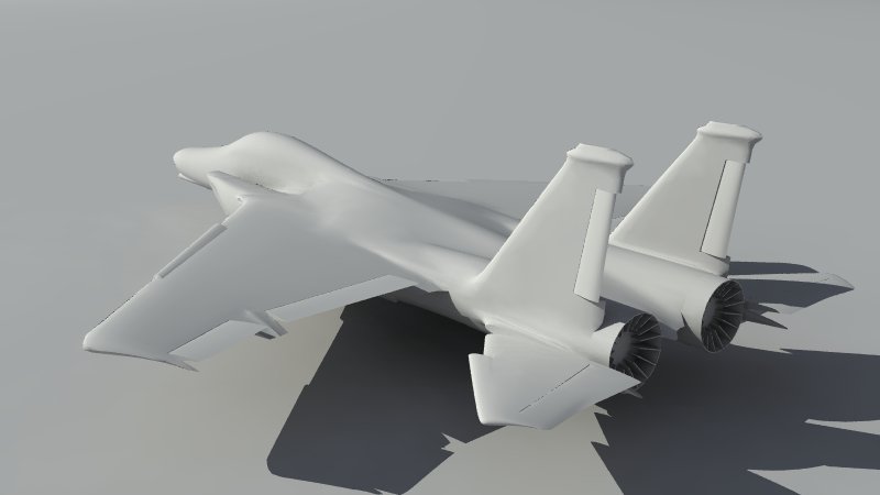

That sounds pretty similar to what I've been looking at in terms of movement.  I
wanted to take it a step further by making the control surface orient themselves
and making vapor trails appear at the right times (by computing curvature &
speed, then placing media containers if the path curvature falls within a
certain range).
I've already cut up and parametrized the control surfaces so that they can be
animated by supplying a value in the range [-1,1], but I haven't done the
landing gear yet, which will be slightly more complex, but not significantly
so.  One issue that I have encountered is the loose tie between frames and real
world time.  I want things like the aircraft navigation lights to flash at a
specific real-world interval, but some scenes may require additional frames for
motion blur averaging.
What are you doing for the engines?  I started by using an emission media, but I
wasn't satisfied with the appearance.  I am considering using a partially
transparent textured cone (or more than one).
Also, if you are still considering a mesh-based approach, I may be able to help
if you are using Wings.
-Reactor
P.S. Attached is an untextured view of the model in progress. The mesh file is
about 1.4 MB, stats on a P4 3.0GHz (single core):
Peak memory used:          35522439 bytes
Total Scene Processing Times
  Parse Time:    0 hours  0 minutes  0 seconds (0 seconds)
  Photon Time:   0 hours  0 minutes  0 seconds (0 seconds)
  Render Time:   0 hours  5 minutes 32 seconds (332 seconds)
  Total Time:    0 hours  5 minutes 32 seconds (332 seconds)
CPU time used: kernel 10.88 seconds, user 313.52 seconds, total 324.39 seconds
Render averaged 1109.77 PPS over 360000 pixels
Download 'ac10 test_2.jpg' (23 KB)

From: Jörg 'Yadgar' Bleimann
Subject: Re: A Jet Fighter
Date: 17 Dec 2008 08:55:48
Message: <494904e4$1@news.povray.org>
High!
Nice contrails - but usually, they start only at a certain distance from
the jet nozzle, as the exhaust gases need to cool to crystallize!
See you in Khyberspace!
Yadgar
> certain range).
> -Reactor
It looks like you are much further in to your project than I am.  I haven't even
thought about control surface alignment or variable contrails.  I would love to
know the equations for determining this stuff.  I may not have sufficient math
background to understand it instantly but that would make animation of the
plane look so much more realistic.
I had thought about using lights on the aircraft before and what I planned on
doing when I got there was just use a constant frame number to real time ratio.
 And if I wanted to add motion blur to parts of the video I was just going to
use VirtualDub (http://virtualdub.sourceforge.net/ - I have an older version)
which has a filter that does motion blur for you with no extra time spent
rendering more frames.  However, I'm sure that rendering more frames and
averaging them would probably create a better result.  I just don't want to add
extra time rendering my animation if unnecessary.
The engine effect for my jet was done using a fairly turbulent bozo patterned
emissive media with a cone shaped container.  Right now it isn't the best, but
it is a start.  If you like I may be able to render some closer up views of the
flame.
I appreciate the offer for help with Wings but I don't think I'll pursue mesh
modelling for this plane.  However, I could use some help figuring out how to
lower poly counts on the mesh generated from my isosurface with Wings or
Blender (if you use it).  Basically my mesh is generated from the isosurface by
sampling every n (specifiable) units in a 3D grid like fashion.  This mesh
generation approach requires that you generate a very fine sampling in order to
get some of the details in the isosurface but afterward I'm stuck with a 2
million vertices mesh that looks terribly blocky.  I've tried to use blender to
reduce the vertices count but I can never seem to get the mesh rudders smooth.
Hope this makes sense. :)
I really like your aircraft.  I can't believe how smooth the mesh for it is.
Did you use radiosity to light the scene?  Anyways, that is an awesome
aircraft.
Yadgar - I never knew contrails formed like that.  Thanks for the tip!

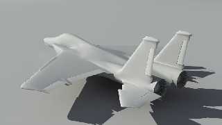

>Thank you, and yes, I did use radiosity (when it is untextured and the plane is
>white, it is hard to see exactly what is going on).  The mesh is fairly smooth,
>but there are a few bits that could use more smoothing.  I usually keep the mesh
>low density for ease of working, then do a smooth-on-export with recursion level
>1.  This means that the working one is about 2000 vertices, whereas a smoothed
>export one is closer to 8000.  I plan on making 3 or so resolutions - 2000 is
>more than enough for a high-speed moving spec, whereas a ground scene may
>require a fully smoothed model, which is closer to ~32000.
>Of course, after that, one needs a burning model, a crashing one, an exploding
>one, one crashed on the ground, one partially disassembled for maintenance...
Thanks for letting me know about the "smooth-on-export" feature of Wings.  That
alone may warrant me learning Wings modeling because I can think of quit a few
cases in which this would be useful (none relate to the jet unfortunately -
unless maybe the weapons).
