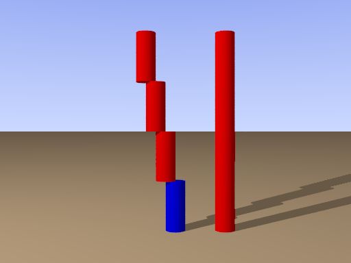

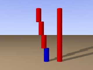

I've posted in the past about learning to create a tree macro all by myself.
 My trouble at this point is to figure out how to attach each block of truck
to each other when shifted out of alignment, a la not a perfectly straight
truck.
If you look at the attached image, you'll see I've got a cylinder broken
into four chunks, along with a solid cylinder next to it.  I want this to
be my trunk.  I'm looking to find out how to properly locate the beginning
and end points of each chunk.  That way, I could properly rotate each chunk
to meet up with the one below it.
Can anyone give me some help?  Thanks!
Download 'new_tree.jpg' (12 KB)
Preview of image 'new_tree.jpg'

If you know the coordinates of each point of the trunk, you don'tneed to
rotate cylinders.  Cylinders do not need to be created vertical. Just
specify the start and end coordinates and you are done.
-tgq

That's exactly my goal, but also the crux of my problem.  How am I going to
track the start and end coordinates?
.... This may become a rather moot point as I find it MUCH quicker to use
POV-Tree.  Nonetheless, I'm really curious about how to do it from scratch
for the learning potential.

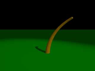

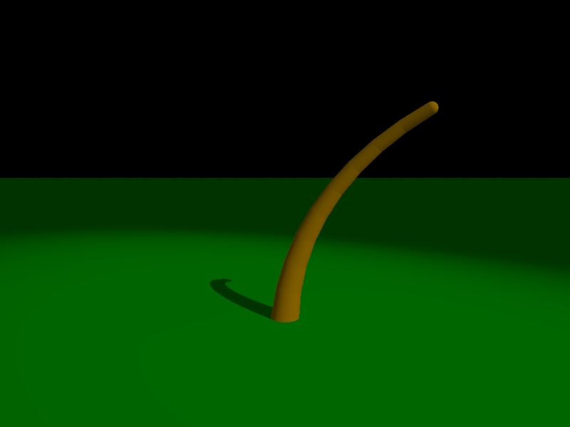

I tackled this same problem a few years back.  My solution was to use a
recursive call.
global_settings {
    assumed_gamma 1
light_source {
    <1000, 1000, 1000>
    color rgb 1
    spotlight
    point_at 0
    radius 1
    falloff 5
camera {
    location <120, 40, 0>
    look_at <0, 30, 0>
plane {
    y, 0
    pigment {
       rgb <0, 0.3, 0>
#macro bloblike (lrad, srad, length)
    union {
       sphere {
       	 0, lrad
       sphere {
       	 <0, length, 0>, srad
       cone {
       	 0, lrad
#end
#macro bloblike_run (number, cnt, lrad, length, bend, twist)
    #local srad = lrad * 0.9;
    #if (number = 1)
       object {
    #else
       union {
	 bloblike_run (number - 1, cnt, srad, length, bend, twist)
       	 object {
	 rotate <bend, twist, 0>
	 #if (number != cnt)
	    translate <0, length, 0>
	 #end
    #end
#end
object {
    bloblike_run (10, 10, 4, 8, 7, 6)
    pigment {
       rgb <0.4, 0.2, 0>
Download 'tree.jpg' (31 KB)
Preview of image 'tree.jpg'

> it look smooth).  You could could easily connect vertices as the tree
> trunk curves, shrinking the radius as the tree goes to the top.  I'm not
> entirely sure how to mesh the branch intersections smoothly though (I
> guess they could just overlap).  The path of your tree trunk and
> branches could be defined with a spline.  Then you'll have a nice
> curving shape to start with, and picking start and end points for your
> cylinders merely involves evaluating the spline at the spline intervals
> you need.
> Skip
You can use cones, maybe with spheres at the junctions.
If you use sphere_sweep, limit the lenght.
Using mesh is a prety good solution if you have several trees, like some 100's
or more.
Make 1 or 2 close trees with cones or many sphere_sweep. Then, you use 2 ot 3
different, scaled and randomly rotated mesh trees for the bulk of the forest.
