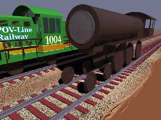

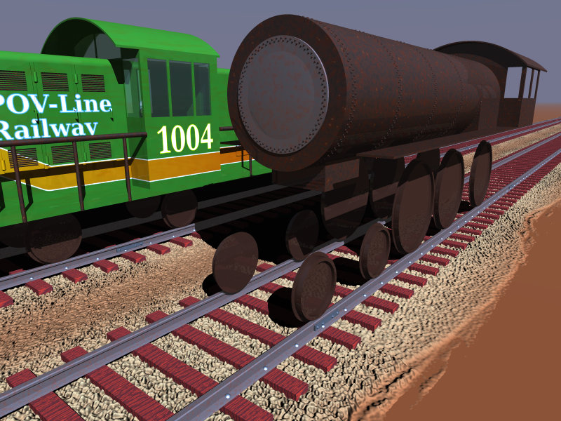

Well, after 3 days of work here's where I'm at. I'm progressing MUCH
faster than I'd expected. The diesel locomotive is perhaps 60% done,
lacking only the running gear and fuel tanks, plus some small details
(horn, etc) that I'm going to hold off on modeling until I have my final
scene layed out. Don't want to spend time modeling stuff that won't be
visable. I've started on the other locomotive, a circa 1920 Alco 4-6-0
type.
It's coming along nicely .. however there's a couple of things on the
ground that need attention:
Your ties (sleepers) are too slim .. cement ones are about that size,
but you need to make larger timber ones.
Also, as someone pointed out the other day, the pins don't go through
the rails. This is because the rails expand and contract based on the
weather. If they were nailed down as per your drawing, they'd end up
shearing the pins and/or getting deformed.
Thanks for sharing your progress!
Cheers!
Rick Measham

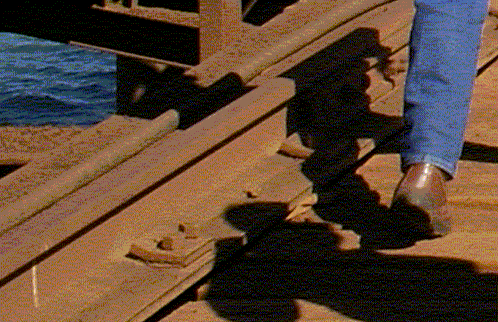

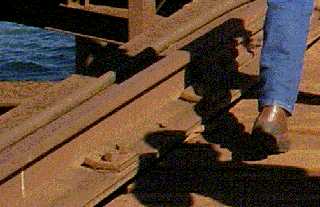

You're both right. Sometimes they _are_ pinned in, as per the attached
picture, but for this kind of track application, rails are normally clipped
in. See http://www.norfast.com/ or http://www.pandrol.com/ for some
excellent pictures of rail fasteners.
Joanne
(who spends a lot of time around railways but is not any kind of anorak...)
> picture
The picture shows them clipped in, it's hard to see because they're
clipped to an iron bridge, but the clips are plain to see .. I still
assert that the pins never go through the actual rails ..

From: Tyler Eaves
Subject: Re: Southbound (IRTC WIP)
Date: 8 Sep 2005 08:34:33
Message: <op.swsalwtd05glvk@localhost.localdomain>
On Thu, 08 Sep 2005 03:24:09 -0400, Rick Measham <rickm*at%isite.net.au>
wrote:
> Cheers!
> Rick Measham
Okay, I'll add pins to it. As for the ties, they're 9 inches wide by 7
thick, which according to some googling I did, is more or less typical.
Using Opera's revolutionary e-mail client: http://www.opera.com/mail/
From: Spock
Date: 8 Sep 2005 10:11:49
Message: <432046a5$1@news.povray.org>
The wood grain in the ties would run the other way...
From: Tyler Eaves
Date: 8 Sep 2005 10:20:16
Message: <op.swsfh3qe05glvk@localhost.localdomain>
>> 7  thick, which according to some googling I did, is more or less
>> typical.
Yea. That texture (like many others in the scene) is basically just a
place holder for now.
