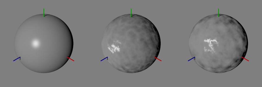

With this post I want to document a bias issue with the existing
wrinkles normal block pattern. In the attached image at left a sphere
with some phong shading. In the middle wrinkles with a bump_size of 0.5.
The two phong centers should more or less match(a), but do not. On the
right a hacked version of wrinkles removing the abs() of the DNoise
returned vector component values.  The phong position and shading has
spread some, but it's not offset(b).
(a) - Unbiased now too is the overall sphere's shading due the perturbed
normals.
(b) - The pigment_pattern { wrinkles } looks different, has at identical
scale and bump_size no noticeable bias - though the scalar value type
bias is there, and it looks correct for phong position and general shading.
The normal { wrinkles } perturbation's calc creates vector offsets which
only add to the existing normal vector values. Further, the amount of
the add/offset depends upon the bump_size value and whether
no_bump_scale is set or not.
When considered along with transformations it makes textures/materials
using normal { wrinkles } very difficult to control / set-up for general
use.

Download 'nrmlwrnklissue.jpg' (21 KB)
Preview of image 'nrmlwrnklissue.jpg'
