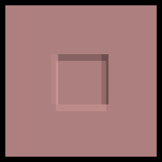

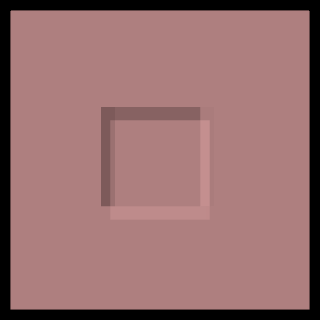

Normals appear to have an inherent directional bias independent of
pattern.  To eliminate as a variable any bias in a built-in pattern, I
used an explicit normal function.  The two images should be mirror
images of each other, but they are not.  The bias shows in all versions
from 3.5 to 3.8.
> pattern.
This is something I noticed and discussed some privately with Bald Eagle
while working on the quilted et al normal only patterns.
The method used for creating the normal from scalar function/pattern
values uses samples (4) and the sampling has a directional bias. This
bias does not necessarily exist with true normal perturbation. "Normal
perturbation based upon scalar value functions and patterns have a
directional bias."
A similar sampling method is used to create isosurface normals but there
- usually - the code runs at the surface intersection and due the local
"shape" values the simpler 3 delta sampling mostly works(1).
(1)- There are still possible issues. If the function/shape is set up
with a constant or near constant value range on one side or the
transition through the local 0 value root. Where the three axis
gradients are significantly different or all nearly the same is another.
If you run f_normal at a local change in value direction off the surface
- the sphere origin being an example - you tend to get the a form of the
sampling bias as the normal.
