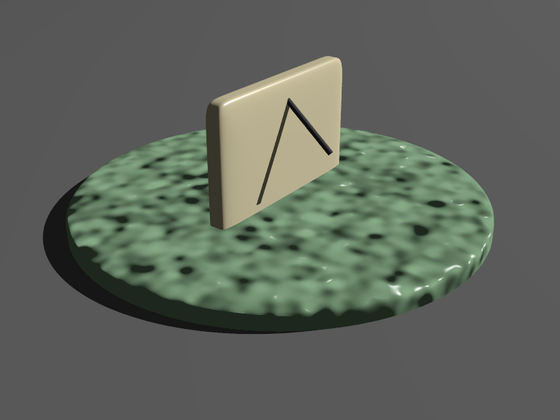

Hello,
Little brain teaser : the attached image is part of an animation that
simulates a simplified sundial. In order not to overload the image, the
shadow of the sundial has been removed with the "no_shadow" attribute.
But not for the gnomon to get the "time". As you can see, its shadow is
also projected on the ground "through" the wall.
So, how to remove this shadow on the floor but keep the shadow on the wall ?
Kurtz le pirate
Compagnie de la Banquise
Download 'cadransolaire109.jpg' (46 KB)
Preview of image 'cadransolaire109.jpg'

From: Kenneth
Subject: Re: Sundial and shadow problem
Date: 4 Jan 2021 11:00:01
Message: <web.5ff33ae5346ceddfd98418910@news.povray.org>
kurtz le pirate <kur### [at] gmailcom> wrote:
> Hello,
> Little brain teaser...
That is indeed an interesting situation.
After reading the various suggestions here, I experimented with different
set-ups, and finally found one that works. It uses two light sources: a
shadowless one in a light_group with the large horizonal disc, and another light
for everything else. The no_shadow flag is not needed in any of the objects.
plane{...}
// light_source A
light_source {...}
light_group{
// light_source B
light_source {  // same position as light_source A
  shadowless
// large horizontal disc
cylinder{...}
} // end of light_group
// sundial CSG
union{
box{...}
// gnomon
cylinder{...}

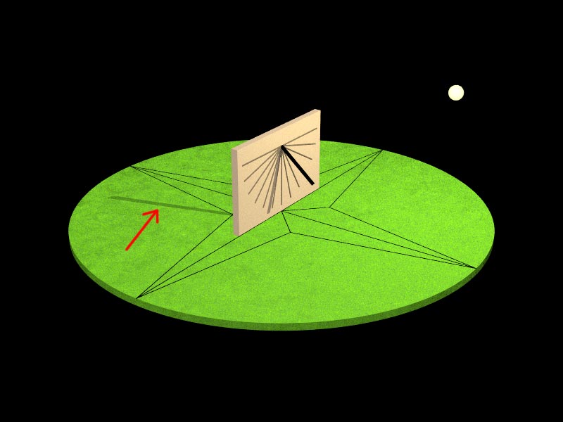

From: kurtz le pirate
Date: 7 Jan 2021 13:17:12
Message: <5ff75028$1@news.povray.org>
You can see the result with Kenneth's method here:
<http://louisbel.free.fr/wip/sundial.html>
Very close to Subclick
LOL
Kurtz le pirate

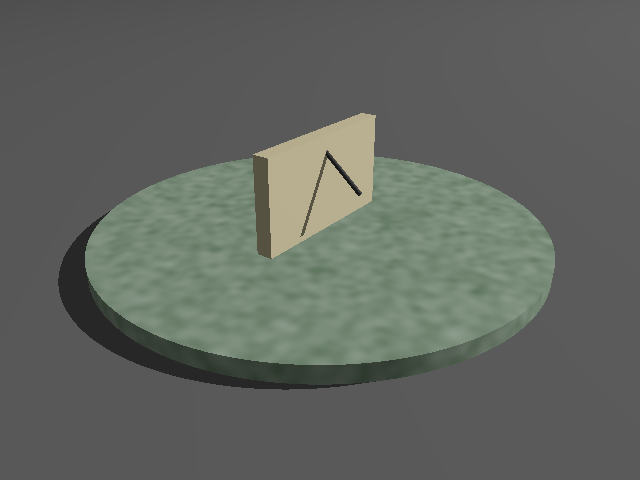

From: Kenneth
Date: 8 Jan 2021 11:55:00
Message: <web.5ff88e1a346ceddfd98418910@news.povray.org>
Subclick <no### [at] spam> wrote:
> "Kenneth" <kdw### [at] gmailcom> writes:
> > set-ups, and finally found one that works...
> I've tried that out, too.  With a shadowless light source, you don't
> get highlights.  You can remedy this by setting no_shadow for both
> the wall and the gnomon, and putting the former in a light group
> with a negative-intensity light source projected through the gnomon.
That is a really clever solution, and a good improvement. I didn't notice the
lack of highlights in my own test.
At first, I thought that the negative light_source would 'invert' the color of
the wall object; but that's not the case.
Here's my own demo code. (Note that the light_group requires global_lights ON).
#default{finish{ambient .04 diffuse .8}}
camera {
  perspective
  location  <-4, 2.5, -3>
  look_at   <0, 0,  0>
  right     x*image_width/image_height
  angle 40
// light_source A-- main
light_source {
  0*x                  // light's position (translated below)
  color rgb <1,1,1>    // light's color
  translate <20, 20, -20>
plane{y,0 pigment{rgb .2}}
superellipsoid{ <1,.2> rotate 90*x scale 1.5*<1,.1,1>
texture{
pigment{ rgb .5*<.6,1,.6>
       finish{phong .8}
       normal{bumps .7 scale .1 bump_size 1}
// --- sundial ---
#declare GNOMON =
cylinder{0,-.55*z,.02
pigment{rgb <.8,.2,.2>}
rotate -40*x
translate .9*y
no_shadow
object{GNOMON}
light_group{
// light_source B-- same position as light_source A
light_source {
  0*x
  color rgb -1 // NEGATIVE light
  projected_through{GNOMON}
// vertical wall
superellipsoid{<.1,.3> scale <.7,1,.08>
texture{
pigment{rgb <.95,.85,.55>}
finish{phong 1}
no_shadow
global_lights on
Download 'sundial_shadow_solution_2.png' (119 KB)
Preview of image 'sundial_shadow_solution_2.png'
