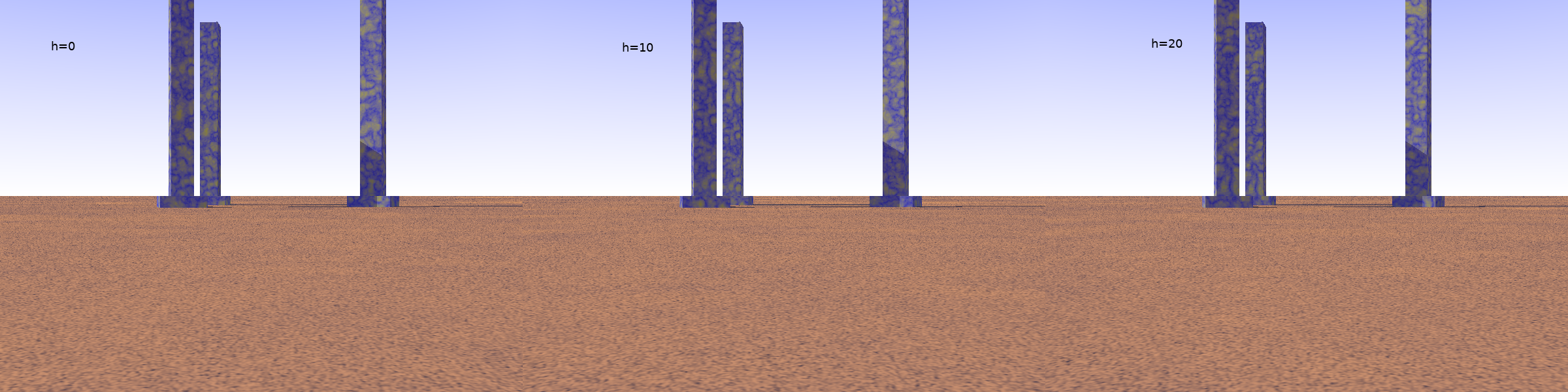

I need the help of a Matrix Master.
I am a regular user of Doctor John's FieldCam macro which enables
slanting architecture to look straight. It simulates the professional
cameras where this adjustment can be done through the lenses.
The macro works perfectly... as long as your scene camera is situated
about the origin of the Y-axis. Recently, I have been working on scenes
where the camera is situated at about y=170.00, and strange things
happen: the camera is moved upwards and forwards, the more so as
elevation gets greater.
To illustrate this, I have attached a little test scene and an image
showing the problem. H is the value for the elevation of the scene
elements along the Y-axis.
I can correct this by adding a translate after the "NoFall" transform in
the camera code, but I assume that this could better be done within the
"NoFall" matrix. I have not the slightest idea how to do this.
Thanks for any help.
Download 'dj_fieldcam_test.pov.txt' (7 KB) Download 'dj_fieldcam_testx.jpg' (66 KB)
Preview of image 'dj_fieldcam_testx.jpg'

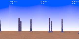

Hi Thomas,
I have never used Doctor John's macro but a quick look at it make me think it is
not supposed to work if the Y coordinates of you camera location and look_at do
not have the same value.
Changing your script as follow:
#case (2)
  #declare CamHeight    = 1;
  #declare CamLoc       = <2000.0, H+CamHeight, -2400.0>;
  #declare CamLookAt    = <2000-100, H+CamHeight, -2400+100>;
#end
and testing with the same H values as you example and FC on gives me correct
images (as far as I understand), cf attachment.
I also don't know if you really need to have a look_at at a different height...
I hope this will help you.

Download 'test.png' (1255 KB)
Preview of image 'test.png'
From: BayashiPascal
Subject: Re: Doctor John - FieldCam conundrum
Date: 16 Nov 2020 08:50:07
Message: <web.5fb28346ed460f77108b22750@news.povray.org>
Sorry, after sending my previous message and looking at yours again I think I
have misunderstood what this macro does.
Sorry for the useless post...

From: Bald Eagle
Date: 16 Nov 2020 17:15:01
Message: <web.5fb2f942ed460f771f9dae300@news.povray.org>
I think it's actually accomplished using the adjustable film plane of the view
camera.
The 3-book series on negative, print, and camera by Ansel Adams ought to
describe it fully and clearly.
<hint> One might think there are PDF's of those available...   ;) </hint>
Is this a custom version that you edited yourself, or a later version of the
original?
All I found was this:
http://news.povray.org/povray.text.scene-files/thread/%3Cweb.3e0c736a1f1273cdb29393de0%40news.povray.org%3E/
I'm puzzled by this:
#local VCorr = pow(vlength(CD), 2)/pow(HypoXZ, 2);
and its use in the matrix.  Seems to be some long-winded way to compute y^2 or a
multiple of it....
Maybe try
#local VCorr = CP.y;       ?    Totally guessing.
I don't really understand what I'm looking at in the scene, nor how the macro
corrects the one column and not the others...
shear matrix:
http://www.f-lohmueller.de/pov_tut/trans/trans_450e.htm
The matrix just ... "corrects" the basis vectors of the world space that the
camera uses.
If you look at the thread that jr references:
http://news.povray.org/povray.binaries.misc/thread/%3Cweb.5c226659252b677e48892b50%40news.povray.org%3E/
we explain that the POV-Ray matrix keyword uses a proper 3x3 mathematical matrix
with an additional 1x3 translation matrix "bolted on"to the bottom.
So for
ABC
DEF
GHI
you have row-wise definitions of the basis vectors i, j, k (x, y, z) of the
world space.
So
ABC = <1, 0, 0> = x
DEF = <0, 1, 0> = y
GHI = <0, 0, 1> = z
and then you tack on a translate <x, y, z> to the bottom of that.
So, quick and dirty answer, to address moving your correctional translation to
the matrix would be (I think)
matrix <1, 0, 0, 0, 1, 0, 0, 0, 1, 0, -CP.y, 0>
Doctor John has some mathematical hocus pocus going in with his squared terms,
and what assumptions he makes and why is currently beyond my ken, but perhaps at
some point when I return to having the time and energy to muck around with
POV-Ray stuff, I will puzzle it out.
I'm not sure what the Vcorr does, but I guess it is doing it... wrong?
That's all I've got - for now.
-Bill
> original?
This is a custom version 2.0 (2005). I only added the #debug lines to
understand what kind of info was generated.
> multiple of it....
> Maybe try
I also was puzzled by VCorr, not understanding what it really does.
I shall try your guess later today.
 From left to right:
1 - a scene not using FC, camera pointing upwards, base level at y=0.0
2 - same scene using FC. The pillars are now straight as far as the
observer is concerned. Base level still at y=0.0
3 - same scene, again using FC, but now with a base level of y=10.0
4 - idem, base level is y=20.0
Look again: all three pillars are corrected!
> shear matrix:
> camera uses.
> So for
> ABC
> DEF
> GHI
> world space.
> So
> ABC = <1, 0, 0> = x
> DEF = <0, 1, 0> = y
> GHI = <0, 0, 1> = z
