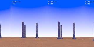

I need the help of a Matrix Master.
I am a regular user of Doctor John's FieldCam macro which enables
slanting architecture to look straight. It simulates the professional
cameras where this adjustment can be done through the lenses.
The macro works perfectly... as long as your scene camera is situated
about the origin of the Y-axis. Recently, I have been working on scenes
where the camera is situated at about y=170.00, and strange things
happen: the camera is moved upwards and forwards, the more so as
elevation gets greater.
To illustrate this, I have attached a little test scene and an image
showing the problem. H is the value for the elevation of the scene
elements along the Y-axis.
I can correct this by adding a translate after the "NoFall" transform in
the camera code, but I assume that this could better be done within the
"NoFall" matrix. I have not the slightest idea how to do this.
Thanks for any help.
Download 'dj_fieldcam_test.pov.txt' (7 KB) Download 'dj_fieldcam_testx.jpg' (66 KB)
Preview of image 'dj_fieldcam_testx.jpg'

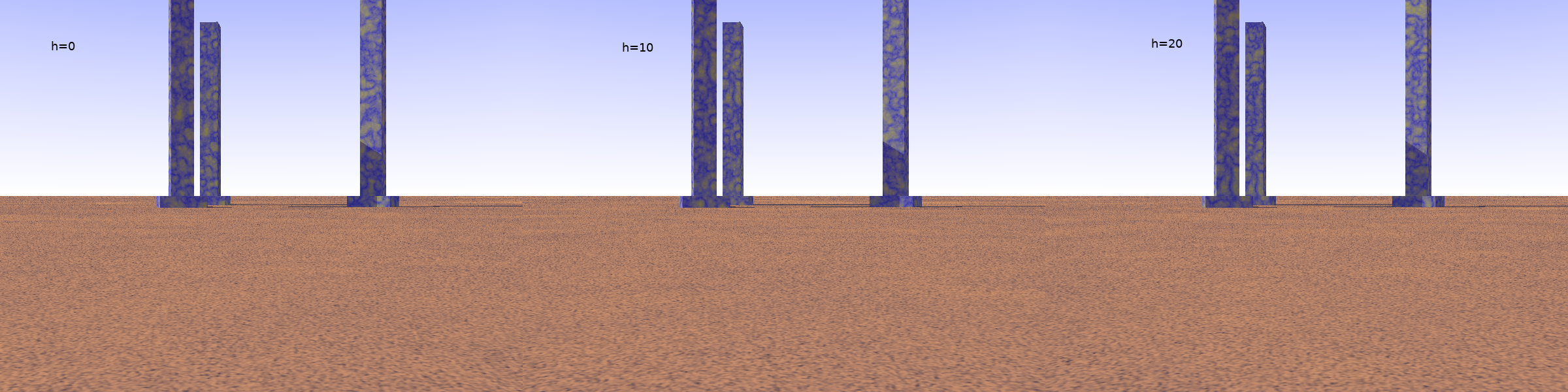

Changing your script as follow:
#case (2)
  #declare CamHeight    = 1;
  #declare CamLoc       = <2000.0, H+CamHeight, -2400.0>;
  #declare CamLookAt    = <2000-100, H+CamHeight, -2400+100>;
#end
and testing with the same H values as you example and FC on gives me correct
images (as far as I understand), cf attachment.
I also don't know if you really need to have a look_at at a different height...
I hope this will help you.
> Thomas
Download 'test.png' (1255 KB)
Preview of image 'test.png'
From: BayashiPascal
Subject: Re: Doctor John - FieldCam conundrum
Date: 16 Nov 2020 08:50:07
Message: <web.5fb28346ed460f77108b22750@news.povray.org>
Sorry, after sending my previous message and looking at yours again I think I
have misunderstood what this macro does.
Sorry for the useless post...

This is a custom version 2.0 (2005). I only added the #debug lines to
understand what kind of info was generated.
> I'm puzzled by this:
> #local VCorr = pow(vlength(CD), 2)/pow(HypoXZ, 2);
> and its use in the matrix.  Seems to be some long-winded way to compute y^2 or a
> multiple of it....
> Maybe try
> #local VCorr = CP.y;       ?    Totally guessing.
I also was puzzled by VCorr, not understanding what it really does.
I shall try your guess later today.
> I don't really understand what I'm looking at in the scene, nor how the macro
> corrects the one column and not the others...
 From left to right:
1 - a scene not using FC, camera pointing upwards, base level at y=0.0
2 - same scene using FC. The pillars are now straight as far as the
observer is concerned. Base level still at y=0.0
3 - same scene, again using FC, but now with a base level of y=10.0
4 - idem, base level is y=20.0
Look again: all three pillars are corrected!
