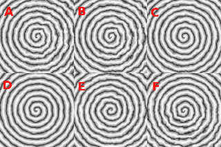

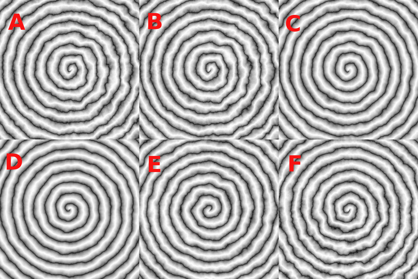

Attached is an image showing size renders labeled A thru F all showing
spiral1 examples.
(A) v3.8 current tangled turbulences.
     spiral1 1
     turbulence (1/3)*0.5
(B) A version of povr with only the Turbulence() omega distribution
drift fix, but otherwise still tangled turbulences.
     spiral1 1
(C) v3.8 again, but where we turn off both the internal value turbulence
and the spatial x turbulence by coding the full vector with x at 0:
     spiral1 1
     turbulence <0,(1/3)*0.5,(1/3)*0.5>
(D) A current povr render with the it_, internal turbulence, keywords.
Here with it_frequency we get only the pattern's value turbulence.
     spiral1 1
     it_frequency (1/3)*0.5
(E) A current povr render with the it_, internal turbulence, keywords.
Specifying and getting only spacial turbulence.
     spiral1 1
(F) A current povr render with the it_, internal turbulence, keywords.
Specifying and getting both the internal value and spacial turbulence.
     spiral1 1

From: Bald Eagle
Subject: Re: Documenting special turbulence handling tangle.
Date: 24 Sep 2020 06:30:00
Message: <web.5f6c7526eb757e1a1f9dae300@news.povray.org>
And so you continue to peel away the layers of the onion...
Any reason E spirals in the reverse direction than all the others?
From: William F Pokorny
Date: 24 Sep 2020 07:50:10
Message: <5f6c87f2$1@news.povray.org>
:-) I completely missed that!
When I reworked the two spiral patterns for povr, I changed the
orientation (starting position) to match other patterns like radial (
atan2(y,x) ) - except not using atan2.
To match the v3.8 results I inserted a transformation and I missed a '-'
(or accidentally deleted it) on that render.
I'll mention one more detail too, because it's really a bug. Sometime
after v3.7, during one of the pattern and parsing refinements, the code
for function spiral pattern parsing was incorrectly updated. The code,
currently in parser_materials.cpp, reads:
CASE (SPIRAL1_TOKEN)
     New->Type = GENERIC_PATTERN;
     New->pattern = ParseSpiralPattern<Spiral2Pattern>();
END_CASE
CASE (SPIRAL2_TOKEN)
END_CASE
That first ParseSpiralPattern template parameter should be Spiral1Pattern.
In recent v3.8s it means pattern use is OK, but function { pattern {} }
use always uses spiral2.
Bill P.
