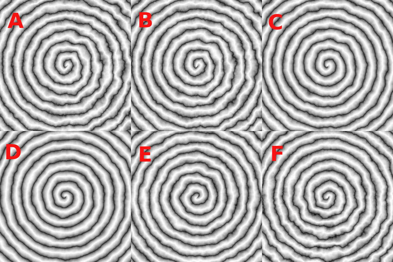

I've been working on povr's it_ prefixed, internal turbulence, keywords
implementation for patterns which have special turbulence handling.
Those patterns are: agate, marble, spiral1, spiral2 and wood.
I've come to understand the pattern's internal turbulence cannot be run
apart from also running classic turbulence excepting for agate, which
has the agate_turb keyword. Even with agate, if you make the mistake of
specifying an actual turbulence vector value you'll see both internal
value turbulence and regular spacial turbulence. Supposing you leave the
turbulence vector at the default 0.0 by using only agate_turb, octaves,
omega and lambda - the null spacial turbulence is still getting calculated!
While news to me, I do not believe this is news to the v3.7 developers.
There is in "struct ClassicTurbulence" a carefully set, but unused,
handledByPattern boolean which was likely intended to skip the classic
turbulence in the special turbulence patterns when running through the
warp{} list. I checked v3.6 code and the value/spatial turbulence is
tangled there too. I think the developers matched previous behavior.
In all but agate, the reason for the coupled value/spatial turbulence is
the turbulence vector's value is being borrowed for what should be an
independent agate_turb like keyword in all the patterns. For example,
spiral2's pattern code has:
Turb = GetTurb(warps);
turb_val = Turb->Turbulence[X]*Turbulence(EPoint,Turb,GetNoiseGen(pThread));
Aside: Yes, the EPoint as used in Turbulence could be better decoupled
too.  As in providing an it_scale / it_offset vector options for
starters, but perhaps such things are better left to the inbuilt
functions. Not decided. I am leaning to enabling the it_scale keyword
for special/value turbulence patterns, but we'll see.
Even if you carefully code say:
spiral1 1 turbulence <0.03,0,0>
to avoid y and z spatial turbulence, you get the x turbulence value as
regular turbulence on top of the internal spiral1 pattern value turbulence.
There's more detail, but, perhaps another day.
Attached is an image showing size renders labeled A thru F all showing
spiral1 examples.
(A) v3.8 current tangled turbulences.
     spiral1 1
     turbulence (1/3)*0.5
(B) A version of povr with only the Turbulence() omega distribution
drift fix, but otherwise still tangled turbulences.
     spiral1 1
(C) v3.8 again, but where we turn off both the internal value turbulence
and the spatial x turbulence by coding the full vector with x at 0:
     spiral1 1
     turbulence <0,(1/3)*0.5,(1/3)*0.5>
(D) A current povr render with the it_, internal turbulence, keywords.
Here with it_frequency we get only the pattern's value turbulence.
     spiral1 1
     it_frequency (1/3)*0.5
(E) A current povr render with the it_, internal turbulence, keywords.
Specifying and getting only spacial turbulence.
     spiral1 1
(F) A current povr render with the it_, internal turbulence, keywords.
Specifying and getting both the internal value and spacial turbulence.
     spiral1 1
Aside: Originally I was going to get rid of classic turbulence in povr,
but, as mentioned recently elsewhere, it allows updates on inheriting
from an existing pattern, so now thinking I'll keep it. Making, in the
special turbulence cases this sort of turbulence/warp order:
it_ <-- classic turbulence <-- warp { turbulence, et al }
Aside: In povr I moved the wood pattern's use of DTurbulence() to
Turbulence() so it uses the pattern specific noise generator if one is
specified. The wood pattern was somewhat unique in always using noise
generator 2 due the DTurbulence() use.
Aside: Due the omega distribution drift in Turbulence() I expect at
times, with these special turbulence patterns, folks were mostly getting
the spatial turbulence.
FWIW.
Bill P.
Download 'storyspcturb.jpg' (272 KB)
Preview of image 'storyspcturb.jpg'

And so you continue to peel away the layers of the onion...
Any reason E spirals in the reverse direction than all the others?
:-) I completely missed that!
When I reworked the two spiral patterns for povr, I changed the
orientation (starting position) to match other patterns like radial (
atan2(y,x) ) - except not using atan2.
To match the v3.8 results I inserted a transformation and I missed a '-'
(or accidentally deleted it) on that render.
I'll mention one more detail too, because it's really a bug. Sometime
after v3.7, during one of the pattern and parsing refinements, the code
for function spiral pattern parsing was incorrectly updated. The code,
currently in parser_materials.cpp, reads:
CASE (SPIRAL1_TOKEN)
     New->Type = GENERIC_PATTERN;
     New->pattern = ParseSpiralPattern<Spiral2Pattern>();
END_CASE
CASE (SPIRAL2_TOKEN)
END_CASE
That first ParseSpiralPattern template parameter should be Spiral1Pattern.
In recent v3.8s it means pattern use is OK, but function { pattern {} }
use always uses spiral2.
Bill P.
