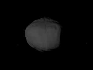

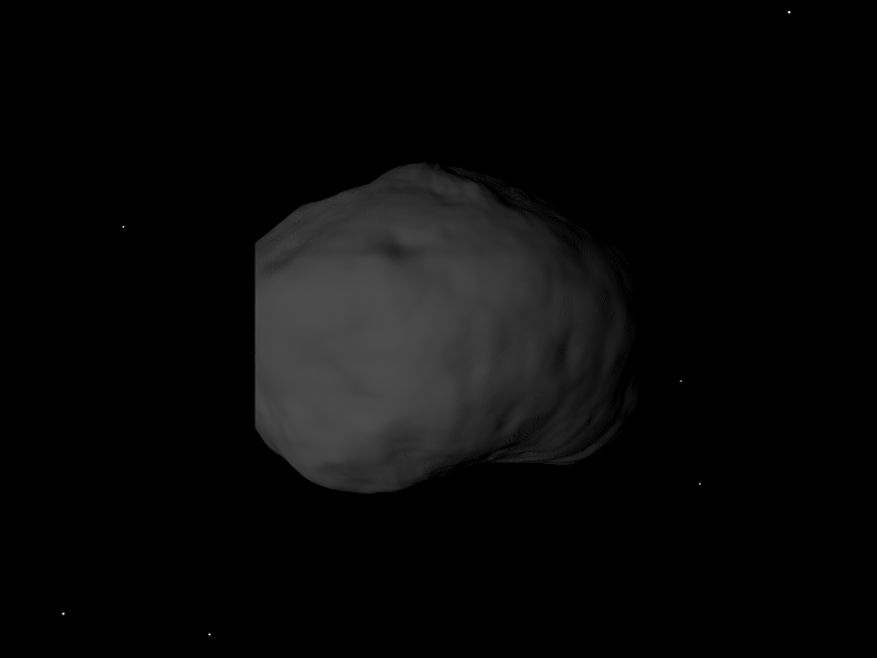

Meanwhile, I improved the 8bit grayscale "heightfields" of Deimos and
Phobos by using HLA to convert them into POV-Ray 16bit images and
blurred them slightly to get rid of the "greebled" look... then I
rendered both moons again and noticed portions being vertically cut off
(see attachments)! It can hardly be a matter of not enough RAM, as I
just recently installed another 1 GB, so that I now have 1536 MB (and
according to POV-Ray, the maximum memory used is about 650 MB)...
See you in Khyberspace!
Yadgar

From the 'straight line' appearance of the cutoff, it looks so much like a
bounding-box problem; but your asteroid code has no explicit bounding box, so
that's a mystery. Have you tried rotating the asteroid to see if that straight
line is actually a flat 'plane' (or else a big hole?) The other possibility
that comes to mind is this: Since you reworked the image map, could the problem
again be related to the needed fix that Clipka mentioned in your previous post?
Is eval() 'seeing' the entire image map?
KW

Where is the moon, and how big is it, in POV-Ray co-ordinates?
like a
box, so
 > that's a mystery.
Perhaps I should look up the manual sections on bounding...
 > line is actually a flat 'plane' (or else a big hole?).
Yes, I have... it seems to be a hole rather than a plane!
the problem
previous post?
No, I did not touch the code since!
Yes, it does, as the image_map extends from <0, 0, 0> to <1, 1, 0>,
eval_pigment() goes from
<(0.5+0)*(1/800), (0.5+0)*(1/400), 0> to <(0.5+799)*(1/800),
(0.5+399)*(1/400), 0>!
Yadgar

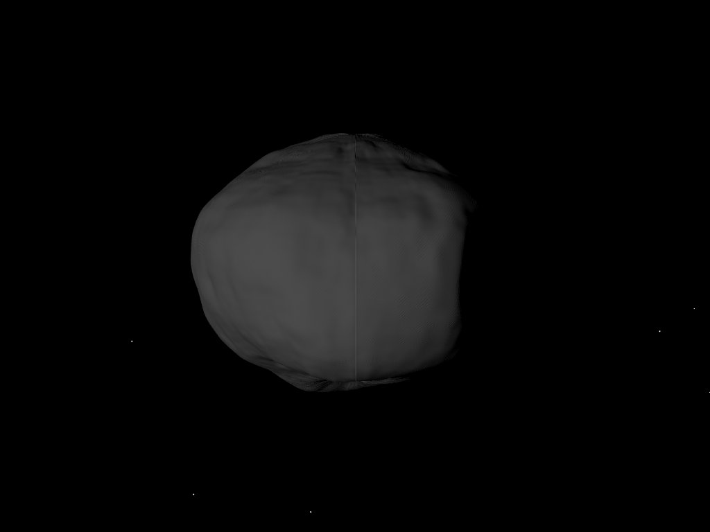

From: Jörg 'Yadgar' Bleimann
Subject: Re: mesh2 asteroids: strange clippings
Date: 20 Apr 2009 15:29:52
Message: <49eccd30@news.povray.org>
High!
clipka wrote:
> What you really need to do is turn off bounding boxes altogehter.
That was pretty easy, just -MB in the command line... here we go!
Yadgar
