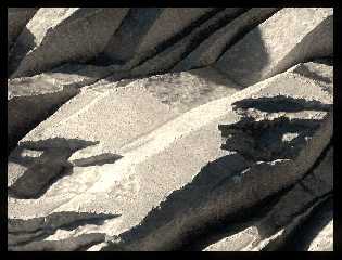

Hi again!
My goal was to increase the realism of height_field rocks by separately
texturing the edges, the sides, and the inside edges of the formation.
To meet this goal I employed an edge-finding pigment to determine the
outside and inside edges of the rocks, and then used it as a patterned
texture_map. To save time on the final render, I used Rune's illusion
include library to project the edge data onto the rocks at render time.
The scene was rendered with low radiosity settings. Slight noise and a
black border were added with the Gimp. I gave it a final pass with a
POV-based, luminous color bleeding effect.
I still have farther to take this technique. Is it looking promising so
far? Questions, comments, appreciated as always~
~Sam
Download 'rocks.jpg' (147 KB)
Preview of image 'rocks.jpg'

I am not sure I understand the whole procedure, but the result is
simply amazing !

Yes, this looks very good indeed!
Looks like an isosurface in fact. Not sure I really understand the
technique, though. Do you plan to provide us with a little tutorial when you
are done? That would be very much appreciated indeed.

I agree with Thomas - looks wonderful, but er, run that past me again? :)
Rock is so hard to get right. The only satisfactory solution I have found
is isosurfaces, which carry their own problems. I like the lack of scale
here - these could easily be either the size of steps, or vast towering
slabs. Keep it up!

Wonderful! Looks exactly like some broken concrete blocks I saw in a parking
area a while ago.
How about doing a tut on the procedure to make them...? (Hint hint!)

Thanks! I can still take it farther, to produce something more
realistic. Better radiosity would help, but I'm not patient enough for
anything over 2 hours, at the moment.
~Sam

I could make a tutorial, yes. It would be an honor for people to use it!
~Sam

Thanks. I'll just have to make a tutorial. It would be easer to explain
the process visually (I'm a visual learner myself).
Isosurfaces. Yeah. Two major reasons I don't use them for this kind of
thing: long render times, floating rocks. When I get a new computer, I
might be inclined to go back to them.
> slabs. Keep it up!
I will! thanks!

I called it rhyolite (volcanic ash/cement) after I rendered it.... it
can be anything, really :)
I think I will.
> VERRY nice.
Thanks!
