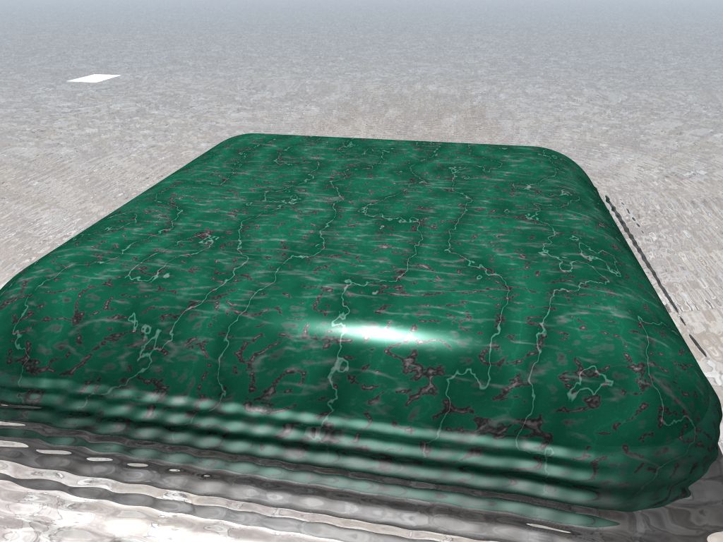

Yes, *this* is the image that took 9 hours and 45 minutes to render. Not
the other one I posted (which took a long old while, but less than 1 hour).
Why did it take so long? The answer is the water; it's an isosurface. It
has a max_gradient of 1.07, but the function that describes it is
extremely complicated and thus takes one hell of a long time to
evaluate. What *is* this function, exactly?
Well, it's 160 splash functions added together. (!)
Each "splash function" is actually just some concentric rings of sine
waves, decaying exponentially as you move away from the center. Each of
the 160 splash functions has a different center point; the center points
trace the outline of the stone block. In this way, the waves appear to
follow the outline of the stone block, the way *real* water would move.
Of course, this only works if you have enough splashes; otherwise you
just get more or less random-looking interference patterns. (It appears
the number of splashes on each edge must be approximately the same as
the frequency of the waves - which would make sense I guess! Thus, the
smaller the ripples are, the more functions you must have.)
Go on, admit it... it *does* look kinda cool. ;-)

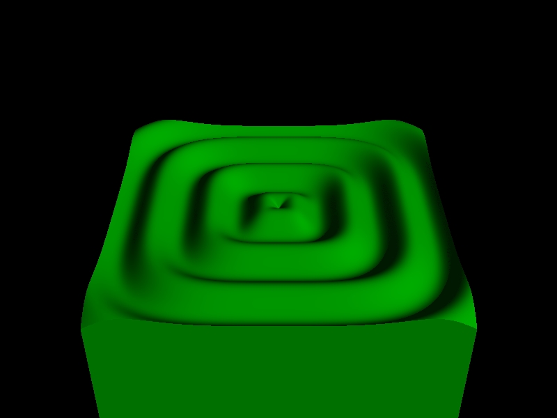

How about this:
y-10*sin(10*pow(pow(x,4)+pow(z,4),1/4)-1)/(pow(abs(x)+1,4)+pow(abs(z)+1,4))
(designed for a box{-8,8})
The middle gets a bit screwed up but you can chop that bit out for your box
to go in.
Download 'iso.jpg' (20 KB)
Preview of image 'iso.jpg'

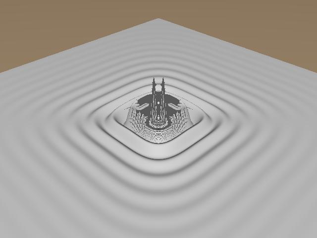

	Actually, it does if you close the parenthesis I forgot (just
before the "-y"). See attached image...
		Jerome
+------------------------- Jerome M. BERGER ---------------------+
|    mailto:jeb### [at] freefr      | ICQ:    238062172            |
|    http://jeberger.free.fr/     | Jabber: jeb### [at] jabberfr   |
Download 'waves.jpg' (65 KB)
Preview of image 'waves.jpg'

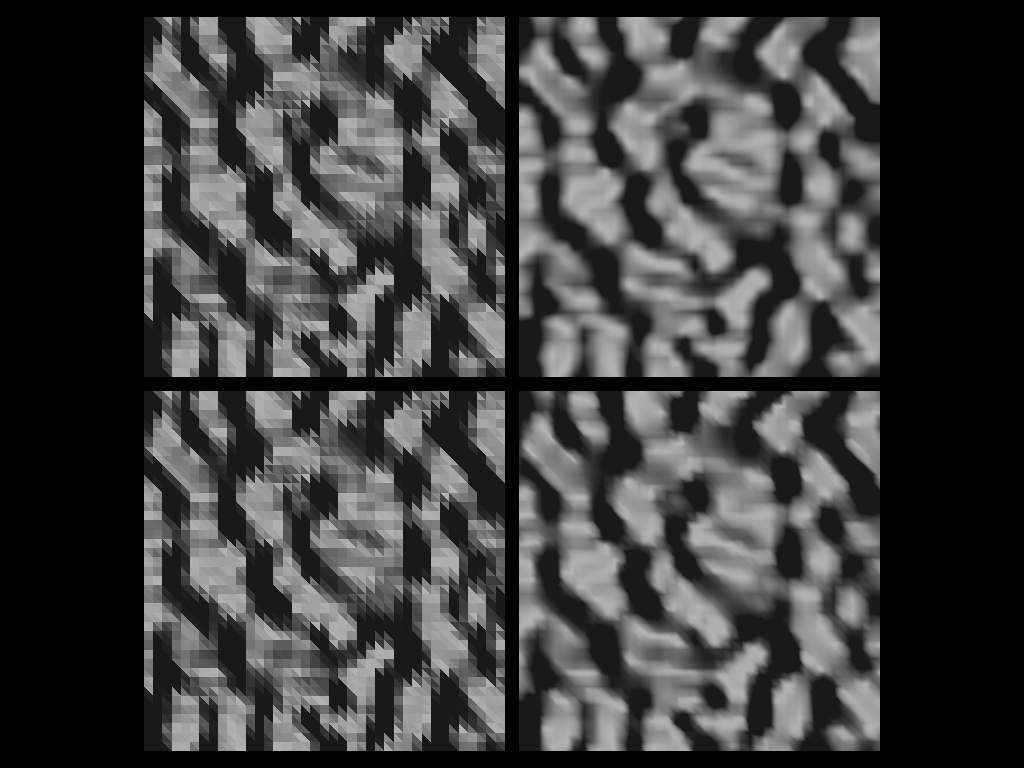

  Note, however, that there's evidence that heightfields don't always
render correctly (perhaps precisely because of bugs in this optimized
code). "Smooth" heightfields are not always so "smooth", even though
equivalent smooth meshes are.
  Btw, another advantage of heightfields is that they, too, are
reference-counted when copied, in the same way as meshes.
From: Warp
Subject: Re: "The 10 hour render" (~130KB)
Date: 14 Oct 2006 16:59:35
Message: <45314fb7@news.povray.org>
  Actually this isn't necessarily true. Height_field uses a rather
different algorithm for calculating normal vectors than a mesh. In
some cases this produces *better* smoothing than an equivalent mesh
gives. However, in some cases it doesn't seem to work perfectly.
I just tested this.
  In the attached image the upper heightfields are made with the
height_field primitive, and the lower heighfields are meshes created
with the HF_Square macro.
  The non-smooth versions are obviously identical. The smooth versions
have a considerable difference, the height_field being better.
Download 'hftest.jpg' (64 KB)
Preview of image 'hftest.jpg'
