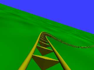

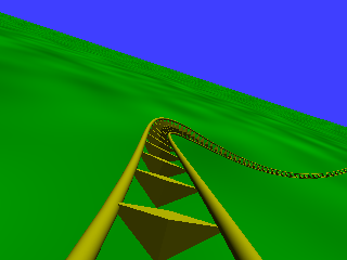

Compare these two frames from an animation of a roller coaster I'm
working on.  Notice that in the second frame, the track spine has
disappeared.
Throughout the animation, the track spine disappears randomly for 1-3
frames at a time.  What would cause this?
The spine is a sphere_sweep generated through SDL using bezier data.
Sphere_sweeps are generated by using some macros from transform.inc to
orient the components of the sphere_sweep to the current track heading
and banking.
I don't understand why it would disappear in some frames though,
considering that NONE of the SDL for the sphere_sweep looks at the clock
variable at all.  Its generated on every frame and should be the same on
every frame.
The only thing I can possibly think of is rounding errors.  But if that
was the case, then the other two rails should be messing up as well.  I
suppose I could post the code:
#declare xx = 0;
#while (xx < NUMBEZIERS -1 )
#declare yy = 0;
#while (yy < POINTSPERBEZIER)
GetBezier(bez[xx],c2[xx],c1[xx+1],bez[xx+1], yy/POINTSPERBEZIER, ret)
#declare point1 = ret;
GetBezier(bez[xx],c2[xx],c1[xx+1],bez[xx+1], yy/POINTSPERBEZIER + 0.001,
ret)
#declare point2 = ret;
#declare point3 = point2 - point1;
#declare il = int(xx);
#declare b = -((bank[xx+1] - bank[xx]) * (yy/POINTSPERBEZIER) + bank[xx]);
#declare raxis = vaxis_rotate(y,point3,b);
#declare bpsl[xx*POINTSPERBEZIER + yy] = VPerp_To_Plane(raxis,point3) *
0.5 + point1;
#declare bpsr[xx*POINTSPERBEZIER + yy] = VPerp_To_Plane(raxis,point3) *
-0.5 + point1;
#declare bpsc[xx*POINTSPERBEZIER + yy] = -0.2*raxis + point1;
#declare yy = yy + 1;
#end
#declare xx = xx + 1;
#end
sphere_sweep { linear_spline (NUMBEZIERS-1)*POINTSPERBEZIER - 1
#declare xx =0;
#while (xx < (NUMBEZIERS-1)*POINTSPERBEZIER -1 )
bpsl[xx], 0.0725
#declare xx=xx+1;
#end
pigment { color rgb x+y }
#declare xx =0;
bpsr[xx], 0.0725
#declare xx=xx+1;
#end
#declare xx =0;
bpsc[xx], 0.2023
#declare xx=xx+1;
#end
(END OF CODE)
bez, c1, and c2 are bezier data.  GetBezier is a macro for getting the
coordinates in space of a point on a bezier at T.  bpsl, bpsr, and bpsc
are of the course the generated sphere_sweep points for the left, right,
and center rails respectively.
Download 'bezier0186.png' (26 KB) Download 'bezier0185.png' (29 KB)
Preview of image 'bezier0186.png'
Preview of image 'bezier0185.png'

Try MegaPOV if you haven't already, I found that with the original POV I get
many bugs and sometimes parse errors when using splines and sphere sweeps.
MegaPOV seemed to fix it. Also I found replacing the sphere sweeps with
spheres connected by cylinders made render times much faster and without
much loss to quality (you should choose a good spacing for the spheres).
Just my 2 cents.

I installed MegaPOV and it works.  No more disappearing sphere_sweeps!
About the use of spheres and cylinders...In theory, shouldn't a
sphere_sweep using linear_sweep look exactly the same as spheres
connected by cylinders?  If so, why doesn't POV-Ray break it up like
that?  I'm finding that POV-Ray is shooting way more rays to test the
sphere_sweep than is probably necessary...only 1-2% of the rays tested
result in a success.  That certainly can't be efficient.
