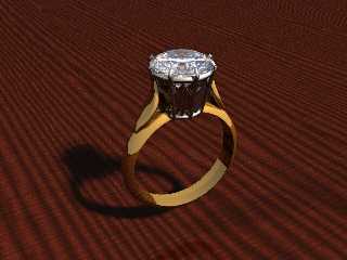

From: St
Subject: HOT HOVERIN' ROCK! ;)
Date: 15 Mar 2003 18:03:17
Message: <3e73b135@news.povray.org>

      Yes, tried that last night, and you were right, the bright spots
disappeared, but the diamonds looked more like Blue Topaz than
diamonds, but REALLY GOOD Blue Topaz!! (Because of my blue sky_sphere)
   (Note to self: must remember this!)
> Thanks for the heads-up on gemcad - sounds useful.  Very useful in
fact!
   My pleasure, "Anything to help anyone" would be my motto of choice.
   So, what do you reckon to the attached now?
   With this image, I stayed with IOR 2.41 in the end.
      ~Steve~

From: Andrew
Subject: Re: HOT HOVERIN' ROCK! ;)
Date: 16 Mar 2003 07:47:55
Message: <3e74727b@news.povray.org>
Now that's looking pretty good!  I'm going to have to try some gemstones
out myself...

    Thanks! I'm not too happy with those blotches next to the sharp
edges (at the bottom), of the shank though. I'm not sure if it's a
sPatch thing or a texture thing at the moment...
   I'm going to try a ring with either eight or ten diamonds next,
surrounding an oval sapphire, or perhaps an emerald. I'll see if I can
put it in a pseudo velvet-lined ringbox too. That should be fun!  ;)
 Yes, give it a go, there's a sort of nice feeling being able to
produce a diamond that's FREE!
     (...and you can make it as big as you want!)    :)
