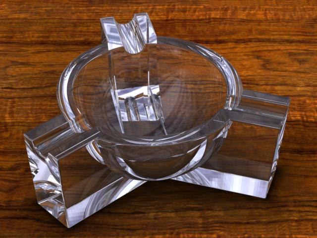

Hi all,
the images made with HDRI have a really amazing lighting.
And as far as I can see there is not so much effort in
setting the scene lights.
So I tried to make a similiar thing. It's a sphere with
a mapped picture for lighting, traced with radiosity of
course.
When I see the result I think there is not much difference
compared to the HDRI method.
So my question:
What is the advantage of HDRI?
Maybe I'm blind...
-C-H-A-R-L-E-S-
Download 'tray.jpg' (52 KB)
Preview of image 'tray.jpg'

Your image is a bit dark. When I look in the glass, I would expect the sky
to be brighter and the road darker (if it's a road) and the table more lit.
This is what HDRI is for. On the other hand I agree, this HDRI thing is a
bit overrated. Some says it's the holy grale! But higher contrasts in
image_maps, used as faked enviroment, is more realistic. With radiosity, I'm
fairly confident it gives a better result than a mere 24-bit image, because
radiosity calculations react to light intensities above 1 (a white rgb)...
But with reflections, the docs says "POV-Ray uses a limited light model that
cannot distinguish between objects which are simply brightly colored and
objects which are extremely bright" therefore we have the
reflection_exponent keyword... So that shouldn't work in favor of HDR, but
I'm not fully certain about it.
Btw, you haven't used interpolation of your image_map, have you?
Hugo

thanks for the clarification.
It's intended like it is.
Right, it was a quick and dirty test.
And the size of the image is very small.
-C-H-A-R-L-E-S-

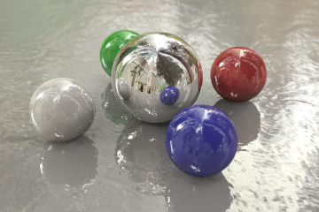

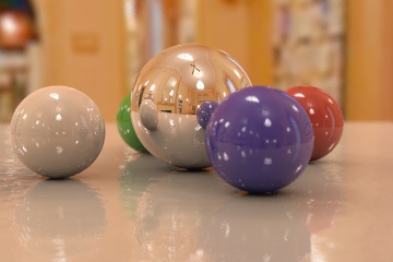

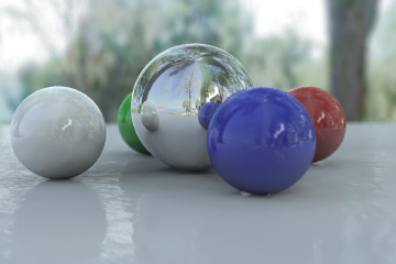

  Because, appart from being almost necessary to create "augmented
reality", it is a very cheap way to fake a complete environment for
close-up shots, including the lighting, with maximum realism.
  Indeed, I've made some more tests with "faked HDRI", this time with
a 255 layers texture. The first layer is the simple image_map with
ambient, and the other 254 are done with a grayscale version of the
same image, using exponential transmit. Not bad results, and very
quick to render (well, not much more slow than a single layer
texture).
Jaime Vives Piqueres
http://www.ignorancia.org

Wow, what did you use as the texture for that table? Or is it image mapped?
Mike

   Is it me, or is that table repeated three times in some places??
   Whatever, nice image though.
