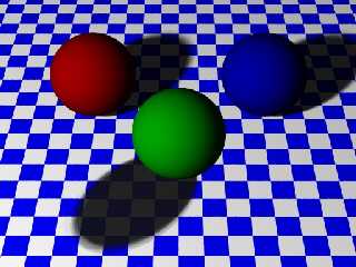

I was experimenting and came up with this. Anyone care to guess how it was done?
Since there are a number of ways it _could_ have been done I will say it has
nothing to do with light groups.
Batronyx ^"^
Ummm...
Green sphere floating well over the plane, and an extra light and sphere casting a
shadow for it.
Jon A. Cruz

"Jon A. Cruz" <jon### [at] geocitiescom> wrote in message
news:3BD262DD.21F67C38@geocities.com...
done?
> Ummm...
casting a
> shadow for it.
No. There are only three spheres. Besides I think the extra sphere would cast a
shadow on the green one would it not?
It's pretty obvious that it's not done with light_groups because then
the green sphere would have been lit from the opposite side from its
shadow.
I reckon the green sphere is no_shadow, and there's a no_image sphere in
the scene casting the extra shadow from the other end.
(The object casting the extra shadow doesn't appear to be off screen
because then the width of the penumbra would have been wider because the
extra object would be closer to the area_light.)
Hmmm... As a not-quite-so-advanced pover, I would assume that you used no_shadow
for the green sphere and then overlaid a single properly sized semi-transparent
dark leopard spot with fuzzy edges, rotated around the y and x (or z ) axis, on the
plane texture!

"Yadgar" <yad### [at] koh-e-qaisar-observatoryaf> wrote in message
news:3BD2E835.46DF8D90@koh-e-qaisar-observatory.af...
done?
no_shadow
semi-transparent
on the
> plane texture!

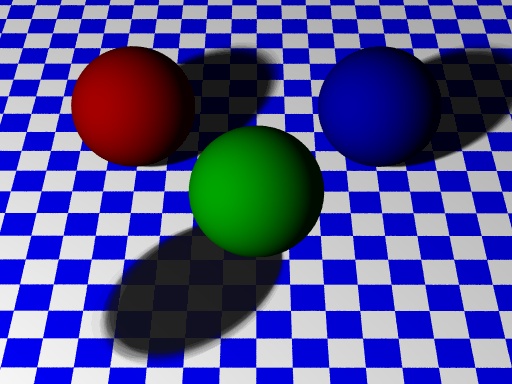

So far you are the most correct; no_shadow on the sphere, and the backwards
shadow is indeed a texture layered on the plane. However, it isn't leopard, it
is an object pattern texture (from the sphere in fact), blurred according to Ron
Parker's post earlier, "The final word on blurred reflections" which works just
a well on pigments.
news://news.povray.org/povray.binaries.images:54969
I thought this might be a good way for someone to fake soft shadows in Rune's
fast grass macro. It would take more work than I've put in here, but it does
offer possibilities.

On Sun, 21 Oct 2001 00:39:27 -0500, "Batronyx"
no_shadow on the green sphere and a strong negative-colored spotlight?
