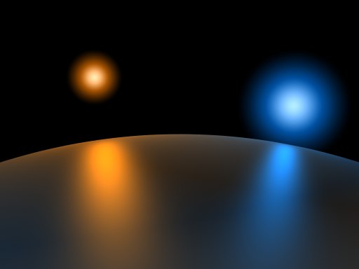

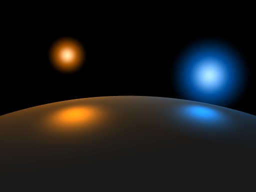

When testing my glow macro I found another shadow line problem caused by
the lighting model used in POV-Ray. This image illustrates the artifact:
Download 'shadowline1.jpg' (10 KB) Download 'shadowline2.jpg' (10 KB)
Preview of image 'shadowline1.jpg'
Preview of image 'shadowline2.jpg'

I got such odd results with specular highlights, but I always managed to fix
them using phong instead of specular. Dunno if it works here...
Jonathan

I believe this is caused by the fact that specular highlights are an
approximation to the real life effect. They don't exist in reality, so there's
no "right" way to do it. Phong gives a better approximation, but I'm pretty sure
I've had a similar (but less severe) effect with phong.
BTW, the real world effect is caused by imperfect reflections.

Could you try to replace the light_sources with some spheres with high
ambient and make the surface with the highlights be reflective, and then
compare the results? Highlights should always be visible in the same places
as reflections. If they are not then it is indeed a bug.

You'd need blurred reflections to acheive the equivalent effect. But Rune's
right, you should try that.
Tek

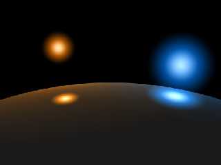

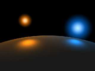

This is what I get if I apply finish { phong 1 } to the sphere:
Download 'shadowline_phong.jpg' (9 KB) Download 'shadowline_reflection.jpg' (9 KB)
Preview of image 'shadowline_phong.jpg'
Preview of image 'shadowline_reflection.jpg'

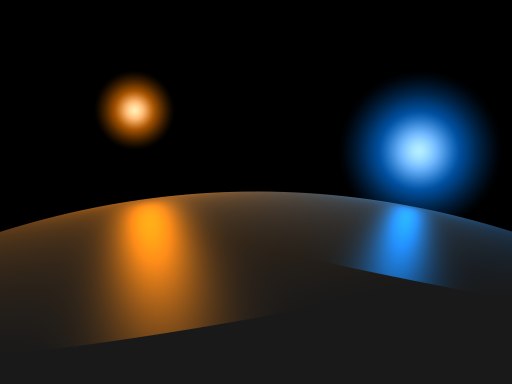

But I'd like to bring up a completely different and similarly unphysical
issue with the phong highlight.  Since the amount of phong reflection is
proportional to
	(R.L)^n
	where R is the Reflected ray
	and L is the ray to the Light
it is fairly easy to construct a scene where the Phong lighting model
*will not* illuminate an entire hemisphere because the term (R.L) is
negative for parts of the surface that are actually being illuminated by
the light source.
For example look at the following source.  By playing with the specular,
diffuse, and phong values you can see that the phong highlight is
unnaturally cut off before its actual horizon!
Just my $0.02
